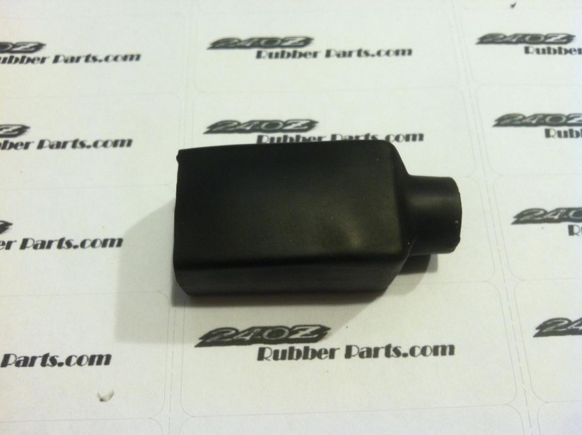

nix240z Posted October 5, 2014 Author Share #139 Posted October 5, 2014 preview of the voltage regulator 6 prong plug protective boot. Link to comment https://www.classiczcars.com/topic/46317-240z-fuel-and-brake-line-insulator-sets-and-steering-rack-expansion-reservoir/?page=12#findComment-456630 Share on other sites More sharing options...

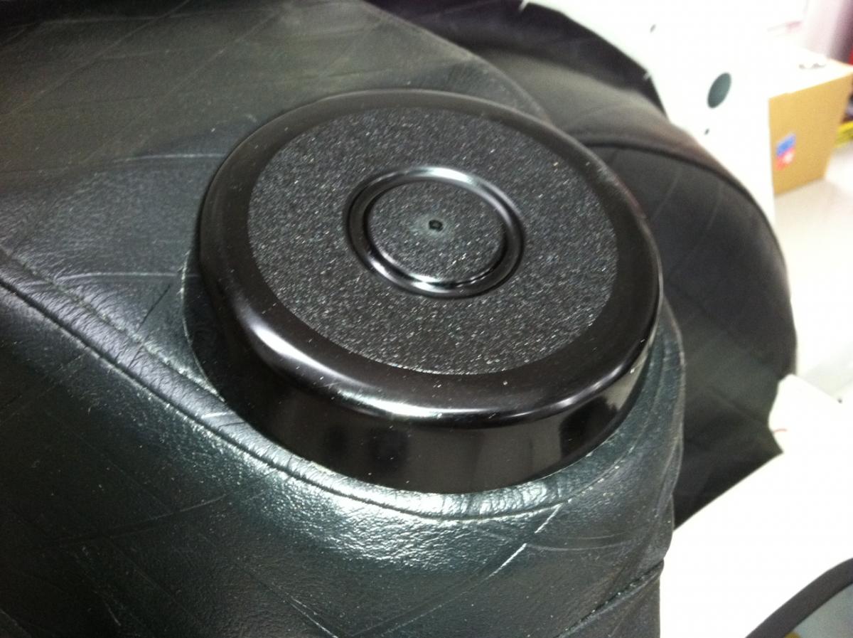

nix240z Posted December 7, 2014 Author Share #141 Posted December 7, 2014 Finished the rear strut cap. Exactly the same as Nissan. I'm also working on a few other items. The headlight wire plug socket boot. also the plastic pins that hold the fiberboard kick panels on the left and right side. Steve Nice tight fit. 4 Link to comment https://www.classiczcars.com/topic/46317-240z-fuel-and-brake-line-insulator-sets-and-steering-rack-expansion-reservoir/?page=12#findComment-460029 Share on other sites More sharing options...

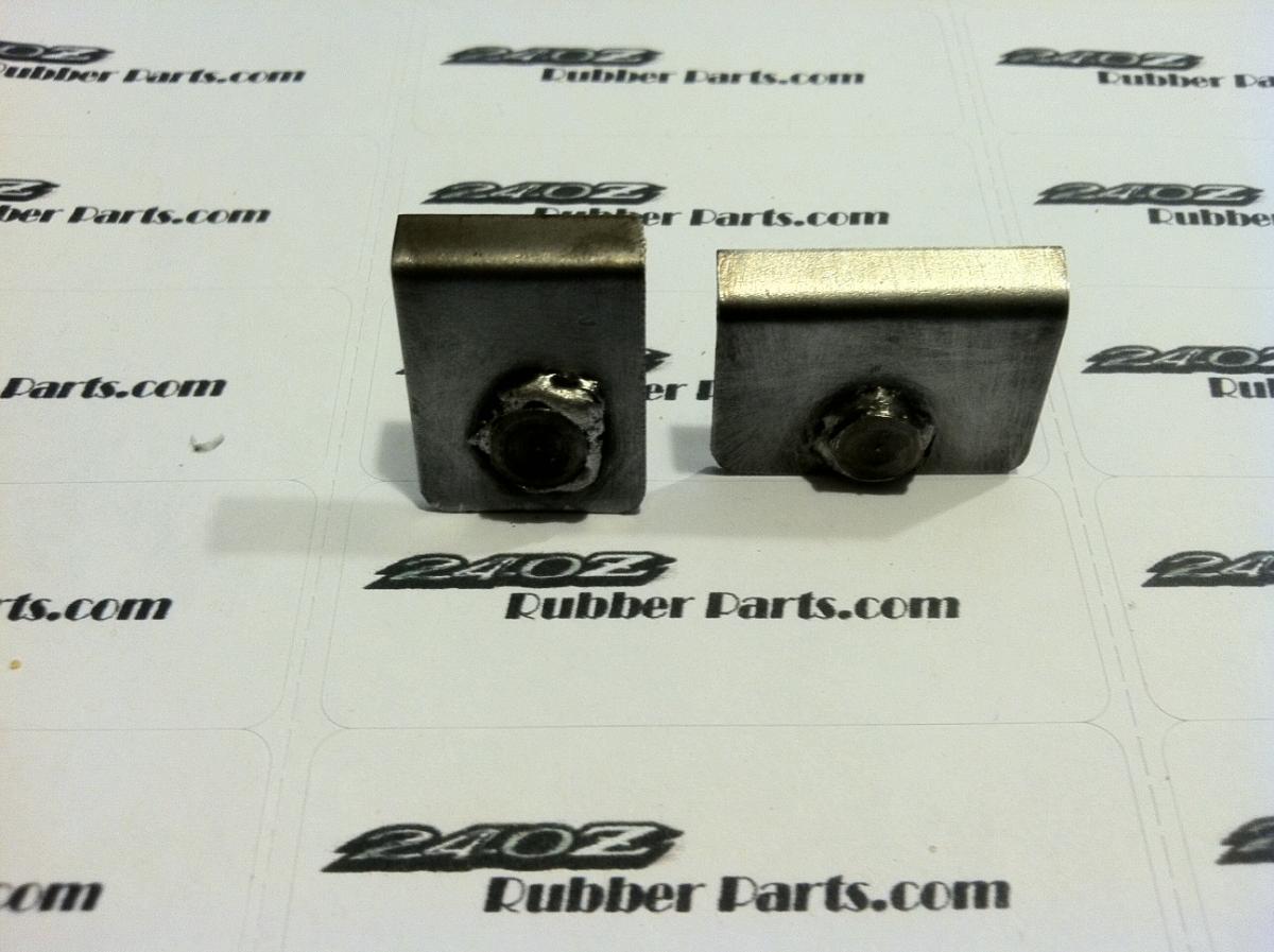

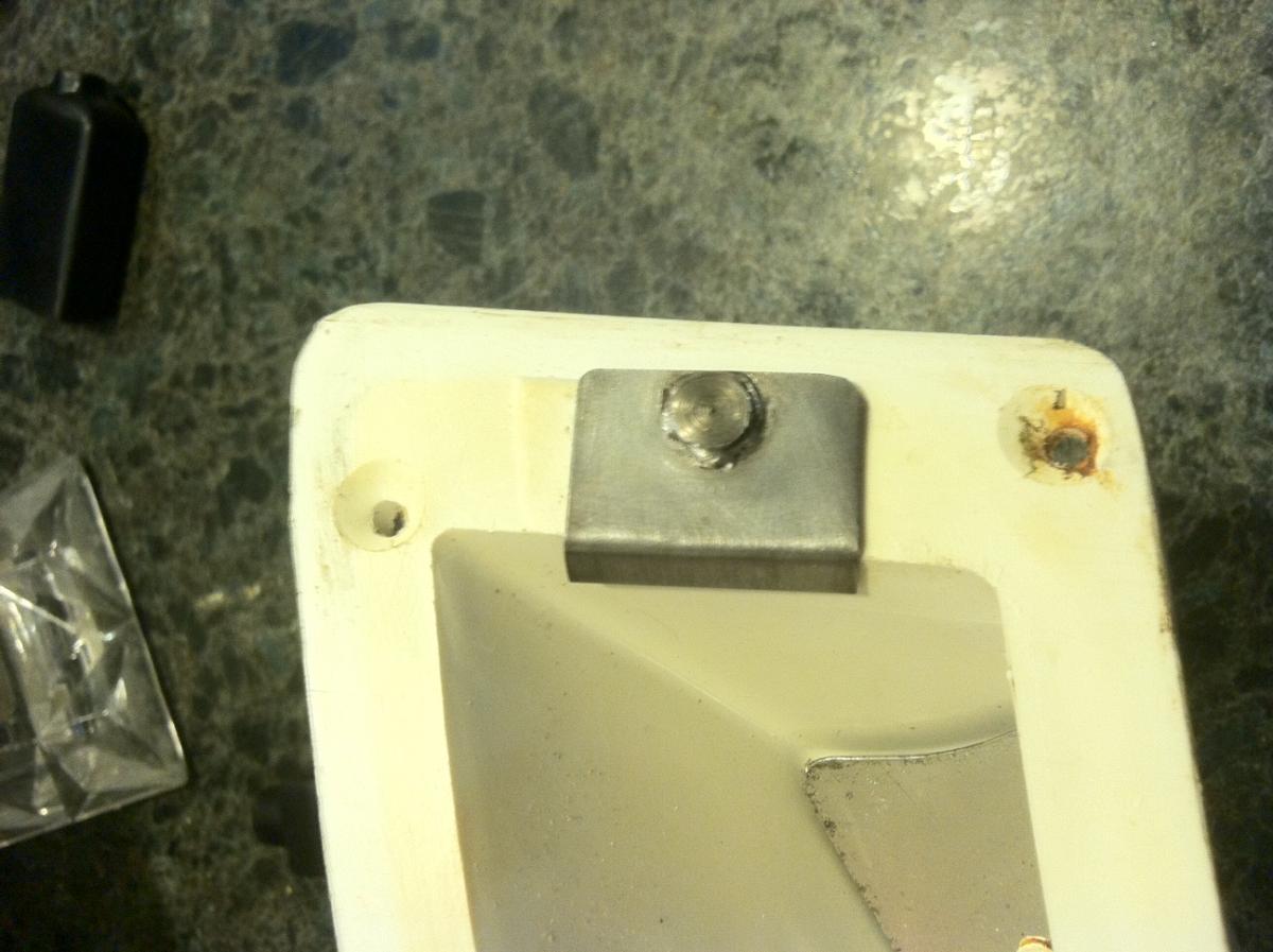

nix240z Posted December 12, 2014 Author Share #143 Posted December 12, 2014 Few things in the works. Plus I have some other items in the works. Headlight wire end boot. 95% of these I have seen are rock hard and deformed. any interest in these? 240z turn signal mounting hardware. I needed a set since mine were rusted out. I machined the bolt down on my lathe. cut and bent mounting plate drilled hole tinned metal for soldering soldered bolt to mounting plate and then they will be zinc plated. Steve Link to comment https://www.classiczcars.com/topic/46317-240z-fuel-and-brake-line-insulator-sets-and-steering-rack-expansion-reservoir/?page=12#findComment-460264 Share on other sites More sharing options...
240260280z Posted December 13, 2014 Share #144 Posted December 13, 2014 a spot welder may fuse the bolt to the plate too. Link to comment https://www.classiczcars.com/topic/46317-240z-fuel-and-brake-line-insulator-sets-and-steering-rack-expansion-reservoir/?page=12#findComment-460275 Share on other sites More sharing options...
