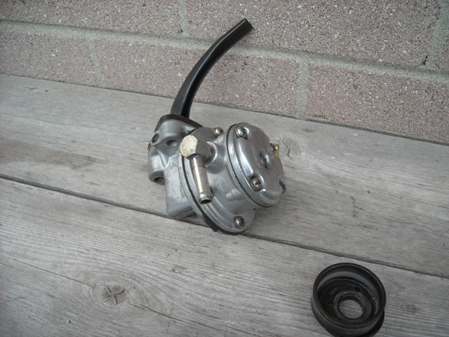

And Bart this is for you, I pulled it off the original motor and cleaned it up just in case I need it.
