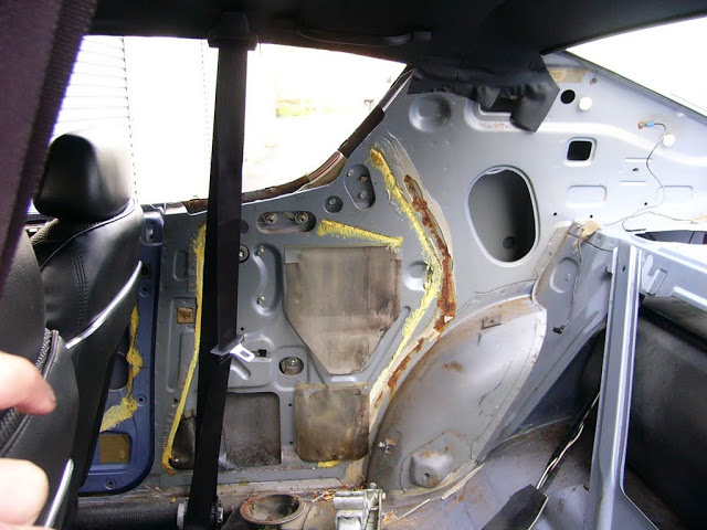

Guest Flauski Posted April 22, 2013 Share #3 Posted April 22, 2013 (edited) You might want to strip the factory sealer on this join too; The three coupes I have seen in this spot have all had rust. This is a picture of my current one (best condition one) and it still warranted stripping this sealer and grinding/rust killing. This car had minimal rust, with none in firewall. Edited April 22, 2013 by Flauski Link to comment https://www.classiczcars.com/topic/46333-interior-rust-spots-to-check/#findComment-421218 Share on other sites More sharing options...

khughes Posted April 22, 2013 Author Share #5 Posted April 22, 2013 (edited) [ATTACH=CONFIG]62802[/ATTACH] Yep, pulled all the sealer there too, mine was actually very good in those areas, i would hate to see where the water got in to soak that seal up, what is the inside of that panel like? that yellow glue stuff is a total PITA to scrape (chip) off! Uras, that decision keeps me up at night!, The bottom of my car was really good and had been sandblasted and coated in some form of flash rust preventer. I lightly sanded that, then sprayed 2 coats of dupont 840R epoxy, then i have coated it in 2-3 coats of white 3M stone guard.. I chose this as it is paintable (and white), so plan to do 2-pac colour (dupont probably) and clear over that (will just take a little while).. that is just the underside.. topside, i am leaving to the pro's (with the rest of the body work) i am willing to give Rust bullet a chance on the inside where it is unlikely to really matter. Edited April 22, 2013 by khughes Link to comment https://www.classiczcars.com/topic/46333-interior-rust-spots-to-check/#findComment-421238 Share on other sites More sharing options...
