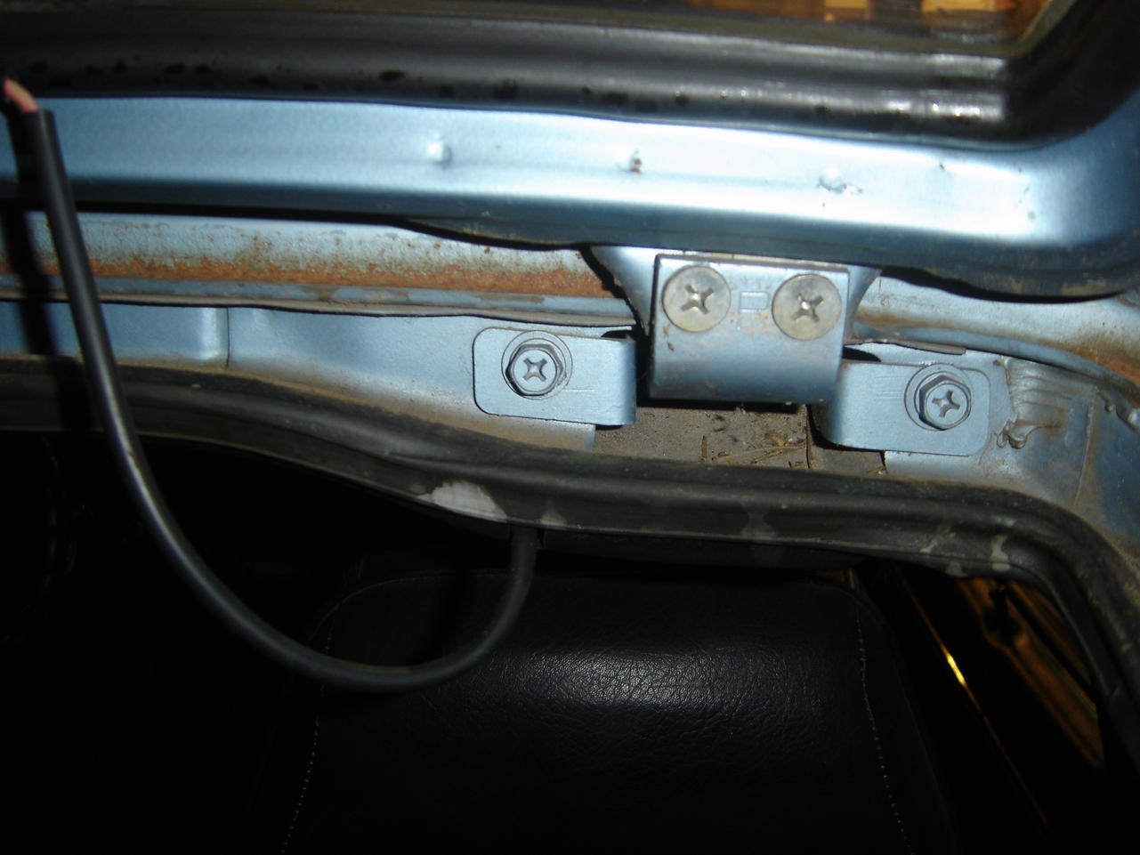

All three of my '71's obviously had the hinge sock/seal inserted and the hinge bolted in prior to painting the body. I can't find any pictures that show that right now, but it's true. The part of the rubber flange that protruded from under the hinge plate was painted, as was the hinge and the two big screw heads holding the hinges to the body. The hatches, on the other hand, were painted separately, as the screw heads for hatch attachment were unpainted.
Hi Matt,
I am almost certain that the hatch hinges along with the hinge shims and hinge seals were mounted on the car, without the hatch, and painted at the factory. Two things I
do know for certain are, the hex head phillips machine screws that securing the hinges to the body ARE PAINTED. The two flat head phillips machine screws that secure the
hatch to the hinges were NOT PAINTED. This can be seen in the picture attached in siteunseen's post. I had done a lot of research when restoring my car to verify the finish
of these machine screws.

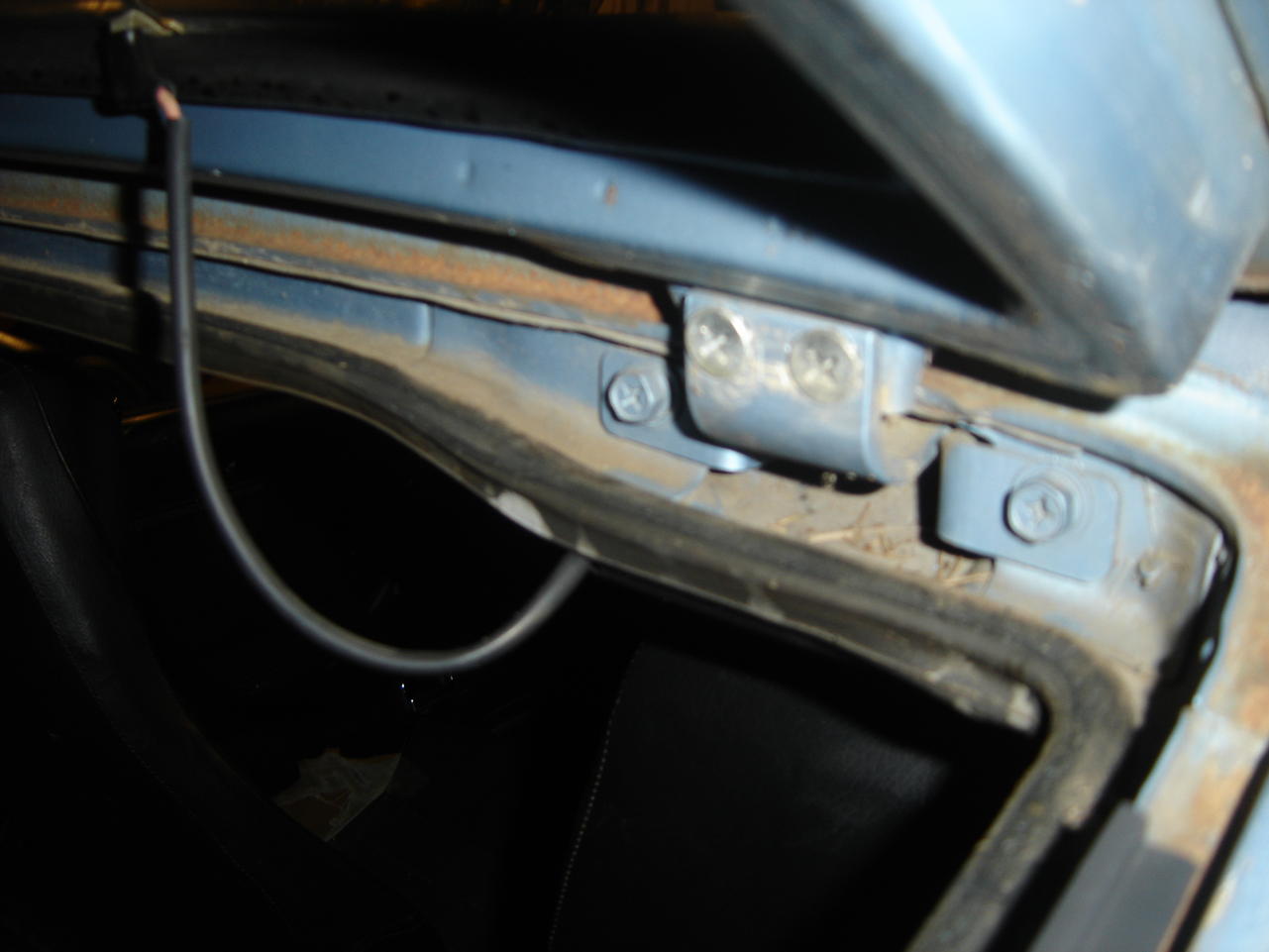

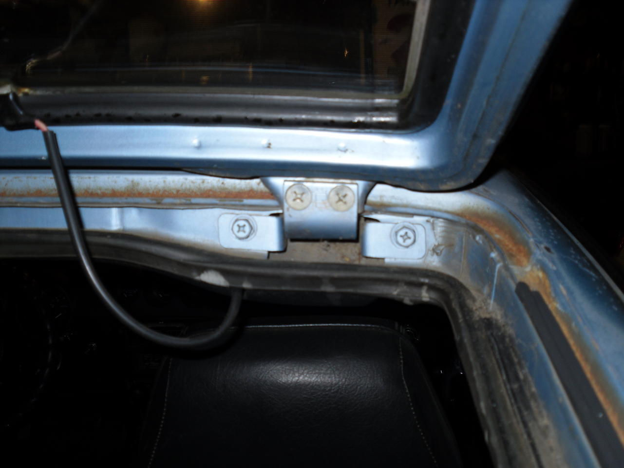

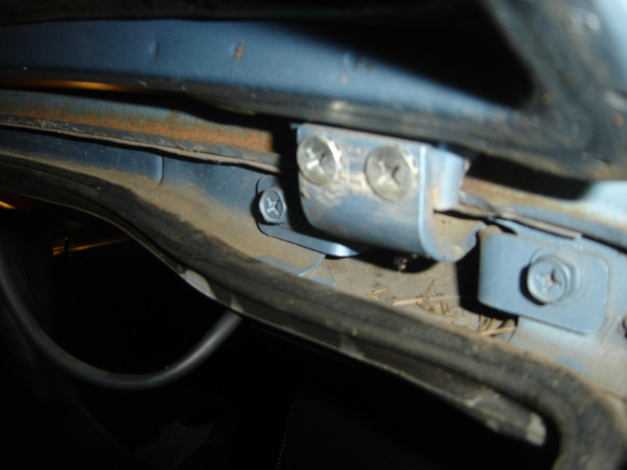

I'm confused too. I don't know which gasket your referring to but here are more pictures. Hope that they help.
OK, your talking about seals not rubber gasket for weather stripping.

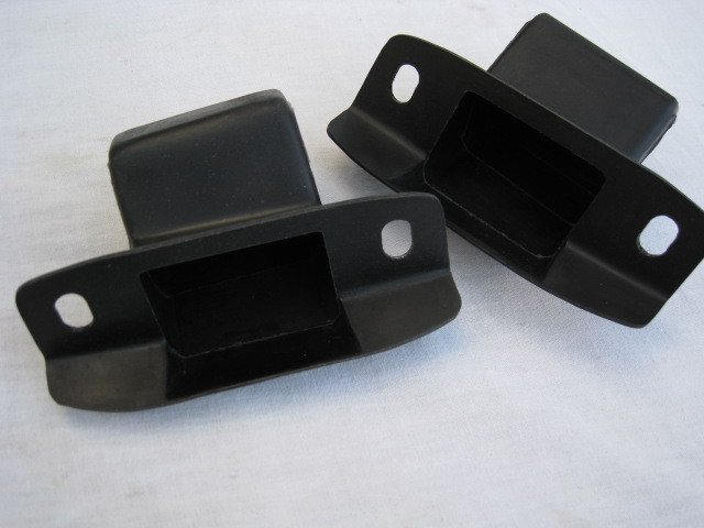

EDIT: Here's what I read http://shop.jdm-car-parts.com/index.php?main_page=product_info&products_id=313
