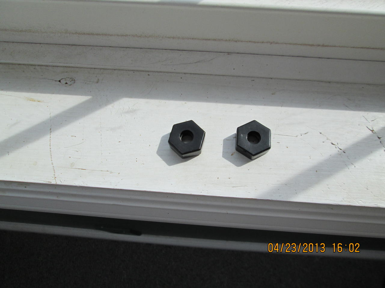

You can play with the number of spacers at the front and rear to change the angle of the seat bottom to suit your tush. Try different combos to see what you like best. Any spacers not used on top of the rail should be installed under the rail so as not to lose them.

im trying to tighten the rear left nut on  the driver and the rear right nut on the Passenger seat on my 1972 240z  but it seem useless, All the other 3 nuts of each seat are tight and have their plastic spacer also. Could the nut be damaged or am i missing something here? I have attached some pictures as reference. The 4 plastic nuts must be tight. However, this is not happening with these 2 nuts. Anyone?

Although the plastic spacers are threaded, they are not intended to actually secure the seat mount bolt to the floor bracket - that is the job for a metal washer and nut.  The spacers are threaded more as a convenience to keep them in place on the shaft of the rail bolt.  If the metal nut won't tighten, then something is damaged - either the threads on the nut or on the rail bolt.
