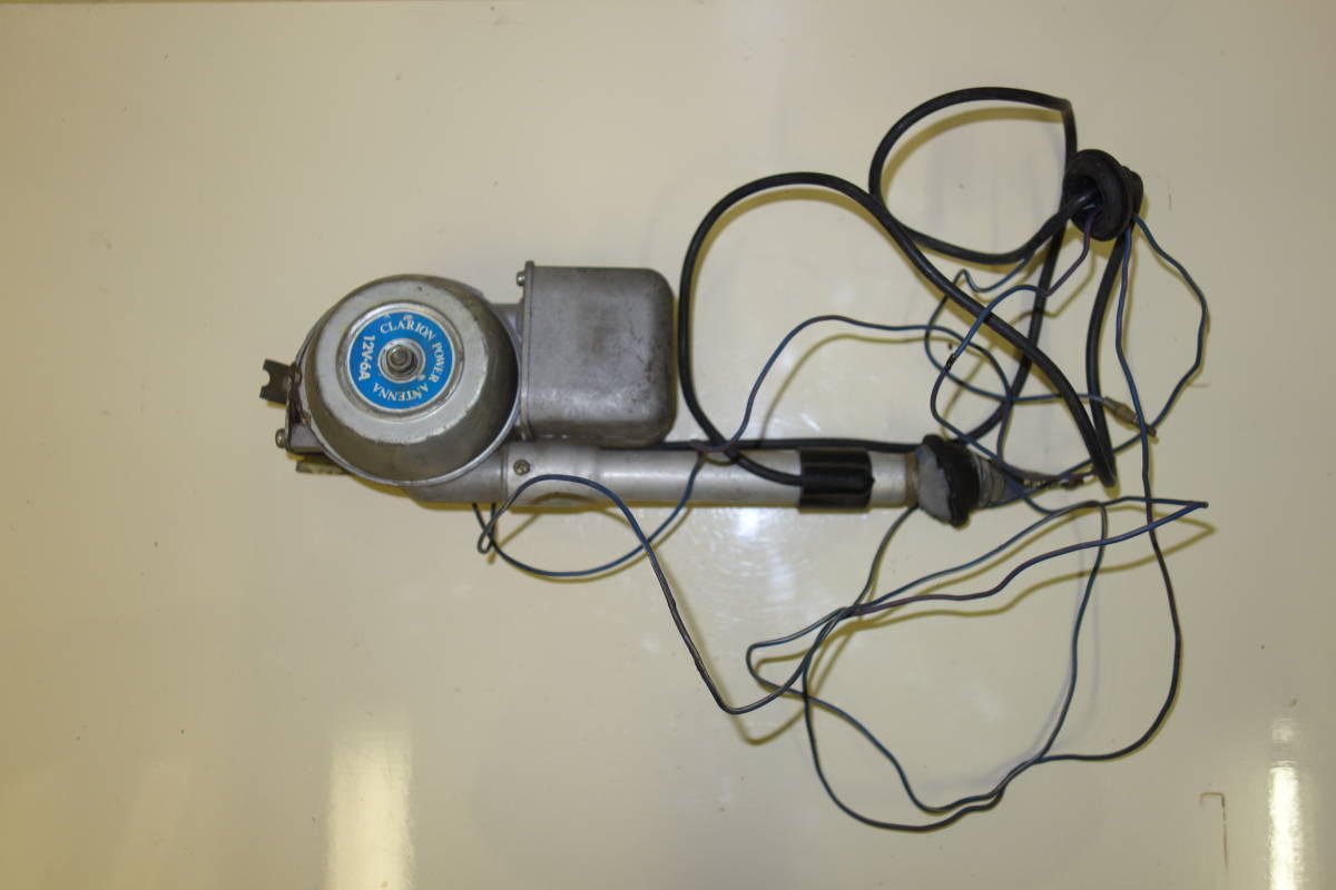

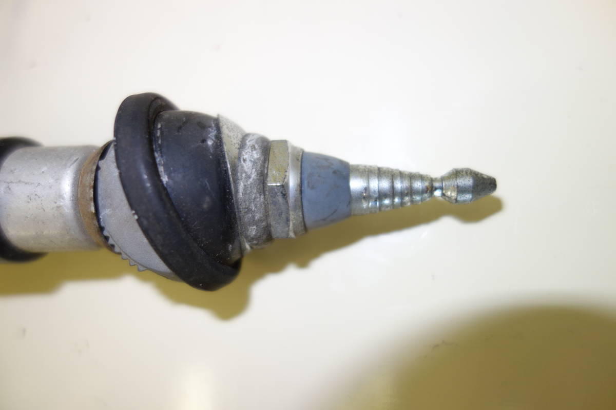

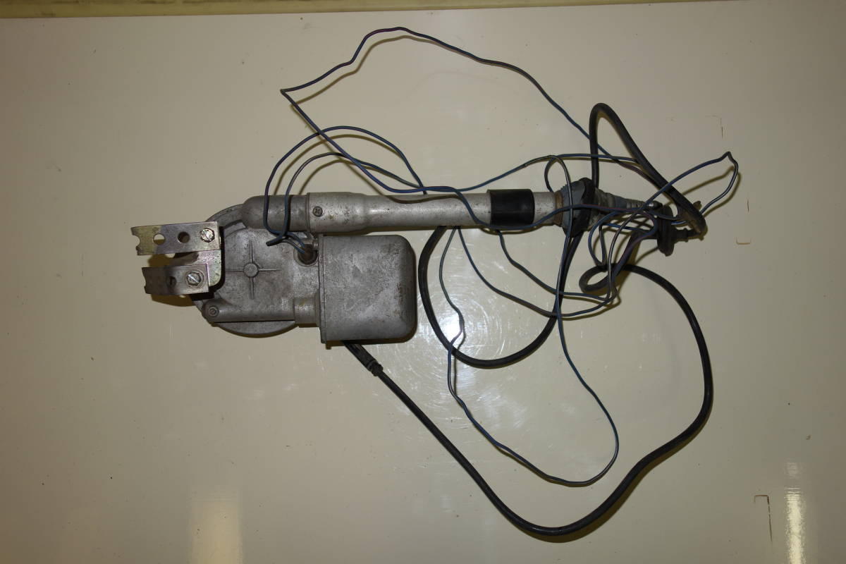

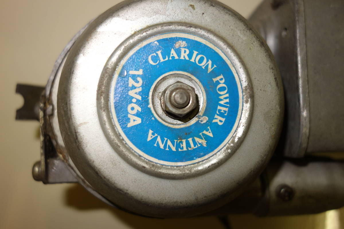

Hi Folks,
1 thing I'll note is that we often refer to these Antenna's as Harada made, but I bought 1 from Yahoo! Japan a while ago that I suspect is a Clarion unit. I've attached photos of 1 on there now. I mention it because it's got the "arrow" tip antenna that we often say is an early S30Z thing, but I suspect the arrow tip antenna's came on later S30Z's in Japan also. As they seem a lot more plentiful there.
https://buyee.jp/item/yahoo/auction/x673873132?conversionType=browsing_history
I don't know if this makes any difference what so ever in terms of the rebuild process or how they are made? But just including it as an FYI.
I do wonder if these are made by Clarion under licence like the Fuel pump was originally a "nikki" but later I note "atsugi" on them and other brands cast into parts.
