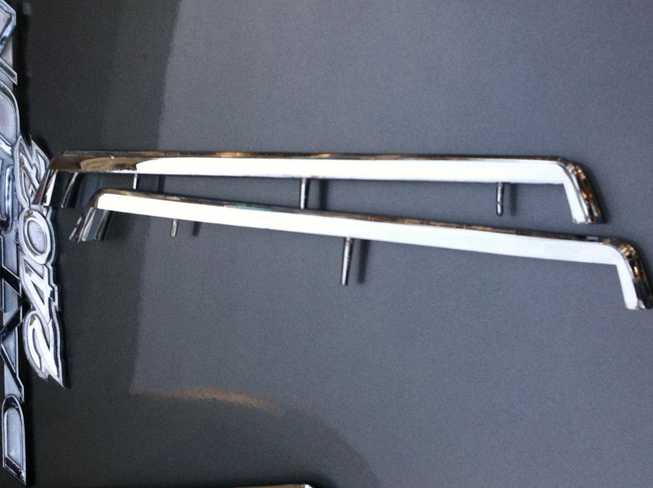

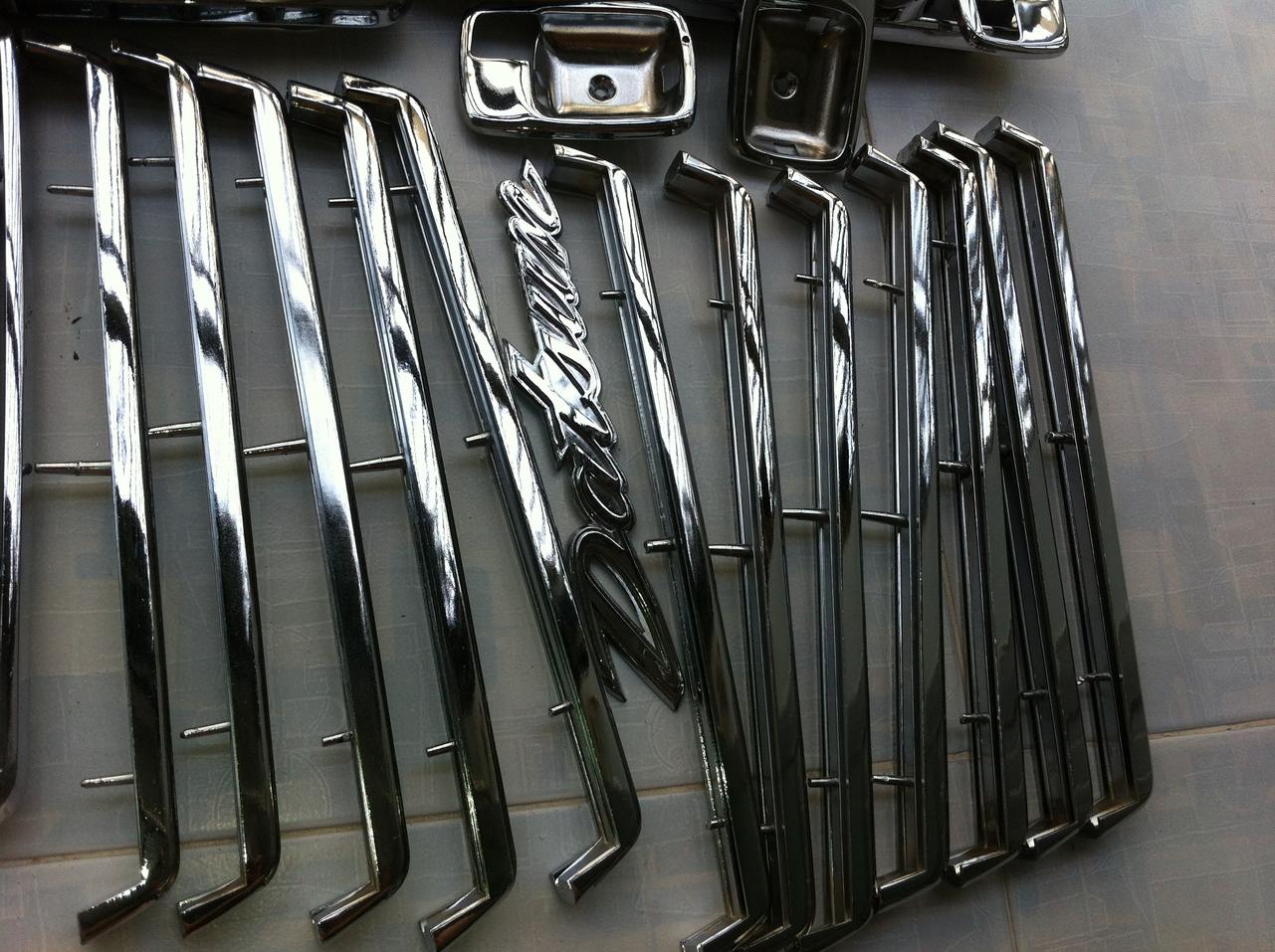

I found a couple of pics of the 240z tail light trim pieces that we've replated. Also, I'll keep you and the rest of the community updated on my progress with possibly reproducing these pieces.

[ATTACH=CONFIG]63273[/ATTACH][ATTACH=CONFIG]63274[/ATTACH]
Are these for sale?
These are a few of the tail light trim pieces that I've re-chromed for other customers, so, no....they aren't for sale. However, as I believe that I mentioned earlier in the thread, I do have some like pieces that I'll be plating in the weeks to come that I can offer to sell (on a core-exchange basis). If you need more info, feel free to PM me.
