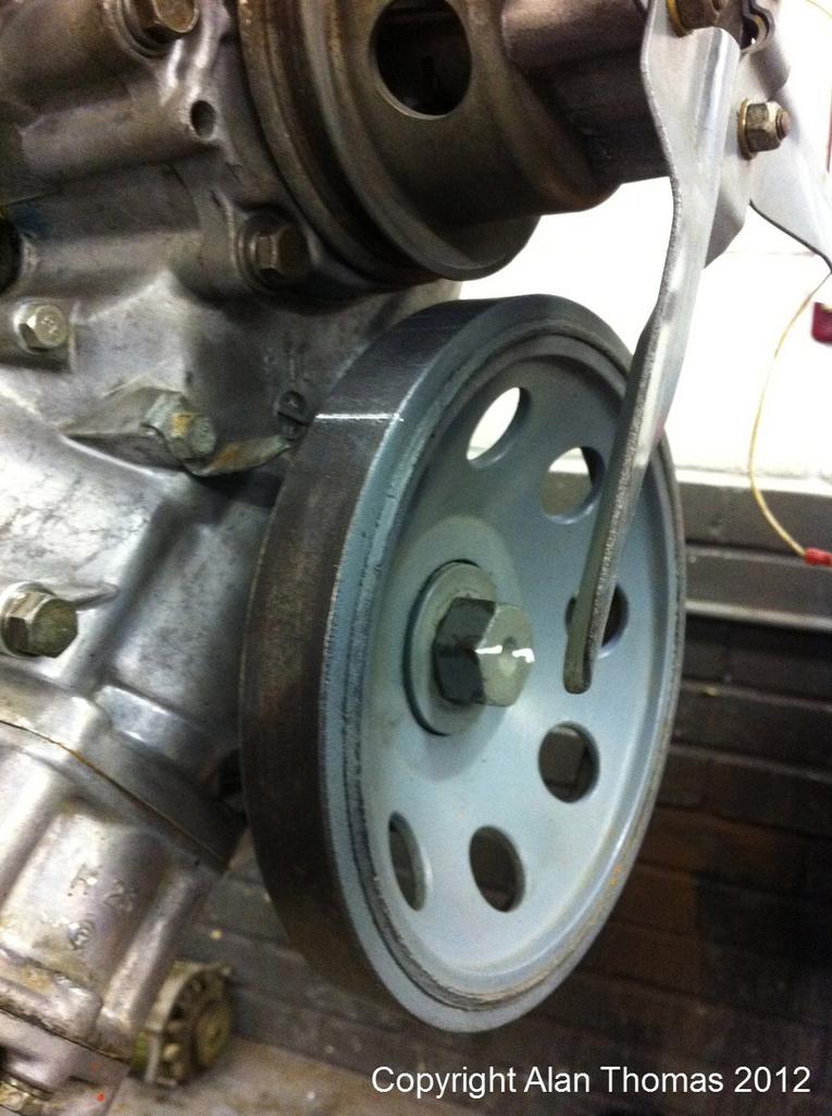

Hi Jerry,
There were several different types of narrow-belt crank pulleys. Here's a photo of one type ( attached ).
There was also one large diameter version like this, but with no holes. There were some that were small diameter too.
The narrow-belt pulleys had to be used as a set, so the original crank pulley that went with the Alternator pulley and Water Pump pulley in your photos would have been of the narrow-belt type too. Not stock.
Would be great if you could find it.
Cheers,
Alan T.
