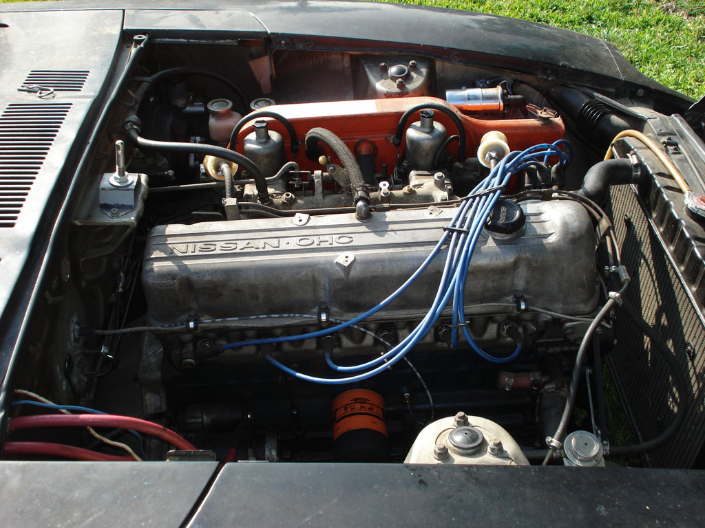

mark sexton Posted May 12, 2013 Share #1 Posted May 12, 2013 I have a 71 240 ,I recently installed an electric fuel pump and removed the mech pump.the pump is working but since I installed it fuel is leaking from the banjo bolt on the float bowl of the carbon the left(closest to front). I cleaned the float but the problem persists.Any suggestions?,is this problem related to the new pump or just a coincidence? Link to comment https://www.classiczcars.com/topic/46527-fuel-leak/ Share on other sites More sharing options...
