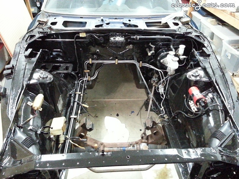

And here is where its going to live:
Stay tuned for upcoming updates and hopefully the first fire and drive shortly!

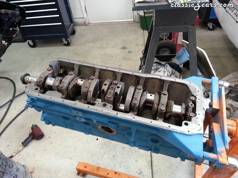

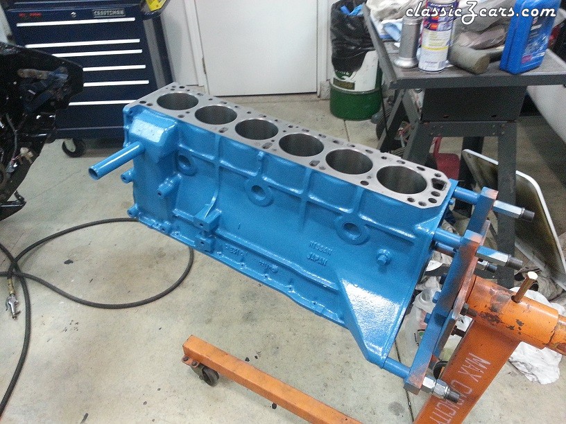

Thanks for the kind words! I had previously soaked this block in a 35 gallon garbage can with Krud Cutter and got it pretty darn clean. Took my ball hone to the cylinders to clean them up and gave it a quick coat of paint.
Today I got the crank installed with new standard sized bearings. This week will be final clean up of the pistons and putting them in to complete the short block. Fun times!
LOL, yeah you got me on that assembly lube. It does look rather murderous! Unfortunately the crank is coming back out tonight. I want to recheck the bearings and im not happy with the rear main side seals that came in the ITM gasket set. Got a FelPro rear main set this morning im going to swap out with.

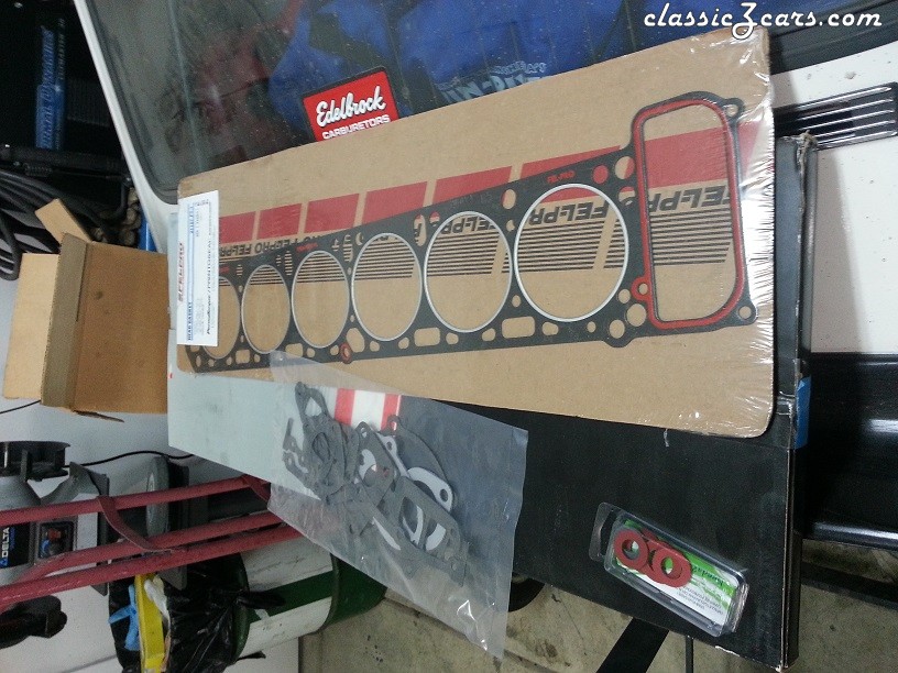

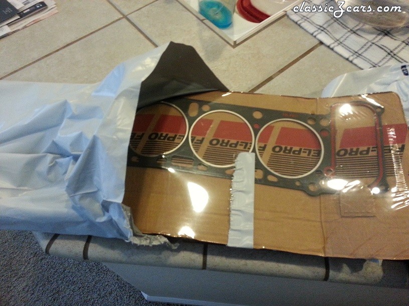

To top things off the FelPro head gasket I ordered from Amazon showed up bent into a "Z"! So I had to wait another week to get a replacement. turned out not to be as big of an issue except for the over torqued rod bolts.... Soo, after a fruitless search for a set of stock 8mm bolts I bit the bullet and bought an ARP set that I'm anxiously waiting for the UPS man to deliver tonight. Spent the last few evenings cleaning parts and painting. Fun stuff! Did get the head put together though! So all I need is my rod bolts and I can assemble the long block!

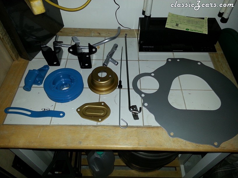

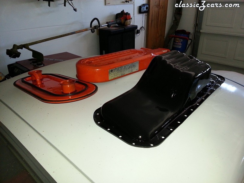

Here are some pix of freshly painted parts:
And the new fangled Z bend head gasket:

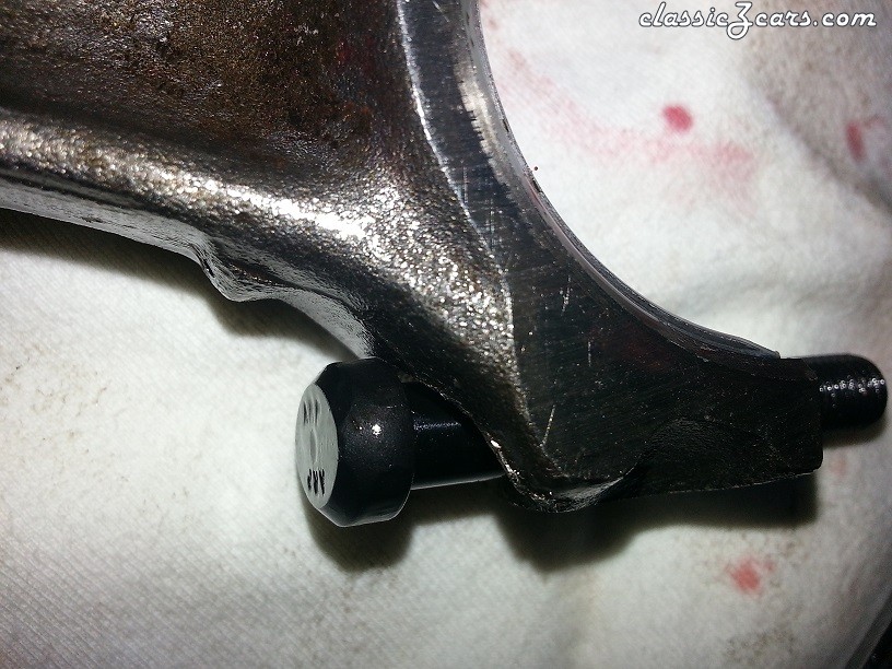

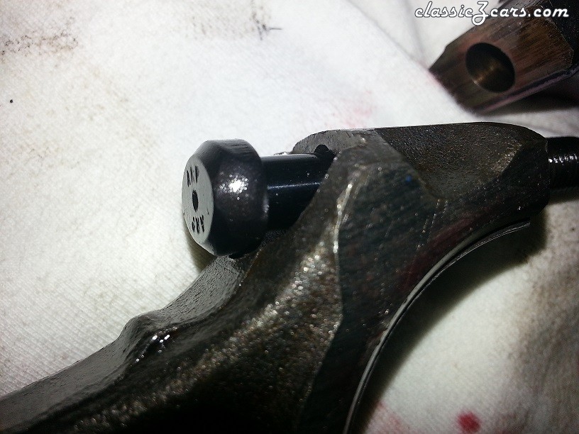

Looks like the head just barely doesn't clear the bolt relief in the rod. In comparing the ARP bolt to a stocker, it appears the ARP bolt is a few thou larger in diameter making it a snugger fit in the rod. Where the stock bolt has a little play allowing the head to squeak by the relief and the bolt to seat. The ARP bolt is a very snug fit and ends up catching on the rod. Looks like just the very edge of the relief too.
Here are a couple pics:
What to do from here? Pulling it all apart and sending it to a machine shop is kinda out of the question at this juncture. Really leery about removing any material from the rods as they are balanced, albeit a factory close enough for govt work balance ;-) Not sure if I should take the bolt heads down a scosh or something else. My vote is for taking a tad off the inboard side of the bolt heads. Although arguably this will affect rod balance as well. Question is does it really matter?
What say the masses?
Thanks in advance for the sage advice!

I remember my APR bolts were really snug, I tapped them down with a small hammer then put on a short piece of rubber hose to keep from scratching the crank when I tapped the piston down before the caps went on.
EDIT: My extra set looks different. I apologize.
