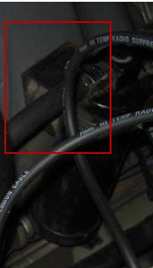

Sweet, I have that bracket then. Just need to find the dryer. With the previous owner that this car had it's amazing how complete the a/c system actually was. The rest of the car not so much but that's what made this car such a great scavenger hunt. can you tell me if the bracket was bare metal or painted? If I take it to bare metal I'll engine clear coat it to keep the shine.
I was wrong I do not have the correct bracket and am in the process of looking for the correct one now to hold the receiver dryer. I have located the correct receiver dryer and have everything else except this bracket.
https://www.classiczcars.com/topic/46602-a-r-a-ac/?page=2#findComment-425833
Well the best images I can find indicate a bracket that holds the dryer away from the fender wall (seen in two pictures) and the third one appears to be what is discribed above. clamp bracket similar to coil bracket in galvanized metal. can someone confirm which one was the A-R-A dryer bracket used on the 240Zs that received A/C? Need to find the bracket but need to confirm the correct one that I am tracking down.
