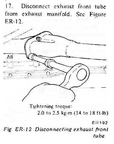

FSM does not have any good explanation.

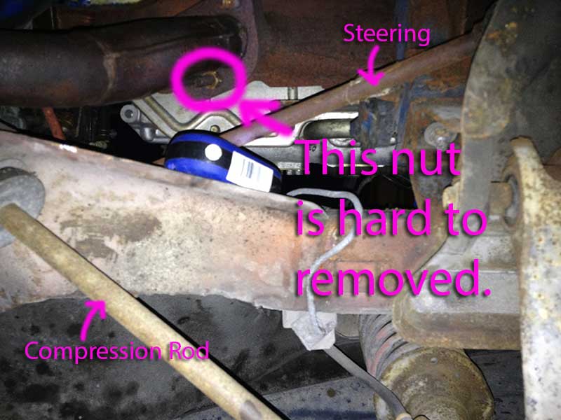

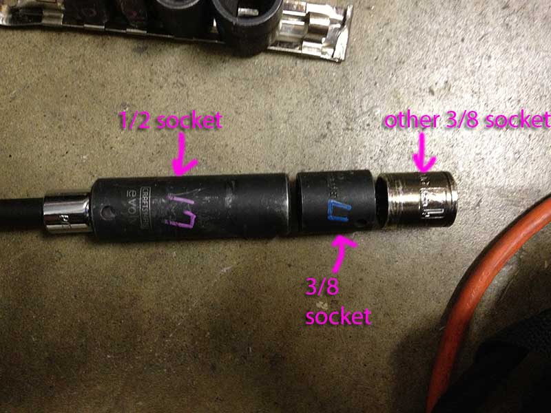

I could've removed 2 nuts out of 3 without problem. Just one of the nut is is really hard to reach due to the steering lower joint assembly and frame prevent me to use the tool. Especially, my socket barely fit to the location. longer 1/2 socket does not fit, shorter 3/8 socket is too short and prevent wrench to snap in.

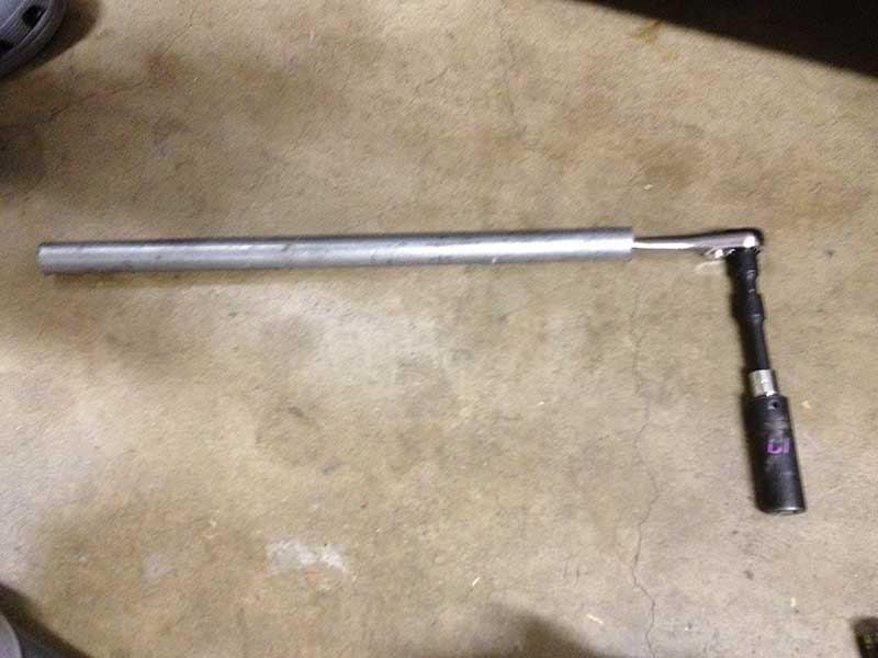

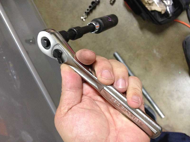

Here is my regular daily tool. My favorite HFT 1/2 socket and 3/8 socket is same size of diameter. I think I need to look for smaller diameter socket to fit the limited space.

The tools you have are too large (wall tickness). You need a hand-drive 3/8" drive deep socket and a long extension to get the ratchet down under all the stuff in your way. Use a wobble extension if necessary. Avoid flex sockets and universal joints if possible. I prefer Snap-On but Mac, Proto, and Craftsman are good also. The main thing is to get a socket with a thinner wall than the impact socket you are using. The more expensive name brand tools typically are made from stronger materials and have a thinner wall and good strength.

Even though this socket, the space is still tight, but I've successfully remove the last nut with PB Baster penetration!
