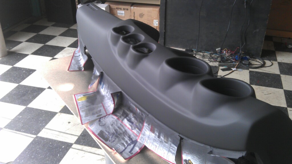

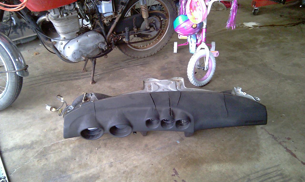

Posted May 28, 201312 yr comment_424321 My friend and I both own 240z's, and both of us had cracked dashes. Also, both of us hate covering up problems so a simple dash cap was not gonna do it. However, we are both lacking in high monetary compensation from our jobs so we decided to experiment and find a cheaper way to repair our dashes. This involved the use of silicone, bondo, light gorilla glue, jb kwik, and finally "Flex Seal". We began with the silicone, but quickly found out this really only works well for larger cracks, and also tends to have some small air pockets as well as it tears away from inconvenient cracks, still leaving medium to small size cracks un-repaired. To remove the excess silicone a 3" sanding pad was used on a drill for speed, but in some tight areas, such as around the three small gauges, the 3" is too big and abrasive and starts to dig into the vinyl. However, in certain areas it is necessary to sand down to the foam for a smooth finish, as when the dash splits, the two separated pieces of vinyl stick up. This then led to the use of bondo for the small cracks, which worked for the small cracks, but not the bigger cracks, as it just crumbled out. Then I used some light gorilla glue for some really small cracks, and finally, jb kwik to fix any big crack and small cracks that the previous methods did not work for. In between each method, we sanded with 60, 180, 220, then 600 grit sand paper to make the finish as smooth as possible. We were originally going to use filller primer so I decided not to worry myself, or cause more damage, by sanding some areas down more. However, while at the hardware store, I realized we can use Flex Seal, that stuff you see on TV, and although steep in pricing, $18 a can, is perfect and only one can is needed. It is flexible should the dash flex, it fills in small cracks, its meant for outdoor roof repair so it is good against the sun, and the texture is close, but not exact, to the original dash texture. It worked! However, I later realized I should have sanded down some areas a little more, but it came out with no cracks, original looking, and doesn't add any parts like a dash cap! Now, on with the pictures! Link to comment https://www.classiczcars.com/forums/topic/46653-repaired-the-dash/ Share on other sites More sharing options...

May 28, 201312 yr comment_424341 wow!!!! that's got to be the worse cracked dash I've ever seen. I know you stipulated covering was out of the question but I think a full dash cap would be the way to go. turned out pretty good though. Link to comment https://www.classiczcars.com/forums/topic/46653-repaired-the-dash/#findComment-424341 Share on other sites More sharing options...

May 29, 201312 yr Author comment_424392 That dash cap looks nice! but I personally don't like just covering up problems, I'd rather try repairing them first. Thanks though! And Leon, I will drive over there as soon as the car is back together! Mlc240z, I have yet to put the dash back in the car as I am doing a full rewire, but I had it in the sun all day yesterday when I was installing gauges and what-not and it didn't smell at all, but inside the car it could be a different story, I'll try to keep this updated! I would also recommend to sand more than I did, but hey, live and learn and its still better than before! And thanks everyone else for the words of encouragement! I am also installing new vdo gauges (tachometer, oil pressure, and water temp), as well as an afr gauge as I just rebuilt the engine and the non-working stock gauges weren't cutting it. The oil pressure wasn't installed yet, but the vdo tach looks pretty much factory, and I relocated the gas/amp gauge to the driver side air vent. Probably not to everybody's liking, but hey, I think it's not half bad! Link to comment https://www.classiczcars.com/forums/topic/46653-repaired-the-dash/#findComment-424392 Share on other sites More sharing options...
