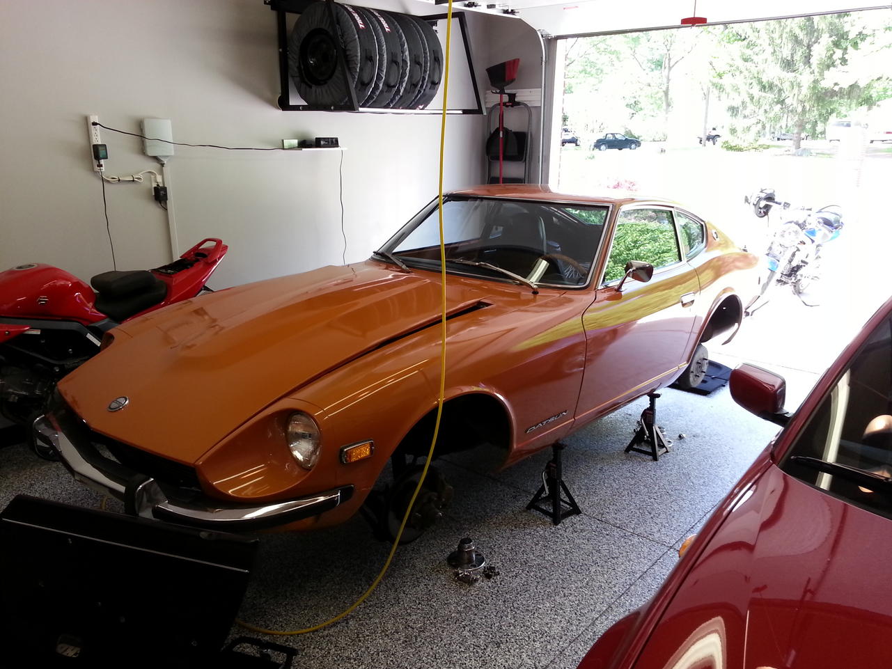

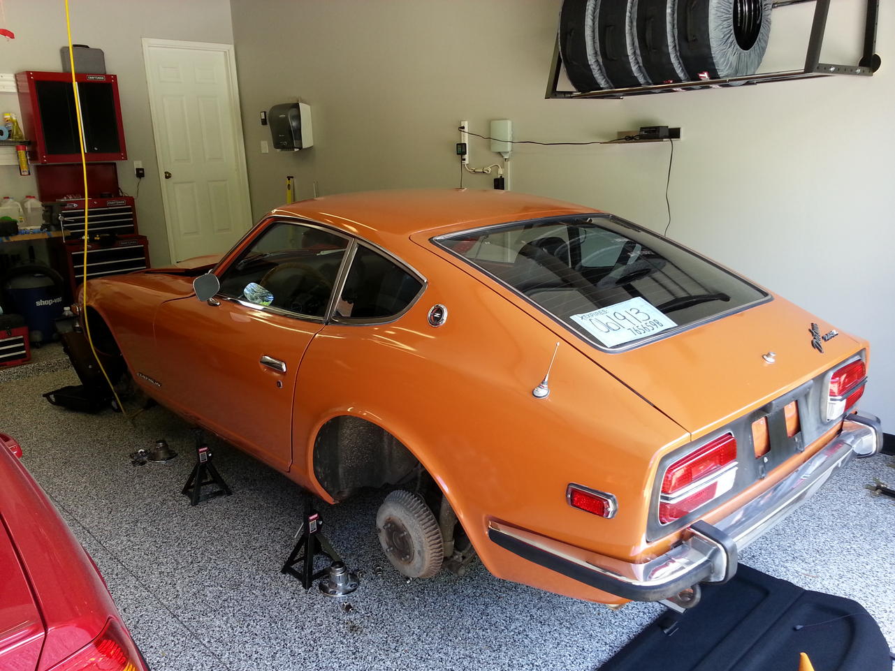

Here's my first request for help on my new-to-me, single owner '73! Here's the car as it sits

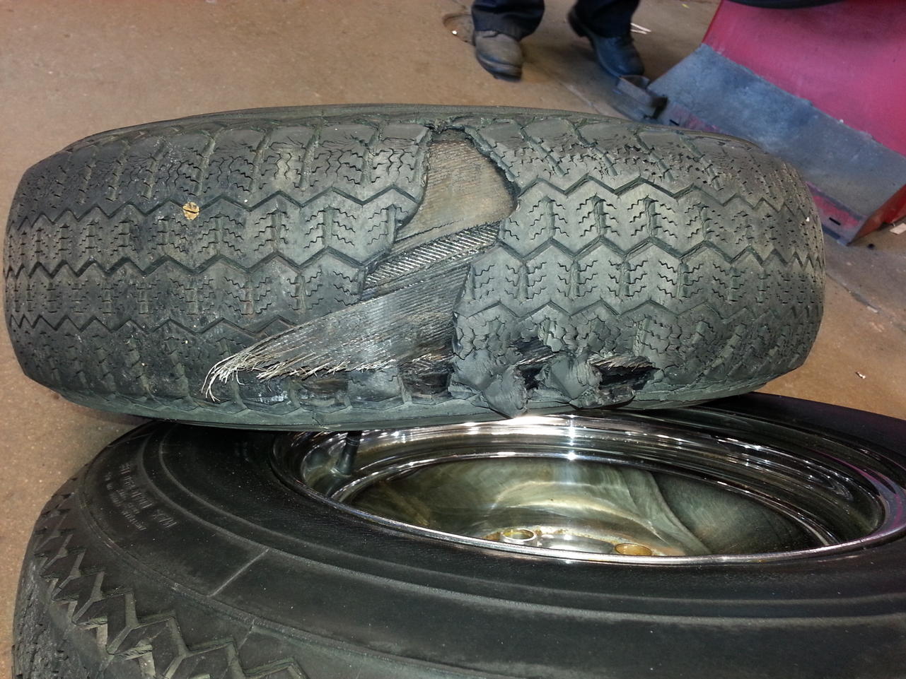

It's up like that because this happened to one of the roughly 25 year old tires :ermm:
The car has only 63k miles, but like any 40 year old all-original vehicle, it does not drive particularly well. I've been doing a lot of reading on the common issues, of which I have many. One that I'd like to fix right away is a pretty violent shaking in the front end and steering wheel when I hit bumps. From what I've learned here, it sounds as though the front tension/compression rods are the culprit. The bushings are definitely worn and cracked. I'll post pics of those tonight. So I have the option of replacing them with stock rubber (I like stock), or "upgrading" to MSA's hemispherical bearings or even full spherical bearing units from ArizonaZcar or Techno Toy (links added for my reference later). The car is original so I'm leaning toward simple stock replacement but I'd like to hear any strong votes of confidence for the upgraded parts. Also if other parts could be causing my symptoms, I welcome any feedback. Thanks everyone.

bacarl, before you do anything else, please get rid of those old tires. They can be dangerous. Get some new ones at Tire Rack. Even tires for a minivan are better than the 25 year old tires on your car. I have the ball&socket tension rod set-up and there is a fair amount of road shock felt in the wheel. It was the same when I had the all poly stuff, too. The best thing for you might be with the stock rubber. They are still available and easy to change out. Probably the ball joints and tie rod ends could stand to be replaced along with the steering rack bushings and sway bar bushings, too. You are beginning to find what I did on my 70K mile car: all the suspension pieces will need to be replaced sooner or later, but you won't believe the difference in the car's handling after you do the work...fantastic!

I second Pop's Z on the tyres.

I already have a set of new tires for it. I'm not sure what direction I'll take the car so I just popped for the cheapest respectable set I could find: some 195/70R14 Falken Sinceras... $160 out the door!! I couldn't believe it. Just one Dunlop Direzza for my other car (Mazdaspeed3) is $250!
As you can tell from the temp sticker I haven't had the car long, and I haven't put many miles on those old tires. I did have to drive it 150 miles home from the west side of Michigan to the greater Detroit area where I live; very fortunate that I made it safely. The tire in the picture gave out just a few days later (while I was taking my girlfriend for her first ride in the car, naturally).
