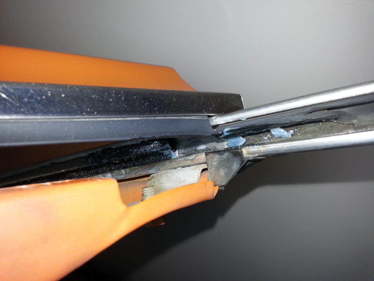

My passenger side window recently turned very stubborn. Towards the top of its travel it would get hung up, and I'd have to grip the glass and wobble it upwards while turning the crank. I took the door apart to investigate and found that the felt "track" that the window rides in at the back of the door seems to have torn or separated. When the window mechanism hits this spot it gets hung up. I liberally greased the felt and the other parts of the window mechanism and it helped a lot. I also had the driver door apart to fix the lock and I noticed the same separation in the felt, although the window still operates normally. Can anyone tell me if this is normal?
This is looking back towards the part of the door directly above the door handle. The camera is turned sideways, sorry about that. For some reason I wasn't able to reorient it. You can see an area of bare metal between the felt on the inside the door and the rubber on the outside.

Worn window channel liner is pretty common and an easy fix. Check with MSA or BD for either of two styles: OE or aftermarket. I used aftermarket and found it very satisfactory - nice quality, a good fit and easy install. Be sure to buy all the pieces - upper and lower channel. Remove the stainless window frame, replace channel material, reinstall and align the frame.

Just following up to my post, I figured out that the felt was not the cause of my sticky window. Even loaded up with grease, it would stick sometimes. I think it was coincidence that it stuck at that break in the felt; I think that break is normal between the two pieces. My issue was actually somewhere in the regulator itself. I can't see in there to tell exactly what was binding up, but after liberally greasing the teeth which come into view as the window is lowered, grease worked its way onto the regulator splines and things eventually smoothed up considerably.
