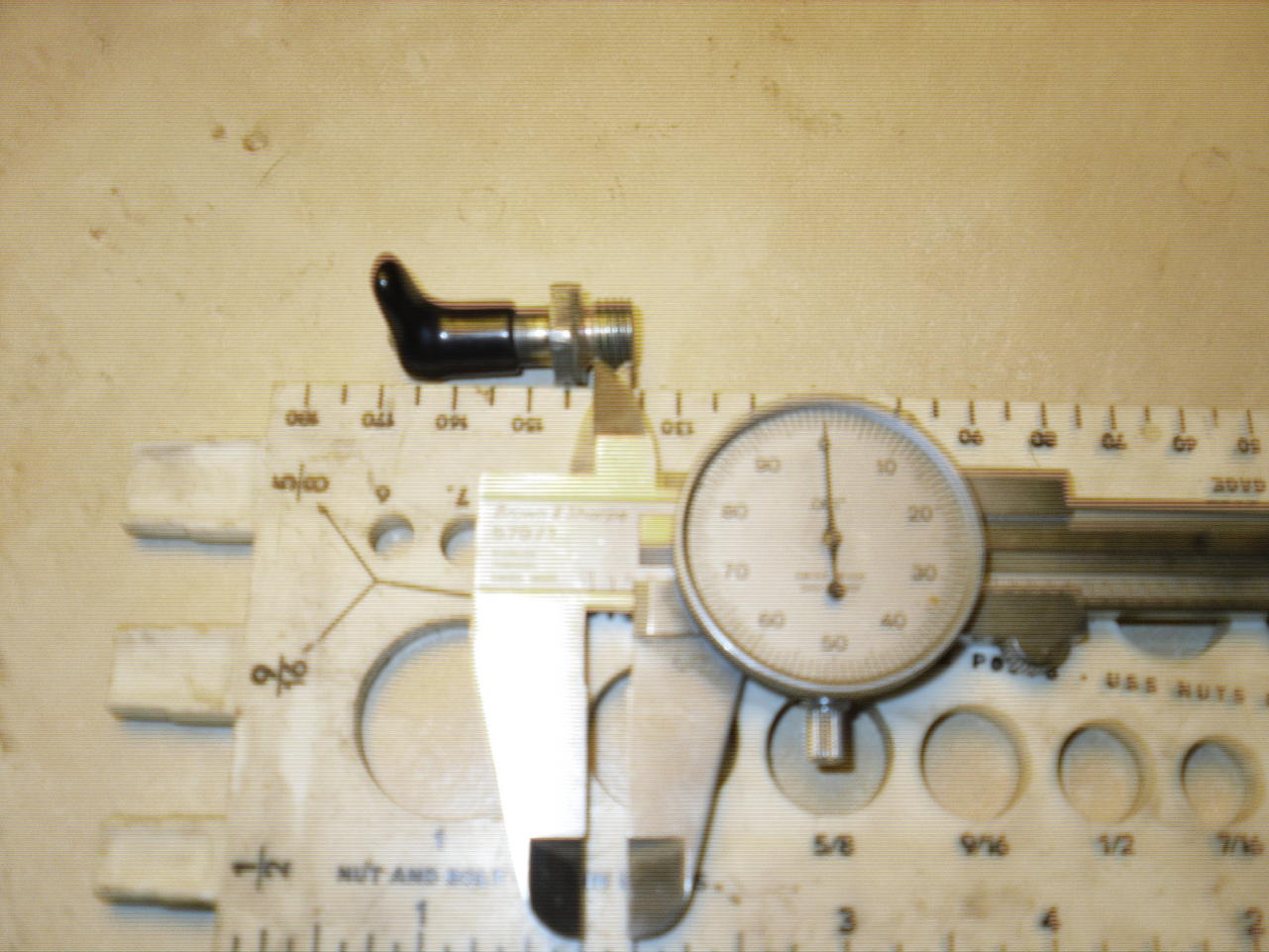

My pump is fine, it's just the check valve that's not working. I diagnosed that it's the check valve by clamping off the supply line between the filter and with a helper, killed the motor at the same instant. This left the rail pressurized, but shut off both the supply and the demand. With that line clamped shut, the rail held pressure, for some time at least.
It was down in a few hours, but with the supply line from the pump open, my pressure falls off almost instantly. In other words... My FPR may be slowly leaking as well, but big fish first. :bulb:
It's definitely an M10, I've got a cheap plastic nut & bolt gauge, and it's definitely not a 1.25 thread or 1.5, I've got a tap & die set and it won't screw into either of those 2. I do not have a bolt that will screw into it, neither will the 1.25 & 1.5 taps. It has 5 threads per 5mm or 2 10ths of an inch the best I can tell so as usual your right! It does have a copper washer between the valve and the pump body.

Thanks for the part numbers. I've seen lots of product offerings that have threads on both ends. I could easily turn off the threads on one end and set it up for tubing instead., but I would have to know what the threads are that go into the pump (and that's one of the reasons for my thread investigation above).
