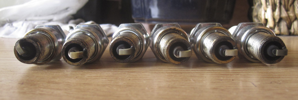

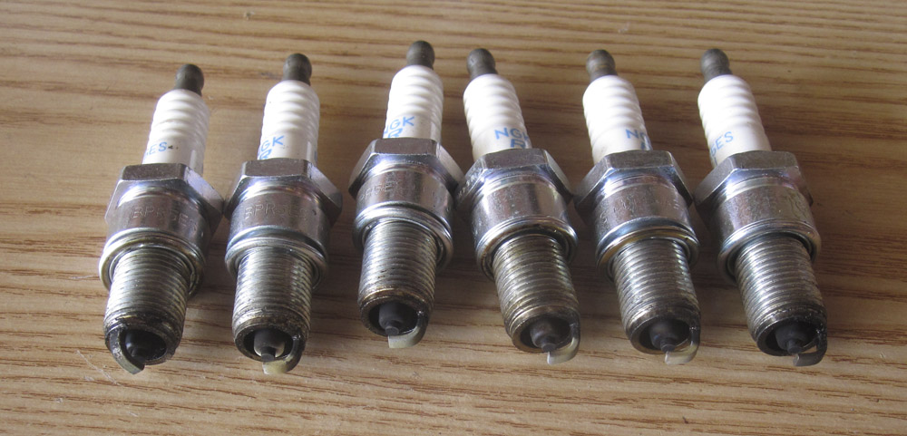

Here are the plugs, ordered 6 - 1 left to right.
I've had to move the car a few times and I haven't encountered the stumble again, yet.
Oh, and I'm pretty sure these are BPR5ES-11, so they're hotter than the 6'es. I intended to pick up 6'es but didn't notice my error until I got home. I'll end up replacing them eventually, but they shouldn't hinder my attempts to solve other issues.

Well, the good news (to me) is that your plugs are fairly consistent from 1 to 6 -- no wild outliers. That suggests to me that your injectors are probably not clogged. (If they were, it would be to different degrees with each one.)
Aside from the hot ground strap, I'd say your plugs look a lot like mine did when I was running rather lean -- lots of carbon, at least for plugs that haven't been run very long. I realize carbon fouling is a classic indication of a rich mixture, but in my experience if the mixture is lean enough to cause partial misfiring (whereby a slow, incomplete combustion results in backfire through the intake), then it can also cause carbon fouling.
One great way to determine whether your mix is out of whack (and in what direction) is to remove the plastic cover from the side of the AFM and to finger the counterweight to see how it impacts the idle. If fingering it slightly CCW causes the engine speed to pick up a lot, that would suggest your engine is running lean. If fingering it slightly CW improves idle, you've got a rich mixture. Ideally, fingering it in either direction will result in a slight drop in engine speed. Of course this is at idle, and what matters most is off idle. But still I found that the proper mix at idle gave me the best mix on the road.
There's an idle mixture screw on the bottom, outlet side of the AFM, but I've not found it to do much of anything. I have mine set 5 turns open.
