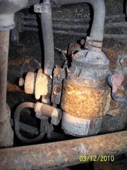

The PO had really done a bodge-job fix on the fuel pump - They'd clearly had it removed since I found the in-pump filter screen was gone, as if it had never been there. In its place was a solid chunk of rusty varnish. The pump had been struggling to pull against this the whole time since I woke the car up. They also HOT GLUED the wires to the pump - the little rubber boots were gone. I had to cut the wires, and I'll crimp on new terminals.
The tank was clean when I drained it, but I'll take another look and drop it if I really have to to wash it out.
The pump bracket screws are rusted into the bracket itself, and are impossible to turn, not unlike my fuel filter bracket. To work on it, we removed the entire mounting plate including the fuel dampner.
Vise-gripping the bracket screws just led to snapping the heads off, so I'll have to drill them out and replace them. No big deal. Because of that, though, I didn't get a new pump in, so I'll probably be waiting a week, de-scale the bracket and get all my ducks in a row.
I did manage to get the front fuel filter out and replaced - the fuel that came out of it was pretty clean, really. I was expecting it to be brown or rust-colored but it seemed fresh. It had a varnish smell, but I'm not surprised about that.
