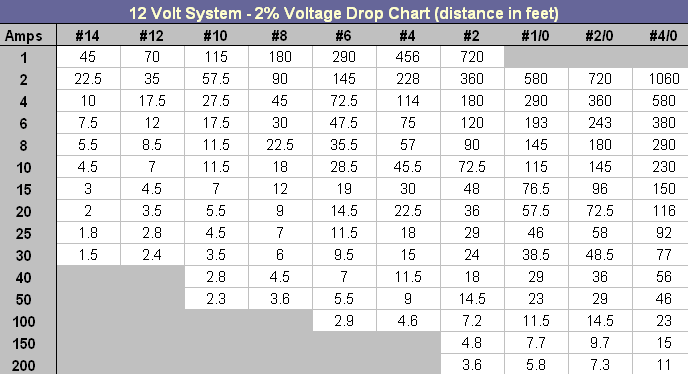

Below is a chart showing the current, the wire length, and the gauge.
