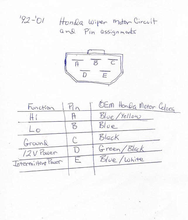

This may help, the 1992-2001 Honda wiper motor pin outs when facing the male connector coming from the motor are, left to right ABC on top row and DE on bottom row.(See Diagram)  This is particularly helpful when purchasing a rebuilt motor. Also some of the Honda Motors over the years used slightly different wire colors.
