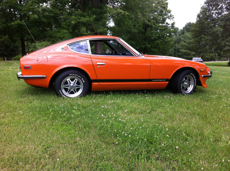

Finally got my 240Z!
I posted on here a while back when I was looking at ads and now I've finally had the time and space in my garage to pick one up. The car is in great shape with no rust and the engine is solid. Bought it from a guy in WV off of eBay... the whole process actually went pretty well.
It has a couple problems that I'll be working on soon... few paint chips around the corners of the hood, parking brake doesn't work and there is a strong fuel smell in the cabin. So I'm sure I'll be on the forums here a lot asking questions.

Welcome SBK! That is a great looking 240z you got. You will find the community here is top notch with tons of info and advice. In regards to the fuel smell, check your fuel tank vent lines and the seals around your tail lights. These are common "need to replace" items if they have not already been done so. The vent lines run in to a vent tank on the passenger side behind the plastic cover in the hatch area. We look forward to seeing more of your car and hearing about your progress.
Found the Ebay auction for your car as I had been watching it to see what it goes for. Given the condition and amount of work that was put in to it by the previous owners I think the final bid price is very fair. Again, great looking car!

Great looking Z , I have always liked the orange and black . Speaking of the vent lines issue , is there any vendors offering a full kit as opposed to shopping around for suitable gas rated hoses . A kit would be far easier than hoping for the right parts .

I love the orange and black interior! I usually don't like orange on cars but it looks so good on the z. That white looks pretty sexy too.
