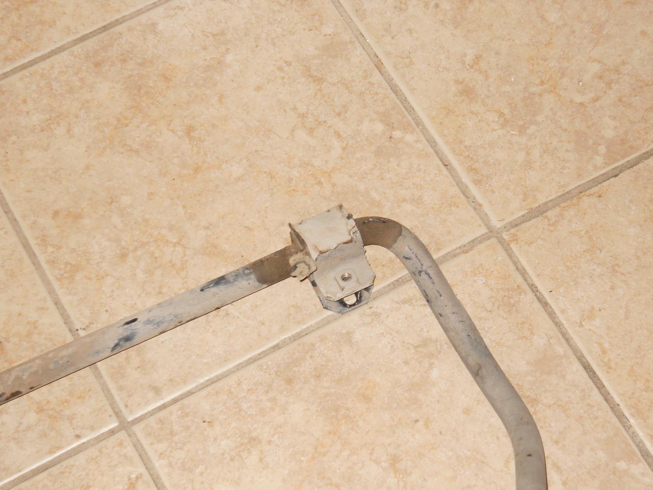

Well I found the source of the noise, oddly enough by putting something in the trunk. The rear sway bar mount on the passengers side is no longer attached to the car, as in it broke off. I haven't taken a good look at it as it was dark but it looks like it had prior rust on it and just broke off. I don't really know where to go from this point. I don't own nor do I know how to weld. I'm assuming this isn't exactly safe to drive with as it will just do more damage correct? The car doesn't handle any different but the noise(s) it makes are scaring me and I don't want to ruin it more then it is already ruined. Any suggestions would be wonderful. Can one run without said rear sway bar?
Thanks
Edited by Pomorza

So I pulled the sway bar off to see the extent of the damage. The passenger's side mount literally sheared off the car, there's no rust, it literally just came off. Attached is the picture. I'm currently going to run without the sway bar in there rear until I figure out what to do with this.
Thanks guys
