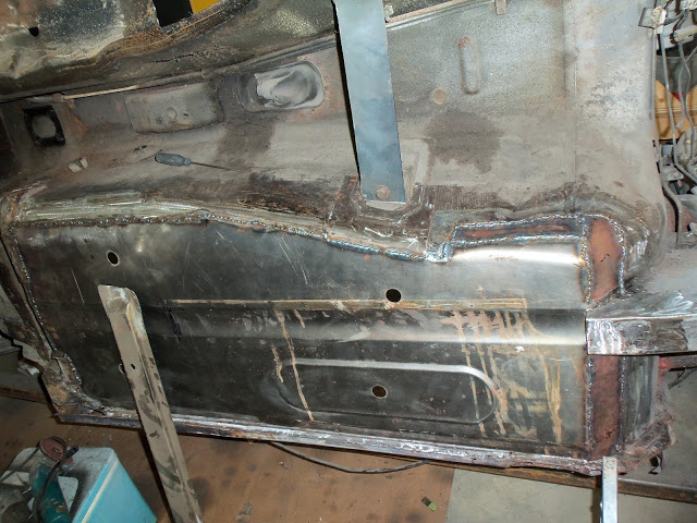

EuroDat nailed it. I have some mediocre metal skills and the required tools but it would have taken me probably 2 extra days to fabricate the same panels i bought from zedd findings:
Floors and Rails
for me 2 days of pain in the arse time is worth quite a bit of money.
