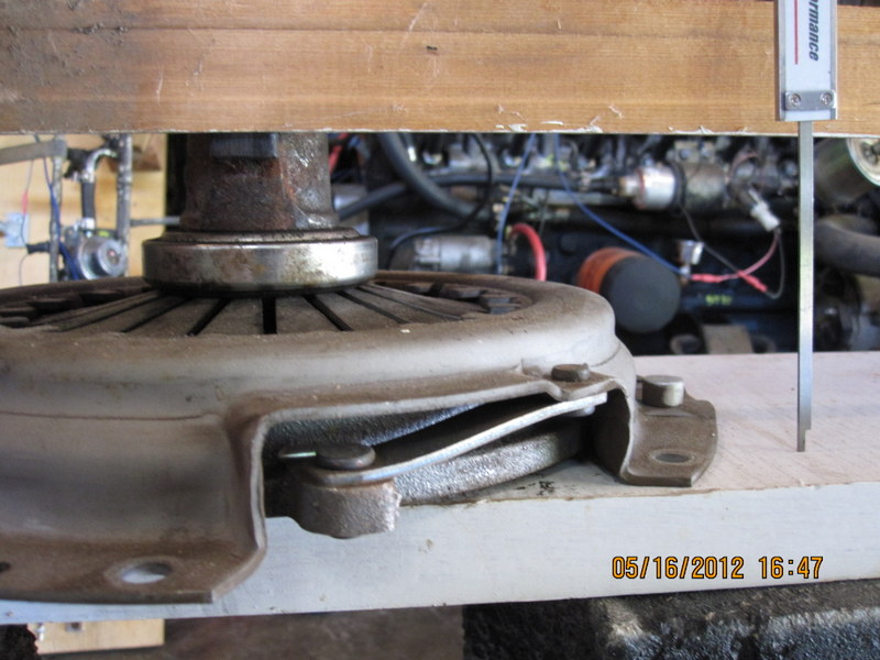

Several people over the years (me and, I think, Eurodat, from this forum) have determined that a stack height of ~92 mm from the flywheel surface to the surface the clutch forks ride on, will pretty much guarantee that the parts will work together. I've attached a picture to demonstrate. Measure to the tips of the diaphragm fingers and subtract to get the collar height you need. There are three or four different collars out there.
Edit - I see that you've already taken the measurement in your first post. Do the math and hope you can find the right collar.
Edit 2 - I re-read your post and realized that you didn't really ask a question. But, 92 mm is still good information. Anyway, good luck.

The old clutch looks original, but the height differance you see is not such a problem.
Meassure the height with the throwout collar/bearing on top. The section where the clutch fork contacts the collar should be around 92mm. You need a collar the match this measurement.

Just looking at the photo's on the computer instead of a smartphone. Looks like someone swapped the transmission for a FS5W71B 5 speed out of a 280Z (Wide ratio) and left the F4W71A transmissions clutch in place with the throw out collar.
Your first photo shows clearly the clutch fork is out of the F4W71A Typa A 4 speed transmission. See extra hole for the return spring on slave cylinder.
Your throw out bearing collar is most probably also out of the F4W71A transmission and too short for the new clutch pressure plate.
Messure the distance from behind the bearing to where the clutch fork contacts the collar.
The distances are:
Type F4W71A 4 speed - 16mm.
Type F4W71B 4 speed in the later 240Z/260Z - 29mm.
Type FS5W71B 5 speed in 280Z - 25mm.
The new pressure plates is for the later models. Check with the supplier to confirm. Most parts stores dont know the difference and give you the later version. I am not sure if the early version is this available. If thats the case, you will need to hunt down a collar for a 280Z since thay are the most common to find.
