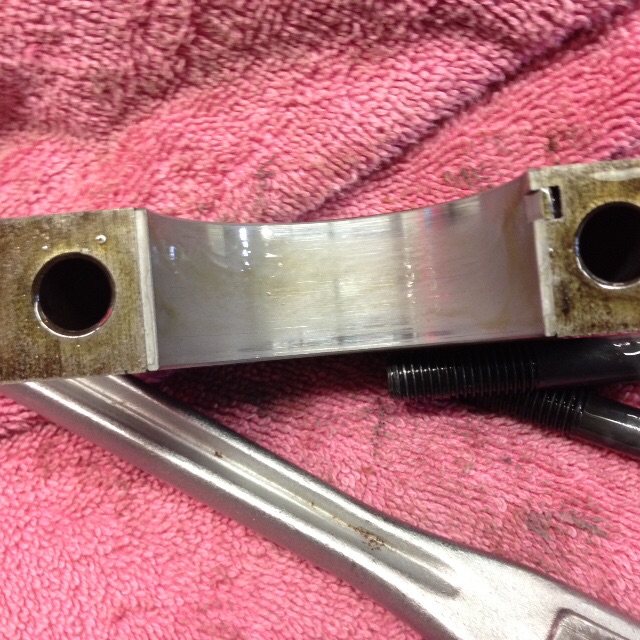

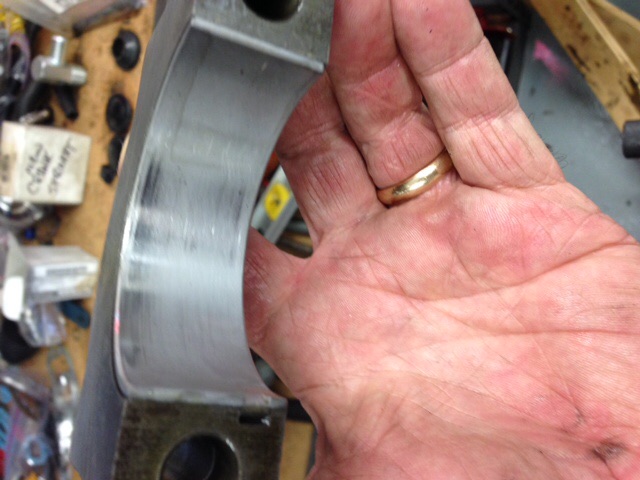

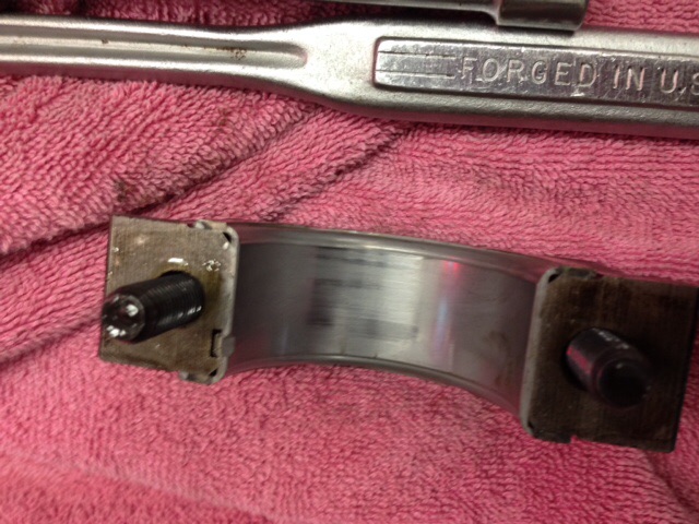

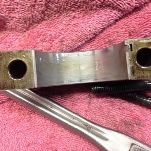

DJ.......Pulled the bearings.....all perfect! The problem was a throw out bearing that my machine shop pressed on backwards. The bearings finally froze up tight and welded to the clutch fingers making that squealing noise and locking everything up. Oh well......another learning experience. The motor is fine!!
