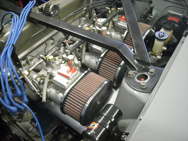

From your pics your intake manifold appears to be the standard depth, if the length of the runners from flat to flat are about 13.5 cm. then that is standard not short. No big deal just know that by the time you get air filters on it gets a bit tight for room.
Your last pic shows that you have rod ends already, if you use those rod ends then the rod and levers you buy will have to be the same diameter.

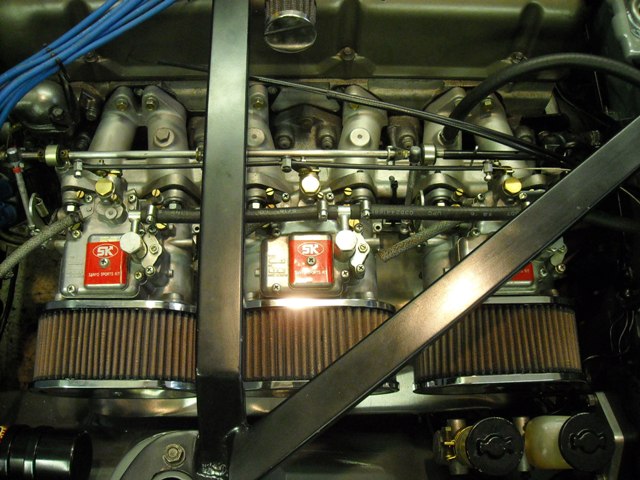

I just installed my SK/OER triples and sofar every thing is running smoothly,

Maybe it was Ted who highlighted it for you? LOL Nice info Granny, i have set of new gaskets directly from OER, only 40 bucks (including shipping!) So far the old gaskets look nice and shiny, so im not gonna change them yet. Atm i have smallest main jets possible(?) (115) but im sure they will be changed to bigger ones. That universal system looks legit, i'll have to compare prices.

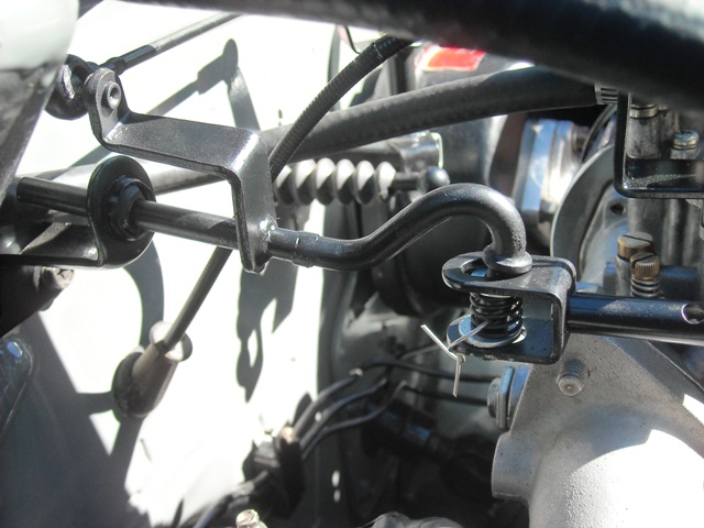

I'd love see close up pic how you connected the oem linkage to triple setup
Edited by Reverend
Pick up one on ebay, measure the angle before cutting, cut to fit, find some metal tubing to fit as a sleeve over top of both ends, drill and insert roll pins or even screws. Sand, fill and paint. : )
Here is a bit of inspiration,
