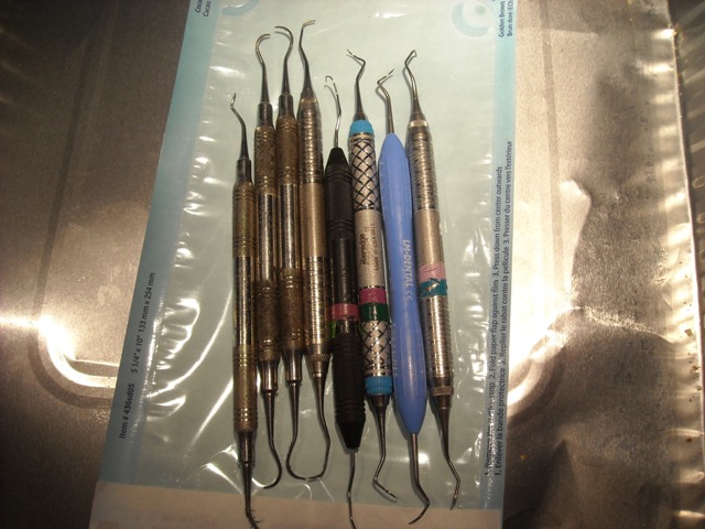

Then I pull out these puppies,
Everytime I go to the dentist I ask if he has any dental tools they are throwing away and he always has a few for me. They my not be new enough to use on teeth but they perfect cleaning carbs and they are free.

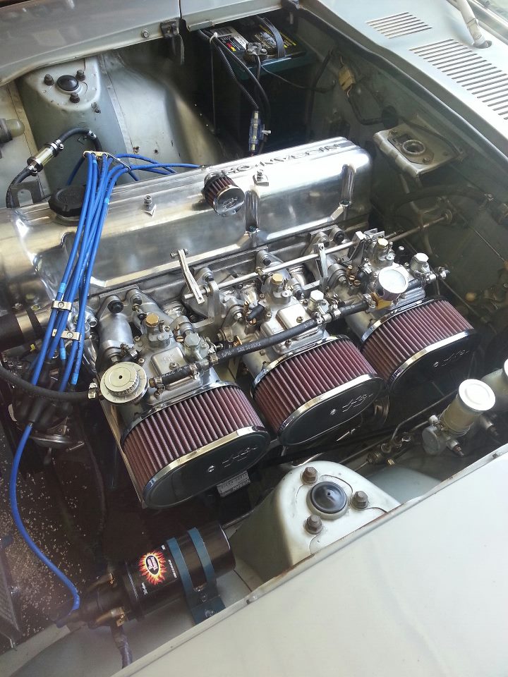

I read this thread yesterday and was going to post the manual but it looks like it's already been done. Here's a recent photo of mine. I paid $800 for them including the intake. They are 45mm and I have about 8 hours worth of cleaning into them. I noticed that like a photo posted above, mine don't have any model # stamps on the top plates. The 2.9L engine is fairly modified (check my build thread for specs) and they seem to do ok. They are even running admirably on the factory mechanical fuel pump. I plan to go with a Mazda RX7 unit when I find one. I have some vacuum leaks I'm dealing with right now, and timing is still set by ear.
