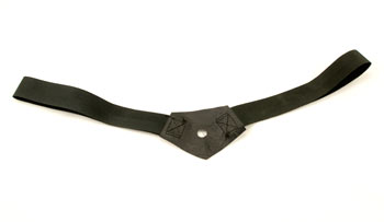

I'm having a hard time finding any information or pictures of the seat belt strap that secures to one of the screws underneath the center console. MSA sells a reproduction. What years did these come factory on? Are the straps supposed to angle back or angle forward?

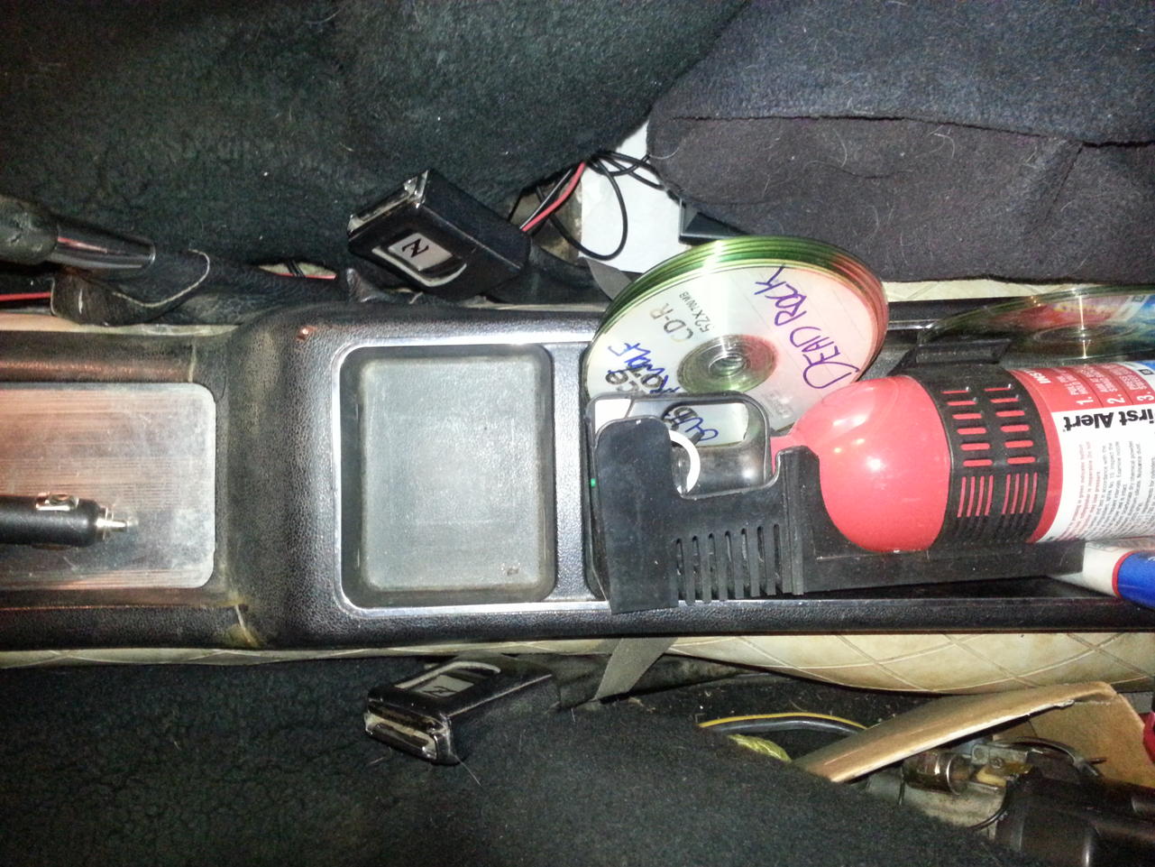

Yep, my lap belts are retractable and the female receptacles are pretty stiff. The strap acts as a limit stop to prevent the female side from falling straight down/forwards between the seats and the transmission tunnel.
You can see 'em poking out in this picture, if you can disregard my mess.
[ATTACH=CONFIG]64869[/ATTACH]
Hey dude, clean that console will ya? LOL
I'll try to give you an educated guess. The parts CD offered by Classiczcars, lists two part numbers for
this item. Under the catagory, body, L24, up to 7/73. The first part number is 86823-E8800. E8800
part numbers are generally for cars manufactured up to 6/72. The second part number is 86823-N3300.
N3300 part numbers are generally for cars manufactured from 7/72 to 7/73.
I can tell you that my 1/71 series 1 car did not have this seat belt holder, and part numbers for cars
manufactured up to 1/71 generally have part numbers ending in E4100, so my assumption would be
that this holder started in use sometime between 1/71 and 6/72. The parts CD does not list any dates of use.
Hope this helps.
Dan
