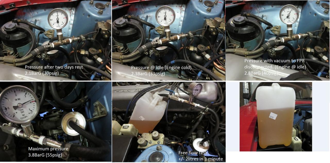

Good idea on fuel pressure, I'll need to pick up a gauge.

Let us know how your pressure is like. Should be around 36-38psi if I remember correctly. It should rise to 40-42psi when turned off if your pump and regulator are working properly...
The maximum "regulated" pressure is 36psig. My car runs at about 40psi which is a bit high. Normal is 36-38psi like TheCrazySwede just mentioned.
See attachment for the results of my test. I didn't think of doing a flow test under normal operating pressure which would of made it complete.

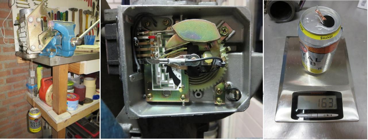

Adjusted the AFM by using the beer can method on the Atlantic Z website, it was a little off, so I adjusted it. Put the AFM back in and cranked the motor. Still popping out the exhaust, running rough, and not idling.
I left the cover off and played with the rotating mass as the engine ran, doing this I can get the engine to idle. So maybe I didn't adjust it enough? I'll look into that some more. At one point I was adjusting the timing and messing with the AFM to see if I could get it to run any better. Not much success.
I might have stumbled across something too. I'm not sure I'm running on all cylinders. I pulled the fuel injector harness on 6th plug and the engine didn't change much. I then pulled the plug with the fuel injection connected and I didn't notice a change. It's getting spark, I could see it arch when I put it close to the plug. This might be another avenue to look further into.
Hanging the can, you can't tell in the picture, but the can is hanging.

Did you adjust the spring to give it more tension? Mine was about 125grams + the weight of the can. There was evidence of tempering in mine. You could see an indent in the whell where the screw first was and the sealant used on the cover wasn't original. I believe a past owner was compensating for ECU drift or tried to gain performance by richening the mixture.

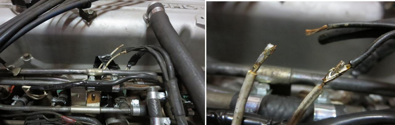

Im having some problems with mine since I had a water in the fuel a couple of weeks ago. The PO did a lot of work, but the quality is in some places now showing. After playing with the injectors, it started missing badly and I found this.
Its still not right and now stutters under load or acceleration. Don't have time to check it now, but once easter has past Ill start investigating.

I'm not sure you did the calibration correctly... I think you have to use a Canadian beer. :bulb:
Seriously though, I wish I could tell if my AFM has been messed with. I've looked it over from every angle, and even with magnification, I can't tell for sure. I've got no glue blobs or marks that would indicate one way or the other. My cover had been popped by a previous owner, but I can't tell for sure what (if anything) he did in there.
Yer, Not sure what a Canadian beer can weight is, but my alcohol free club soda with a hook for the string comes in at 15grams. Probably should of used a Heiniken beer canLOL
When I adjusted the spring to 148grams plus can I couldn't fine tune with the Thermo pod resistor. Thats way I reduced the weight back to 135gr plus can. The temperature sensor was reading 2820ohms at 16degC. which is close to the FSM spec.
PS: I clamped the AFM mounting bracket in the bench vice. Didn't like the chances, and my luck would be a 95% chance, of the AFM free falling to the floor.
Chas

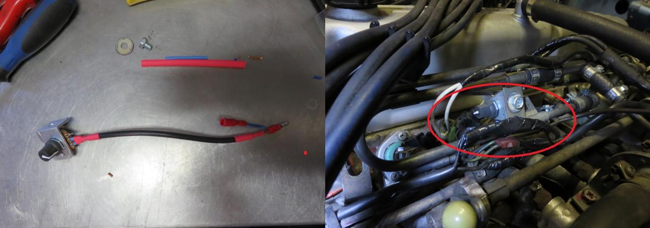

Still waiting on my fuel pressure gauge to come in. I ran a compression test on it today just to cross it off the list. All good. I might have stumbled across something. Plugs 1-4 were fouled, 5&6 were clean. I know the engine is running rich so that explains the foulness. But it looks like 5/6 are getting fuel, they are getting spark, but since they were not fouled this leads me to believe those cylinders aren't getting fuel. I clean the contacts on the injectors, that didn't seem to do anything.
Any suggestions on my next course action? Is there a way to test the individual injectors, or should I just buy 2 new ones? Thanks guys!
(Picture or it didn't happen)
