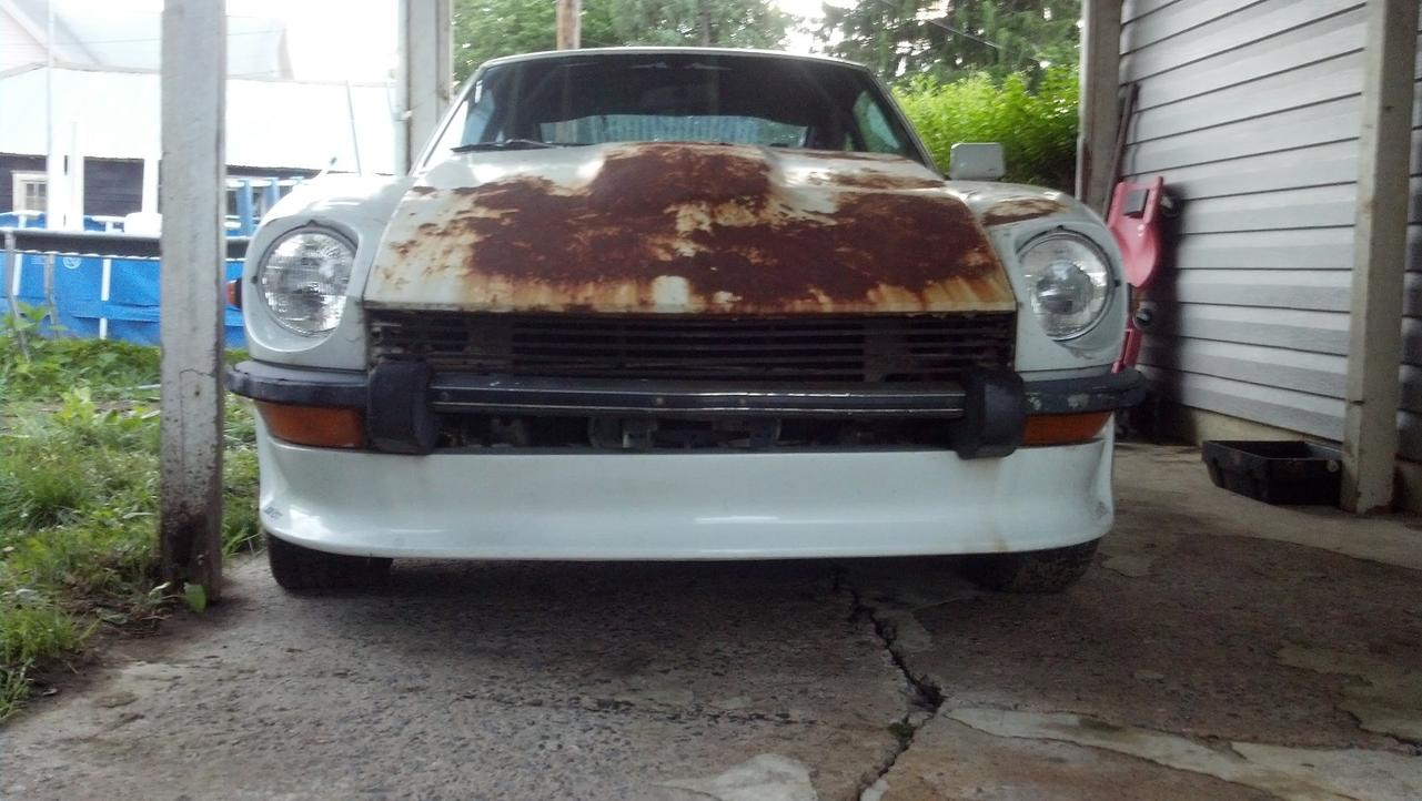

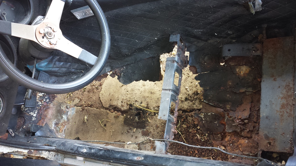

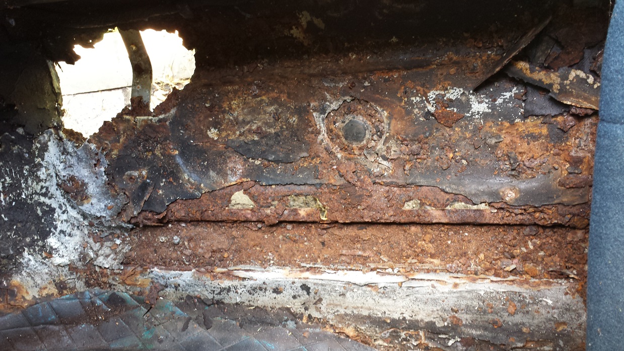

After looking it over I found some cool things about the car. It has rear molded in fender flairs,sunroof, and ground affects. The motor and trans in MINT! After cleaning a little bit of dust off of it you can really see the new paint. The bad part is like most Datsun's I have seen. The floor pans are shot. When I say shot I mean one of the worst I have delt with even in convertibles. The pass side not so bad but needs replaced. The hood has alot of surface rust on it but it is repairable. It looks like there is a little hail damage on some parts of the car but that's a easy fix. So far that's about the only things wrong with it.

I took the driver seat out to look over the floor pan better and cut some of the old stuff out. The floor is so bad there is nothing 10 inches down from the gas pedal to the very back where that 45 degree up bend is, but the drive shaft tunnel is solid as can be. Also inspected the rocker frame and that seems really strong as well. . I have some really thick sheet metal I will be replacing the floors with. I took some of the rust off the hood but not finished.

It was a special order AC floor pans HAHAHA! Yea I know there isn't any. I also know there a unibody. I will be putting thicker sheet metal in for the floors and I will be welding up a support to help with it. Everything else on the car is really nice. behind the wheel wells are almost mint. Also the engine bay looks really good to. the battery tray only has a spot of surface rust.

Look for more rust. Usually double to triple what you see. It will look solid and the paint may even be nice. But poke at it with a screwdriver and you'll go right through.
Ohhhh. Yea been there done that years ago and learned my lesson haha. No its all solid but the floors and a little but of surface rust. Fender wells look awesome! Remember this is its 2nd restoration. The first the guy didnt even get to put more then 100 miles on it. I can see where he tried to patch the floors. This guy was even doing leding. Thats a lost art. Many dont even know what that is.
