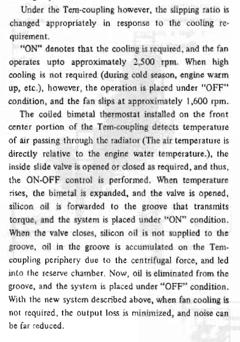

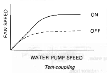

Aren't the clutches filled with grease or some type of oil? If it spins less freely when it's hot it's doing the opposite of what it is supposed to do, right?
It's a little more complicated than that. It is a fluid coupling that is designed to slip when cold, and then stiffen up when hot, but still allows some slip so it doesn't spin at 7000 RPM and explode when you pin the throttle.
