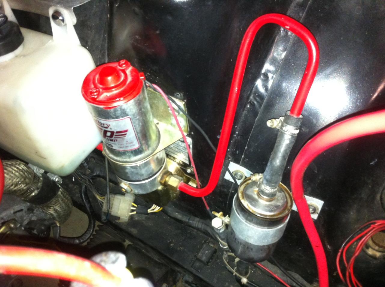

p/o has installed a mallory series 110 electric pump, and looks like disconnected the flow guide valve. I'm guessing the can before the pump is likely a fuel pressure regulator?

That looks like a Napa fuel filter to me, isn't that what it says on the side? You may have blown a fuse for the fuel pump, hopefully that is, instead of burning it up. Can you straight wire 12 volts to the pump and listen for the whirling sound? or pull the out bound hose to the carbs and see if it flows fuel out into a jar or something. If it had plenty of gas in the tank I wouldn't think leaving the key on would burn it.

No in-tank pump on any S30. All 240 had mechanical pump on the engines, some had addition electric pumps back by the tank. THat can next to yours is filter.
The fuel pump quit for sure. Most likely problem is the +12 power to it has been lost. Blown fuse, bad connection most likely. Plugging wouldn't burn the pump up quickly.
The red wire attached to it runs somewhere, likely to the ignitions switch of something that gets power when the key is in the ON position. Just trace the wire back and see where it goes, then it might be obvious why its not connected anymore (like loose or blown fuse in-line).
First test, turn the key to the On position and test for +12v at the red wire on pump. There is no exposed wire at the pump, so trace it back where it goes until you can get a bare end to test. Or expose a tiny bit of the copper on the wire near the pump, or slice into with a razor blade to touch the core wires and touch you probe to the blade.
Check the black ground wire too. It has to be connect to car metal somewhere or the - side of the battery.
If you can't figure out what went wrong, just re-wire that red wire to a new spot. Find a fuse position that gets +12 when you turn the key on, and temporarily connect the red pump wire to the fuse connector by tucking a bare end under a fuse. Make this VERY temporary, it will get you running. Make sure you put that wire under the terminal closest to the CENTER of the fuse box or you may risk blowing that fuse with the extra pump current. Worst case, just connect it straight to the battery +12.
Having the pump up front like that is a poor idea in general. Pumps are good pushers, not all are good suckers. The inlets tend to need to be below the bottom of the tank. That particular pump is a decent sucker, but it belongs in the back with the tank. Later!

well that was a ****ty way to spend money (referring to the tow) traced the fuel pump wire. negative direct to battery, positive going to the ignition with a inline fuse that was tucked way up in the dash so I missed it. fuse had blown. wonder what would have caused it?

The part that got me was I checked all fuse in the fusebox and didn't see any troubles. But after I got it home I traced the wire from the fuel pump and found one of those inline wire fuses that input a 10amp blade fuse, that one was where the fuse blew. the wire was tucked up under the front dash and then joins in a wire coming from the ignition switch which is why I missed it when it happened.
The fuse was melted with slight blacking on the elements either side of the break, but no blacking on plastic housing. I'd say a .5-1mm break in the fuse element.
Edited by Wingsuit
The 10 amp fuse is a suitable size for that pump. Mallory recommends 7.5 amps. The wide gap in the fuse along with the black spots indicate a short circuit type of overload. Considering this type of fuse failure you might have an intermittent short due to a bare spot on a wire somewhere or perhaps something in the pump itself. If you have a recurrence inspect the wiring.
