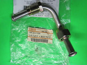

The Z is at the local shop for exhaust and brake work, and the EGR tube on the manifold is rotted out. (EGR Tube A - Federal Emissions)
Since Illinois requires emissions testing, I don't think I should block it off - Courtesy has it listed as NLA, and MSA wants 80 bucks - Zcarsource wants 85. Anyone have a used, good tube for sale, or know another place I can look for one?

It looks like the EGR tube is NLA, but Courtesy has some, but I'm not sure if the part is 14120-N4701 for Federal, or if it's N4702. I've run into conflicting reports.

Kelly, honestly, if I were you, I'd go with a brand new EGR tube, even though it's expen$$$$ive. You want the tube to last as long as possible. It's a bear to remove (and might even require assistance from a machine shop to do it). You don't want a tube with ANY head start on corrosion. Even if you're not actually doing the work, there can be a lot of labor involved, which of course you pay for.

I second FastWomen on the new tube. I bought one from MSA a couple years ago. Couldn't see paying more for a used part when I could get it brand new. It was a little difficult installing it though. Mostly because it's not the easiest to get to.
http://thumbs2.ebaystatic.com/d/l225/m/mIB-l8nSsw62-X7PESw5EQA.jpg

Go to the above link.
This is a Fed one 14120-n4701

Alright, order placed. Hopefully stuff shows up by the middle of the week so I can drop it off at the shop. The good news is that the rest of the brake setup looks good - no leaking, no rusted or damaged lines. This EGR tube seems like a pretty stupid bit of design in being both inaccessible and prone to corrosion. Looks like they're getting harder to come by for federal emissions cars, as well.
