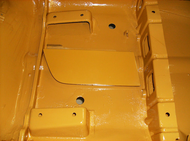

The link worked fine for me, very interesting read. Noteworthy update at the top of the page about marine paint now being the product of choice - I suspect it provides a harder finish. I also found a use for oil-based paint (Behr, not Rustoleum) for my interior floorboards. I took my inspection lid to a big box to be scanned and they mixed up a quart to match. They recommended Penetrol to aid in the flow. You can see the match in the pic.
Very nice! I worry a little about some of the hard to reach places in achieving a smooth gloss finish. However, I'd be repainting the same color, or as close as I could so maybe it wouldn't be much of an issue.
