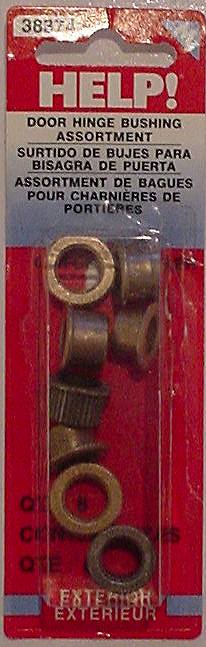

I went with the chrysler door hinge bronze bushings and it was super easy to install and my shift feel is crisp and wonderful. I see no reason to use plastic bushings when such a cheap and easy bronze solution is available. The parts were hanging on the peg at the local parts shop!
Around five bucks, just slot in the ones that fit, the rest got thrown in my parts bin.

My plastic OEM bushings lasted nowhere near 40 years, they shattered and fell into the transmission to get ground into dust many moons ago.
Did the same, very crisp, no slop.
