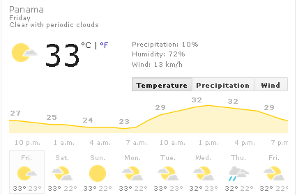

Most vehicles here are warmed up before 5min at -10C
