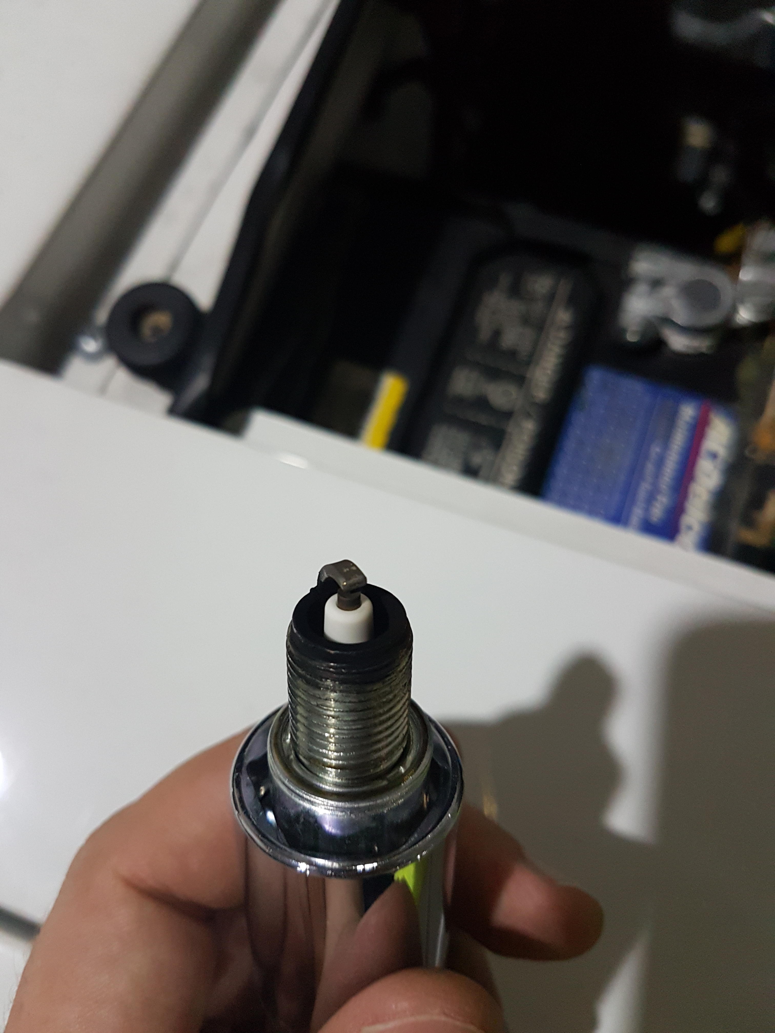

Tested the car today. 2 to 3 mins with choke on. Nice aceleration. No backfire on the intake or through the exhaust. I guess those ngk bp6es former plugs were damaged and even cleaning them with brass brush wouldnt help. I took some pics of the plugs for your approval on the mixture knobs turns. Right now i am at 3.5 turns clockwise both. Any need of readjusting the floats? Lowering the floats more?
 Glad to hear it's running better. Can you confirm that it was driven for a while with the choke off after it warmed up. I agree with Philip. Leave the floats alone and drop the nozzles 1 turn. More pics of the plugs after you readjust.

You want me to drop them to 4 turns clockwise? Isnt it too much?
  That's what we're trying to discover. Four turns down would be wrong for a stock engine. We're trying to get a little more color (tan) on the plugs. Drop the nozzles another 1/2 - 1 turn (your choice) and take another pic of the plugs after you've warmed it up and taken it for a test run.

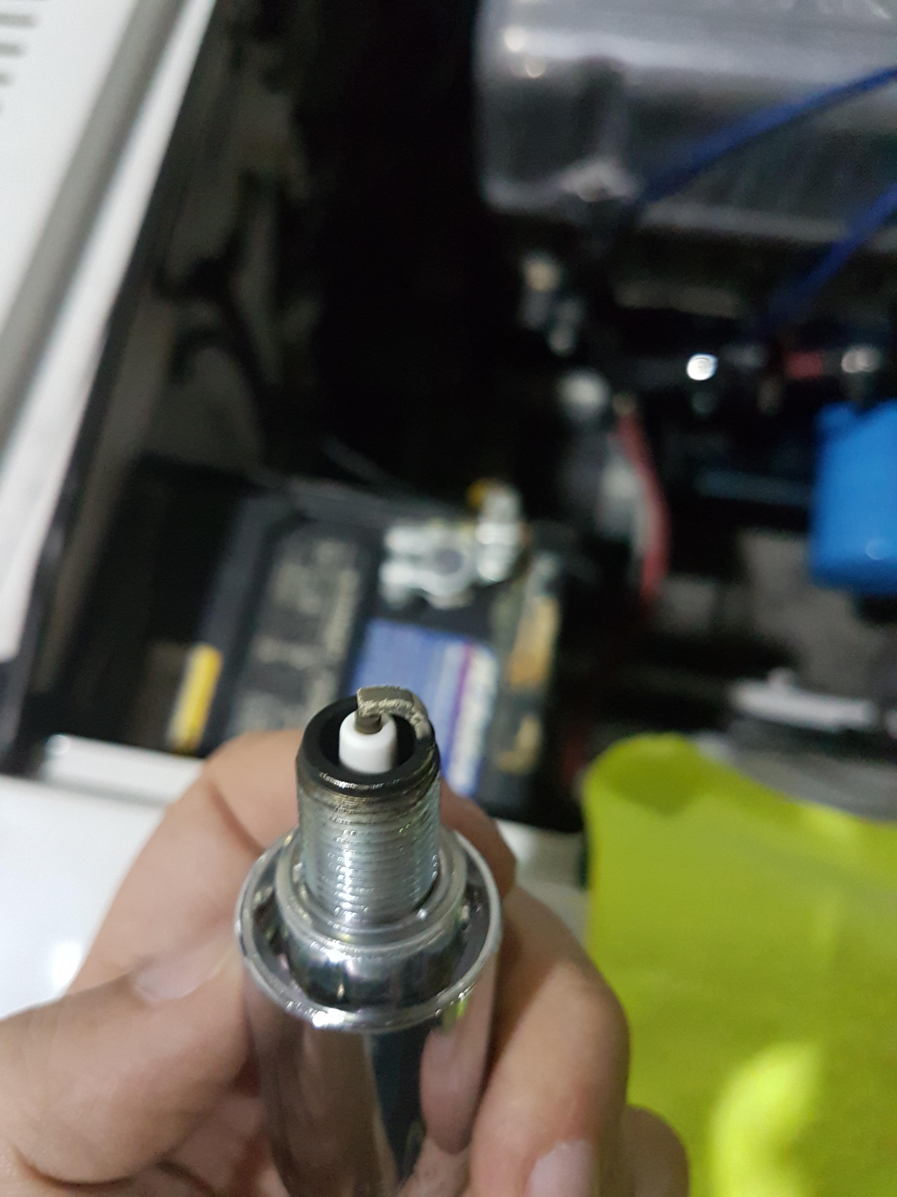

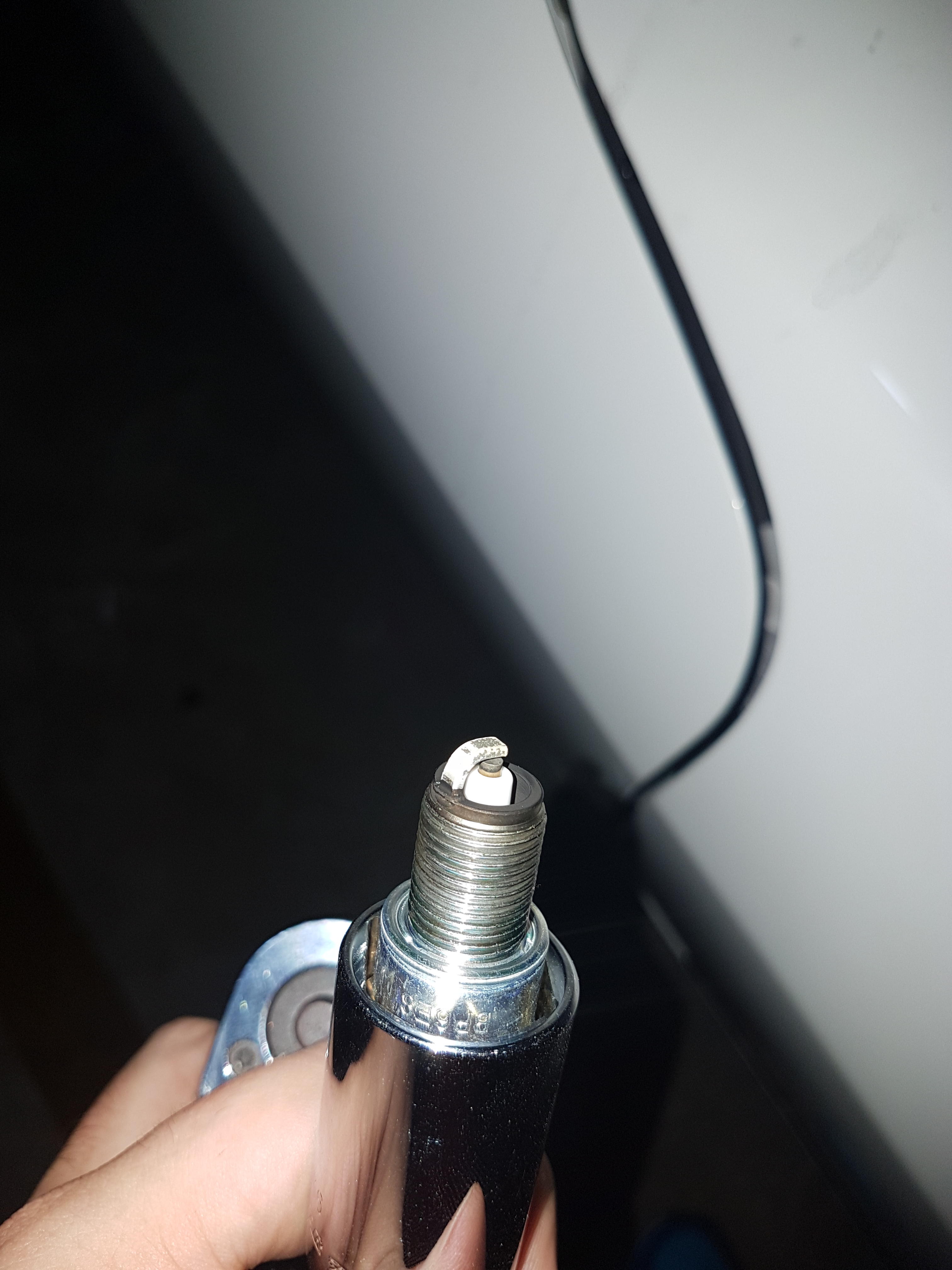

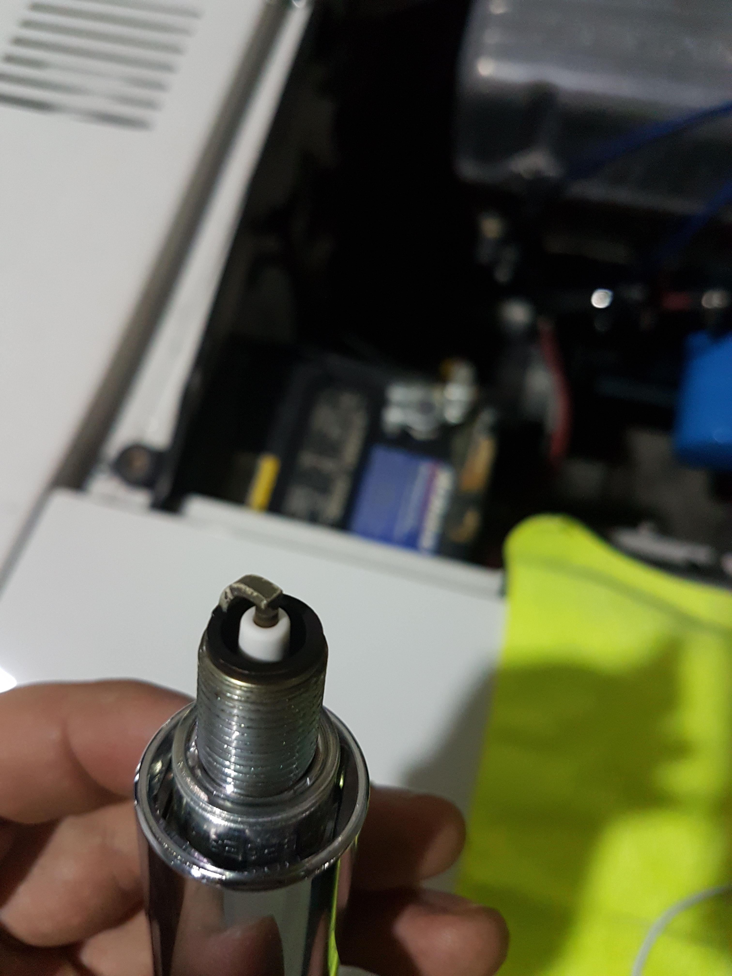

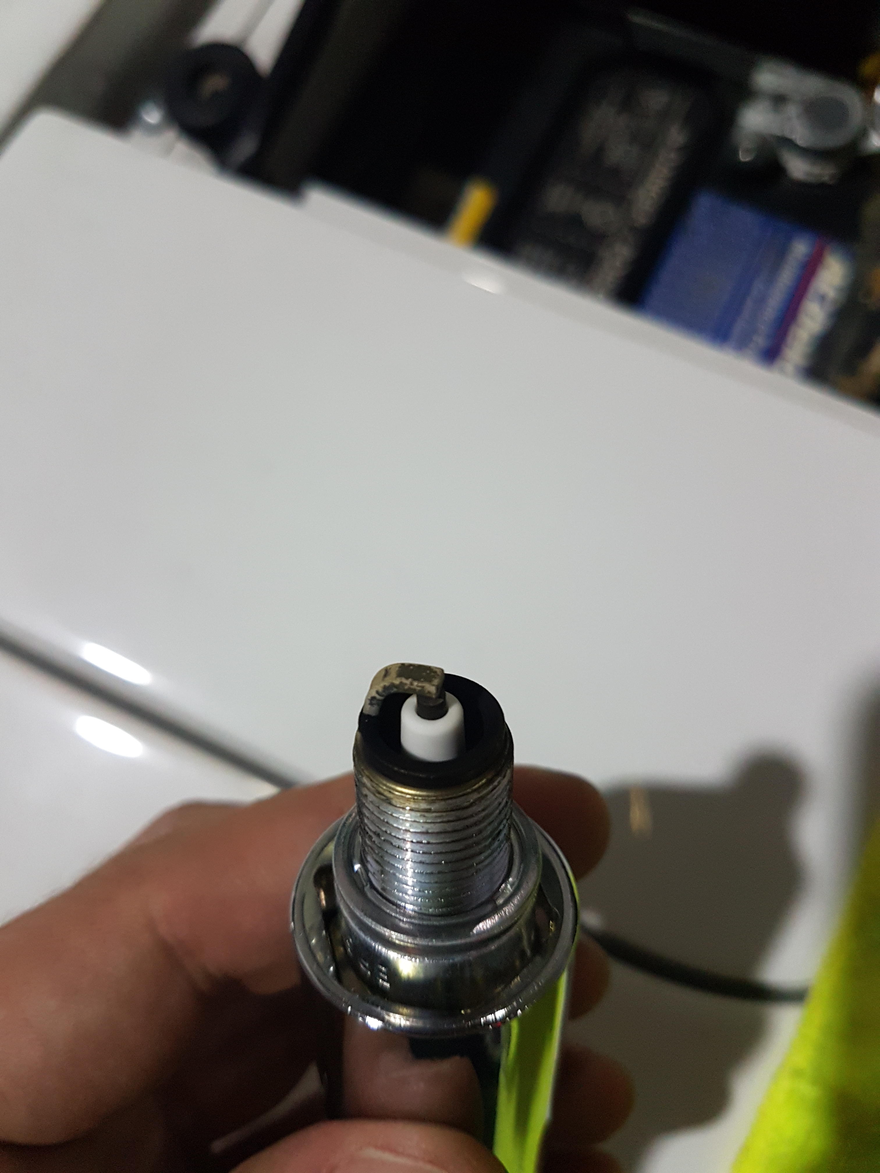

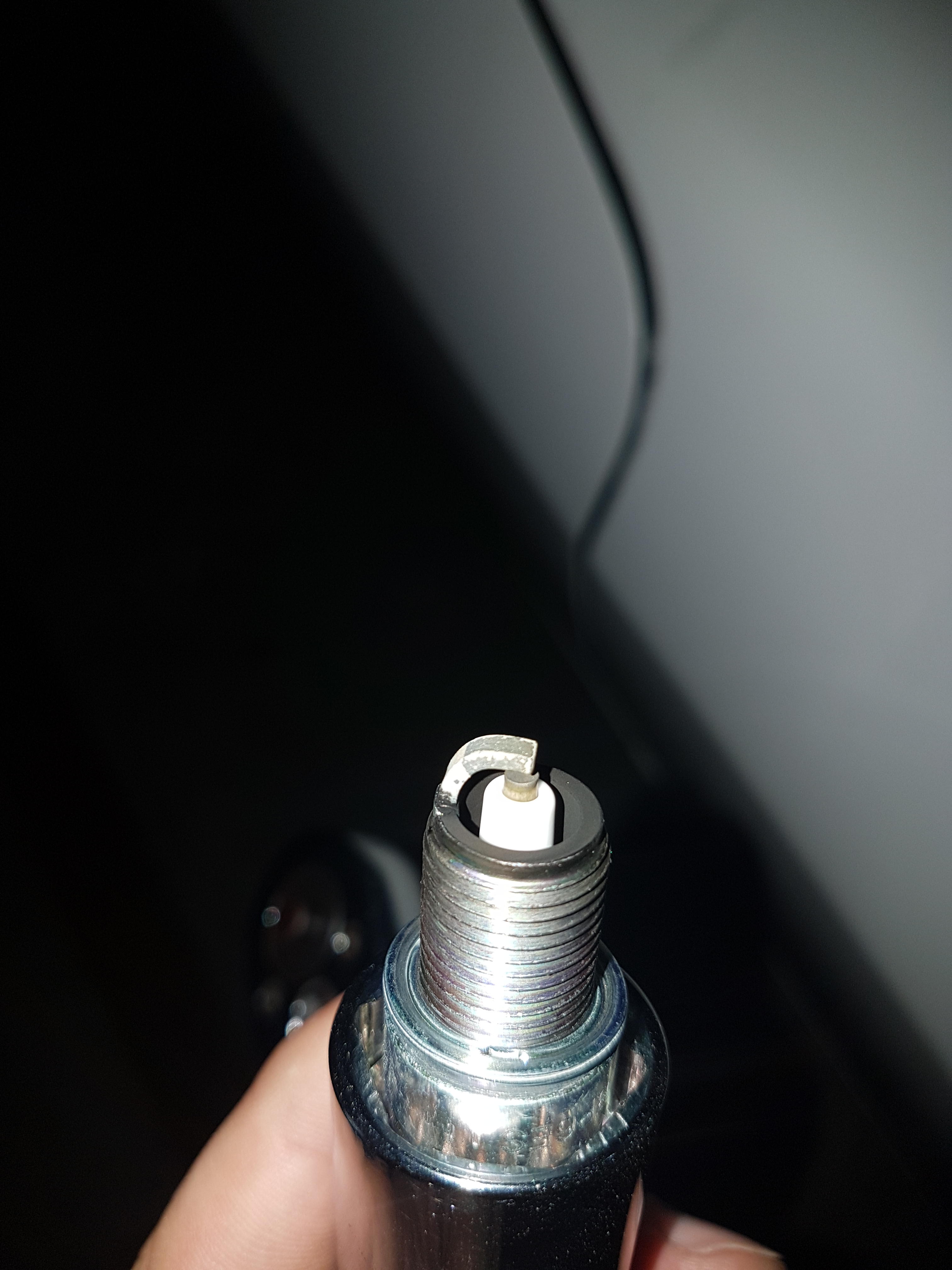

Plugs 5 - 4- 3- 2 after 30 mins of cruising at high speed. Idle mixture knobs set to 3.75 turns clockwise front and rear.
Edited by jalexquijano
@jalexquijano The plugs still don't have much color but that could be caused from the gasoline in Panama. "They" tell me that the gas formula now is not the same as "the good old days". How well does the engine run when cold, warming up and at speed? Any complaints?
