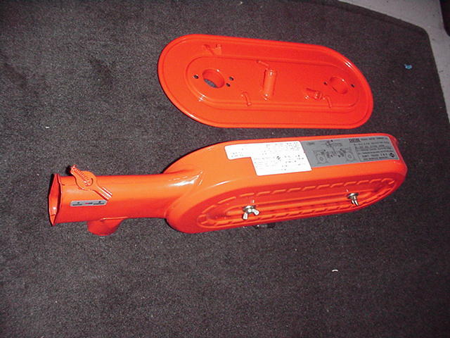

Okay i will turn the idle mixture knob of the front carb to 3.75 turns clockwise and test the car. Now we need to deal with the engine bay heat that causes the plugs to turn black due to the amount of heat inside during long traffic idle times. What if i find a hose and connect it to the air filter box and plug the bottom entrance of the box so it can suck fresh air during idle? Do you think this can be a solution? At this time it only sucks hot air.

Someone can correct me if I'm wrong, but I don't think engine bay heat makes your plugs turn black.  The plug color is a byproduct of internal combustion.  Cooler air to the engine is always a plus, but I don't believe your approach is good.  I live in the desert where the air temp hits 120º and the stock air intake/preheat works nicely just as the Nissan engineers designed it to work almost 50 years ago.  As previously mentioned, stick with the current advice and don't start looking for other variables to fiddle with until carb adjustment is resolved.
