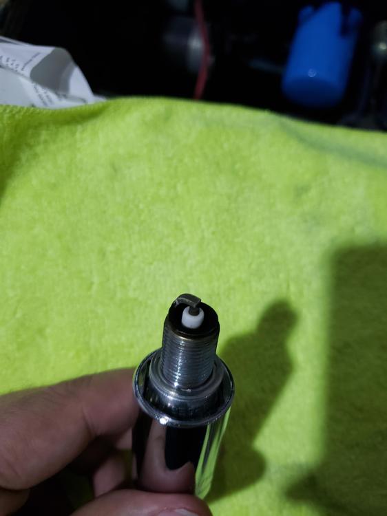

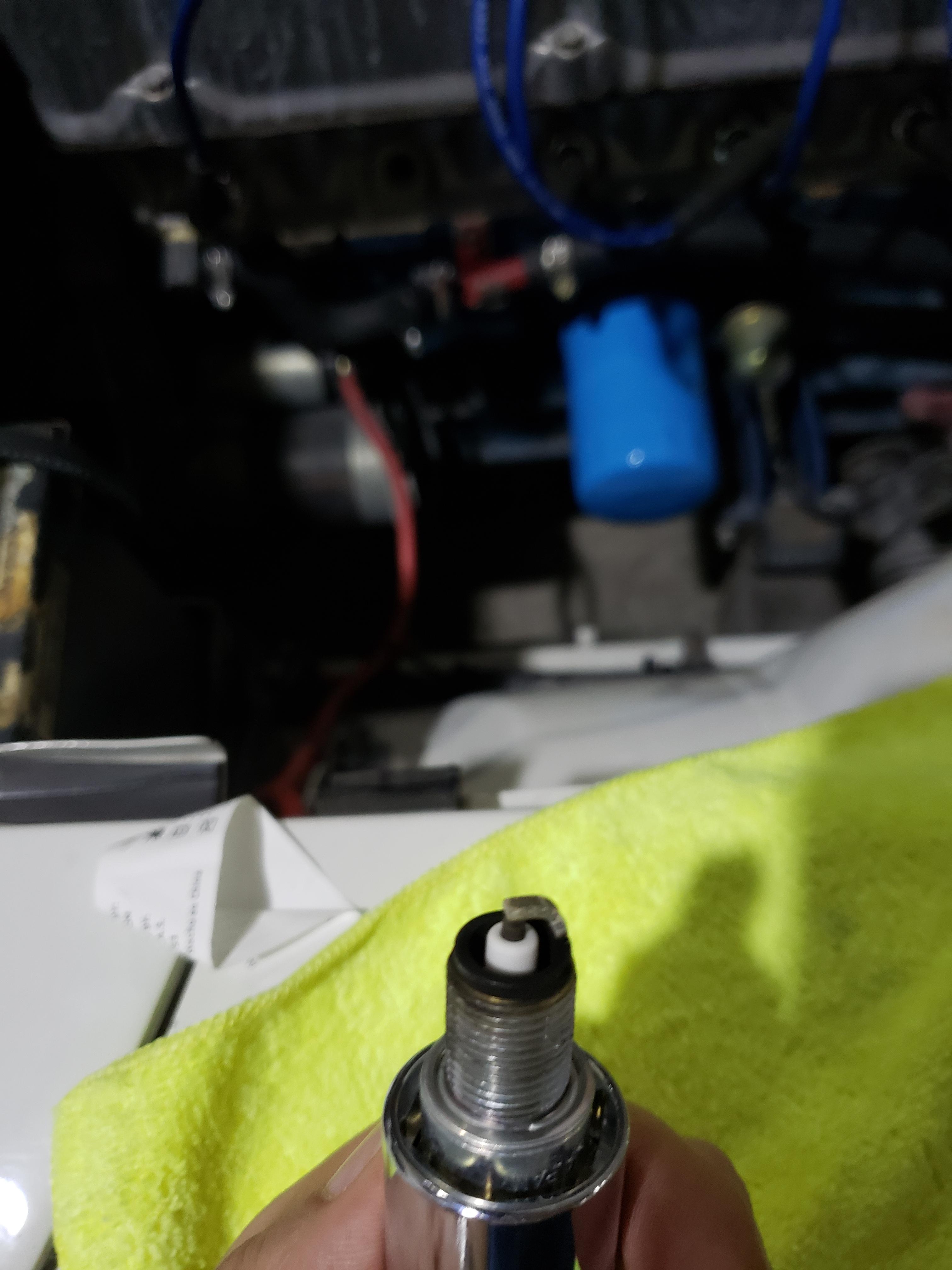

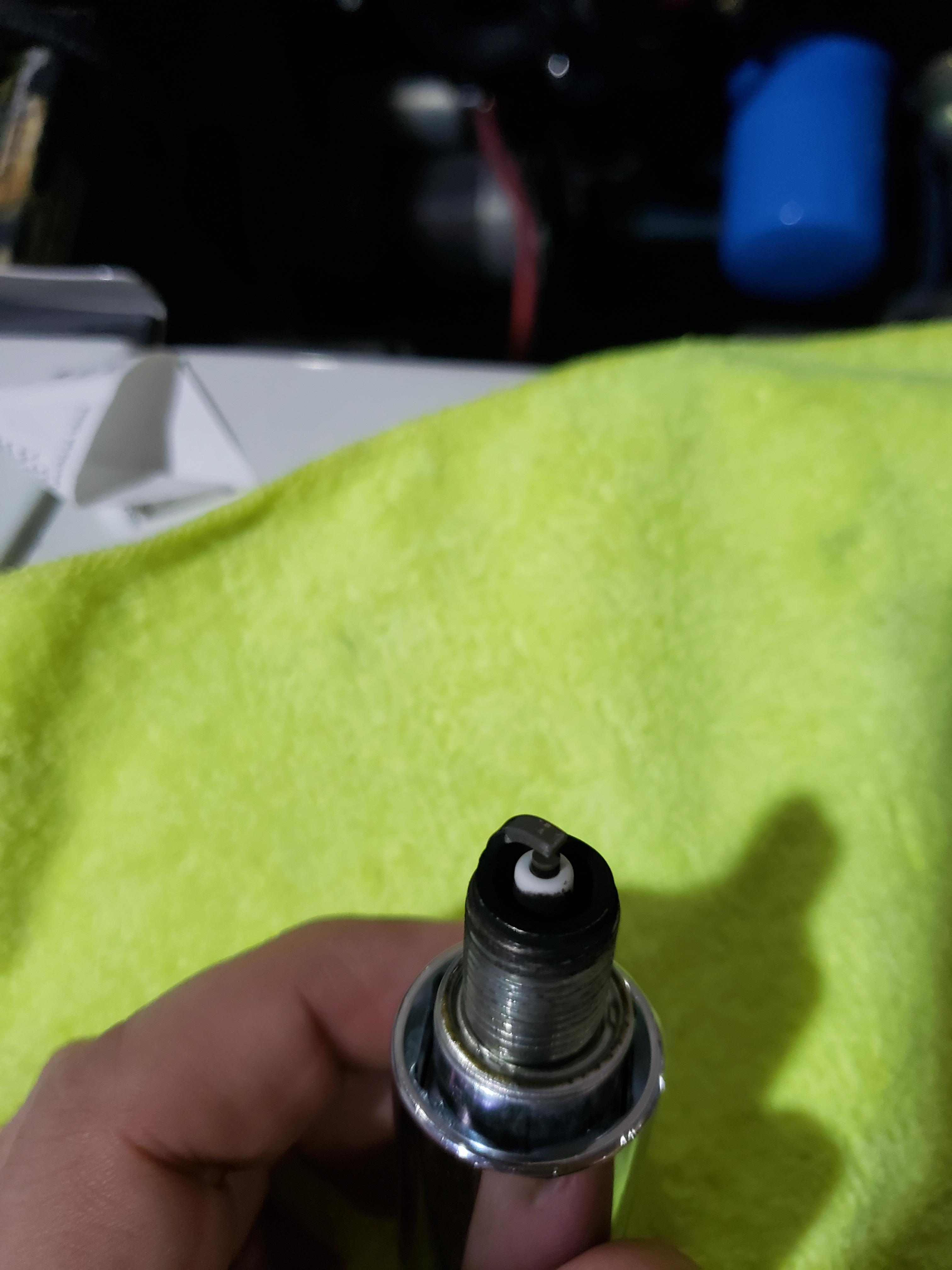

Just took a 20 min ride along the highway at 6pm and a couple of fast traffic lights. Parked the car and pulled out plugs number 5, 2 and 4. Plug 4 now looks a little darker than 5 and 2.20180526_185047.jpg20180526_185047.jpg
 They don't look too bad although #4 is still the odd one. I think I'd try swapping #4 plug wire with another wire to see if the problem moves with the wire. What is your over all impression of the way it's running? Any problems idling for long periods of time? If I was running your engine build, I would expect to have to blip the throttle now and then to clear the plugs at idle. Backfiring in the intake or exhaust? Misfiring at any RPM?
No backfiring either through the intake or exhaust whatsoever. Running nice. I was wondering if before inspecting the plugs i should run the car hard and then shut it down and not as i am doing driving the car around accelerating every now and then, couple of stops on traffic lights and inspecting after parking the car in the garage.
 You want it to run best under normal driving conditions which, I'm assuming, is a daily driver. It sounds to me like it's running pretty darned good. No need to go out and run the engine hard just to check the plugs. You can, however, go out and run it hard to have fun. As long as you share your fun with us. Pics are nice, videos are better. I'd like to hear it run.
