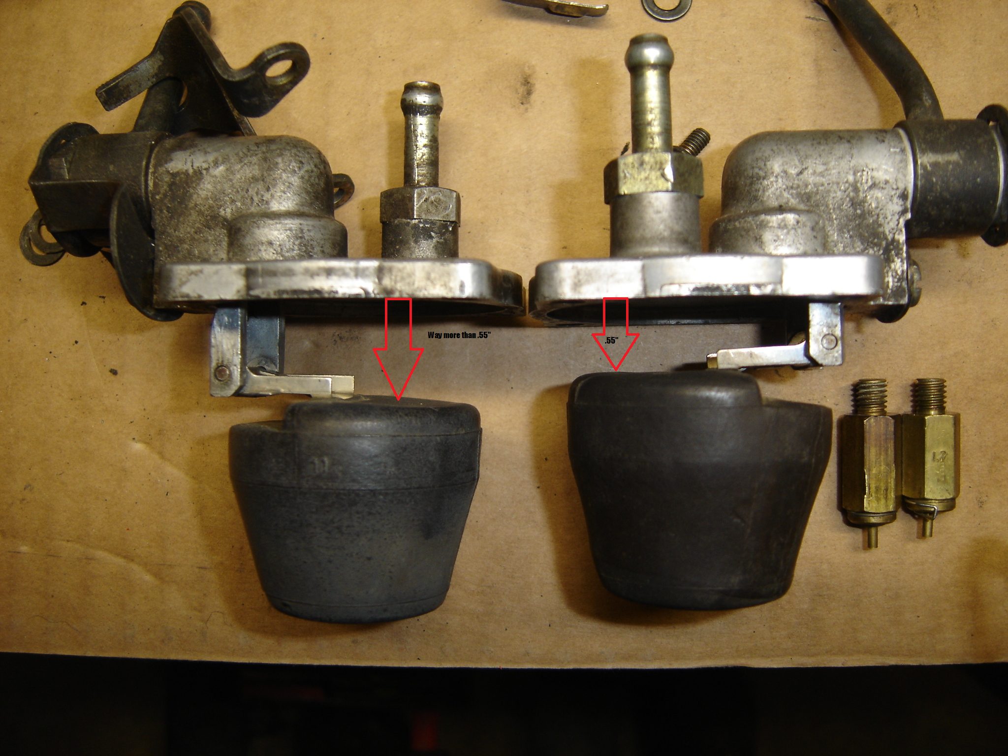

This is good in my opinion.  He basically made you the older and better 4 "screw type".  The ears are equal length now, both are short like the rear carb.  I put two rear carb lids on mine instead of drilling.  I have an extra set to rob parts off of.
Your mechanic did GOOD.

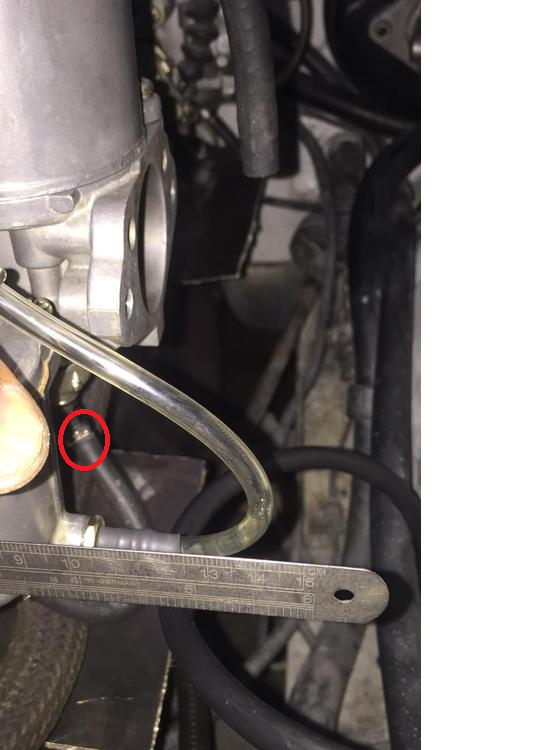

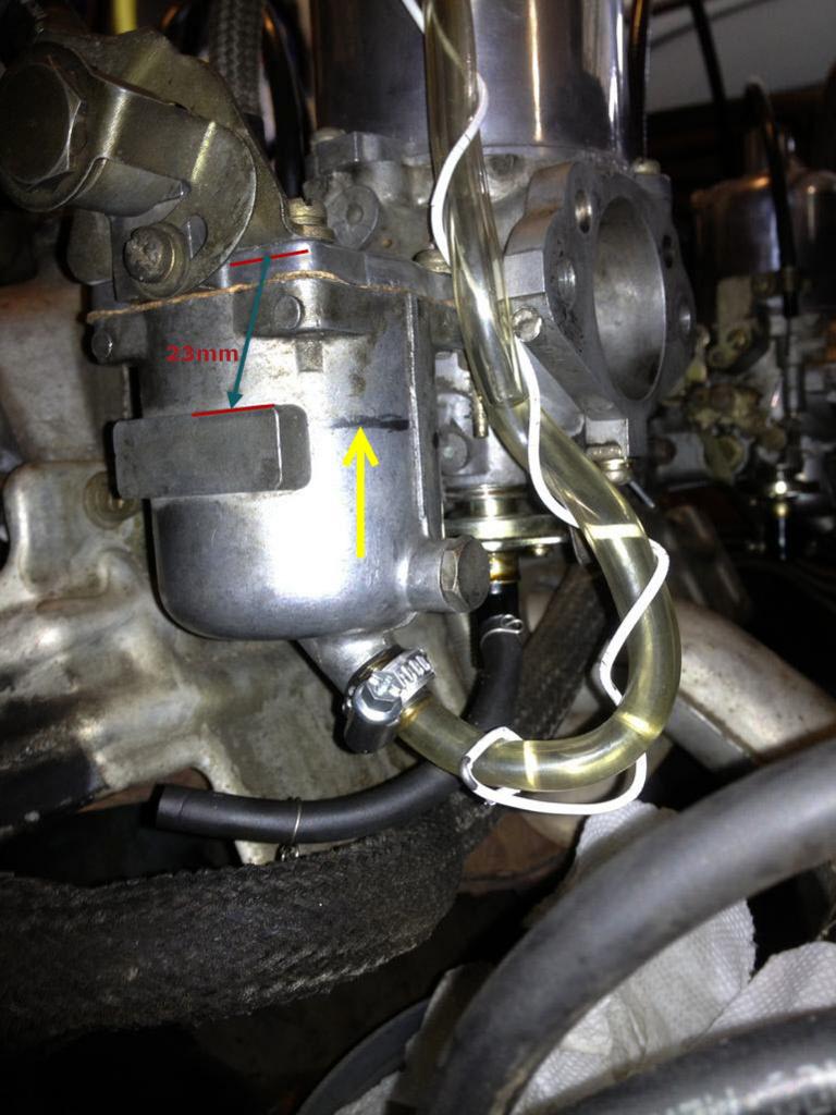

Now get them both set at .55" and put them back together.  Get a couple of feet of clear hose and set it up like the picture, you don't need a clamp on the bottom nipple a Zip-Tie if anything.  Hold the clear hose up alongside the carburetor with some type of stiff wire, like the picture.  Once you get it set up pull the coil wire off then crank the motor over.  The liquid petrol in the clear tube should be even with the circled area on this photo.

That's the 23mm way of setting the floats.  Don't worry about the rear being 21mm.  That's not a big deal.  See below for the reasoning...

Once you get the fluid in the clear tube where it needs to be do what Mark has said.  That will get your mixture knobs exact, 1/16" from top of the nozzle.
Carbs will be good, case closed, move on to other problems if you still have any.

Here's a picture of the lids.  Your mechanic made them even by drilling those holes and raising the pin.  Other people have done it because all you can buy now are short valves.  See the difference in the original valves in the picture below.
