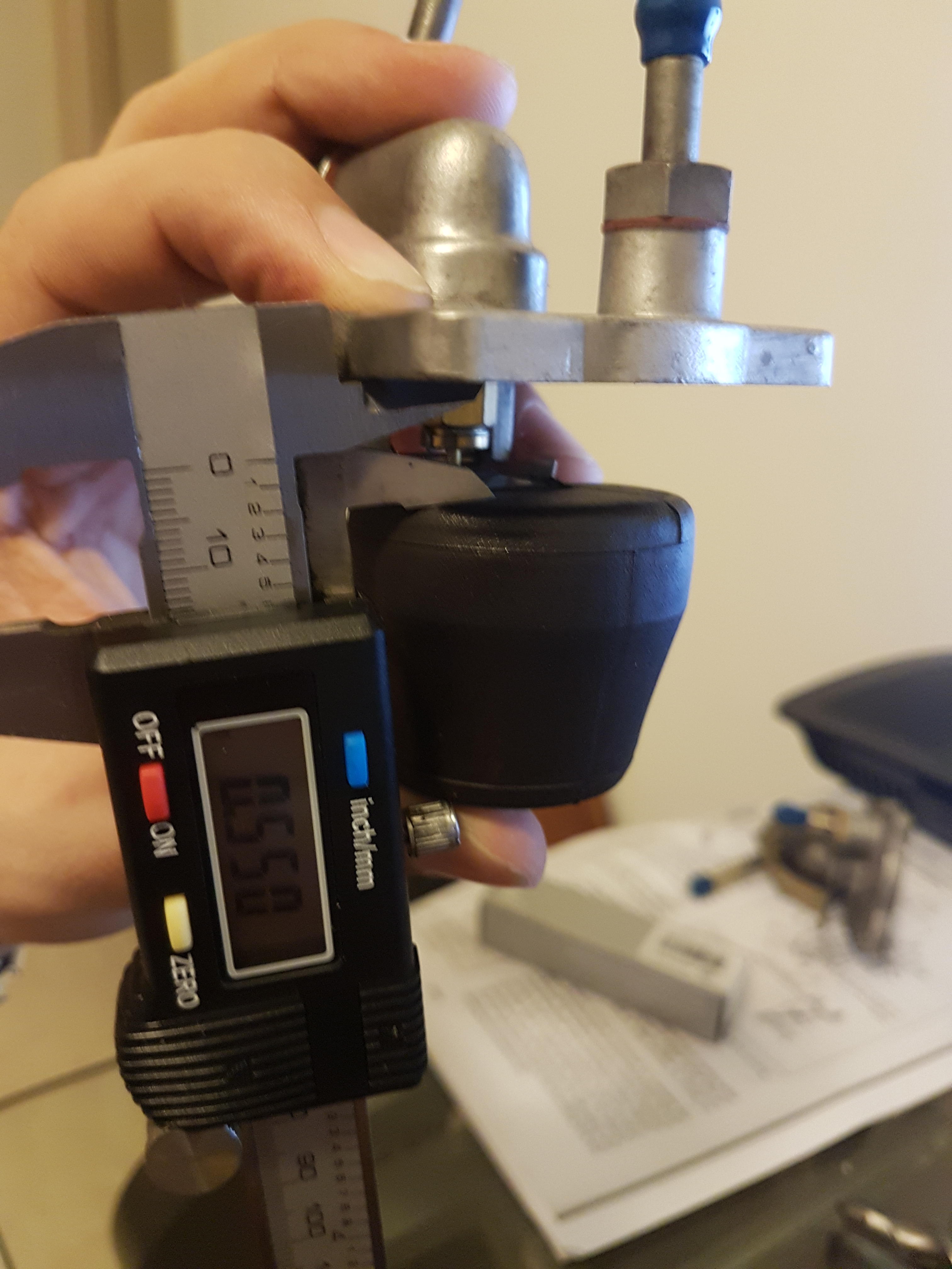

Johnny wick Posted February 16, 2018 Share #97 Posted February 16, 2018 41 minutes ago, Lumens said: Look at dimension 'H' Then read paragraph 2 above again and again. I cannot explain it any better without being there. This is what i was asking. The .55 inch gap is taken with metal bracket underneath the float just touching the needle valve stem as per this picture. No pressure pushing the tip of the valve. Link to comment https://www.classiczcars.com/topic/47304-1972-float-adjustment/?page=9#findComment-542521 Share on other sites More sharing options...

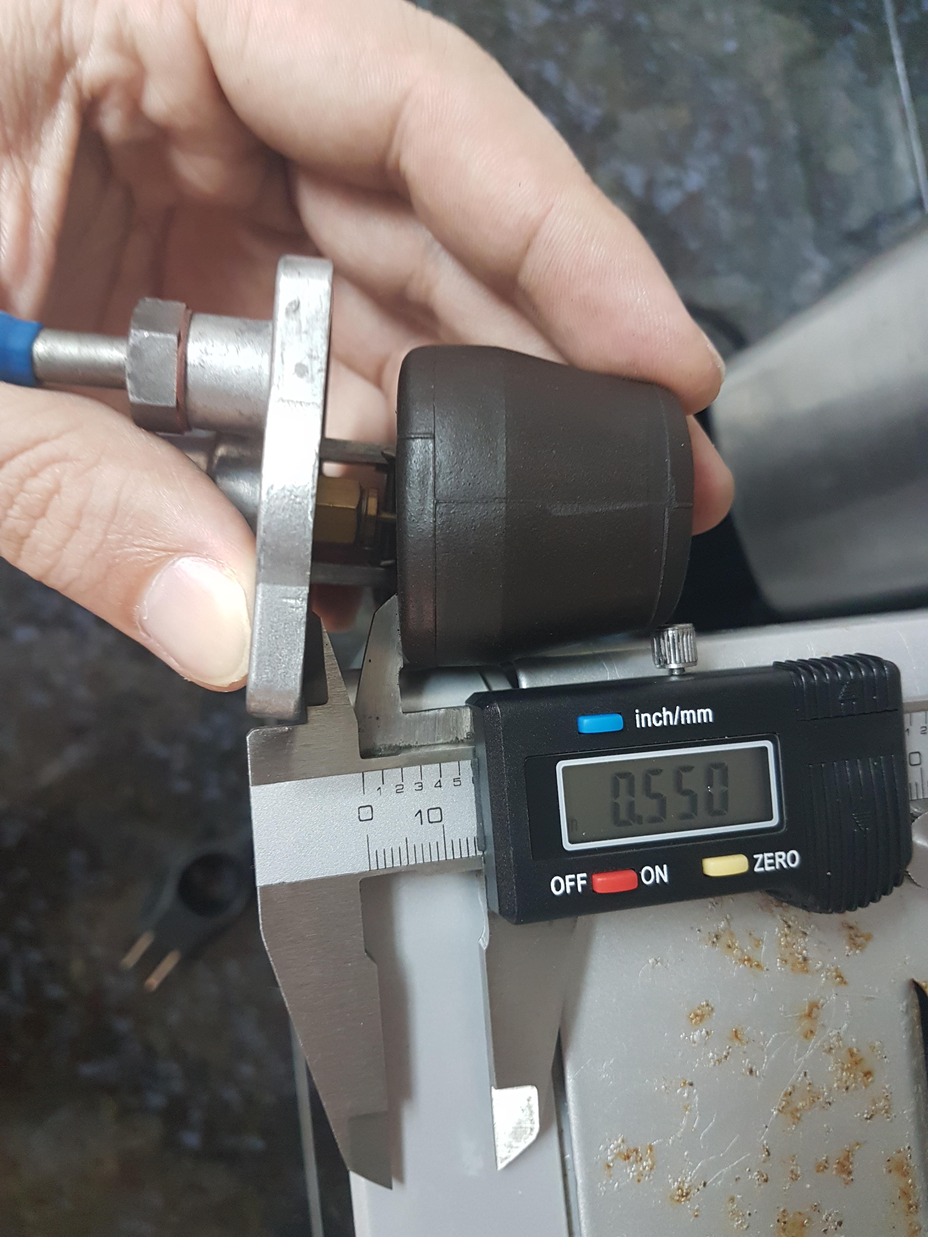

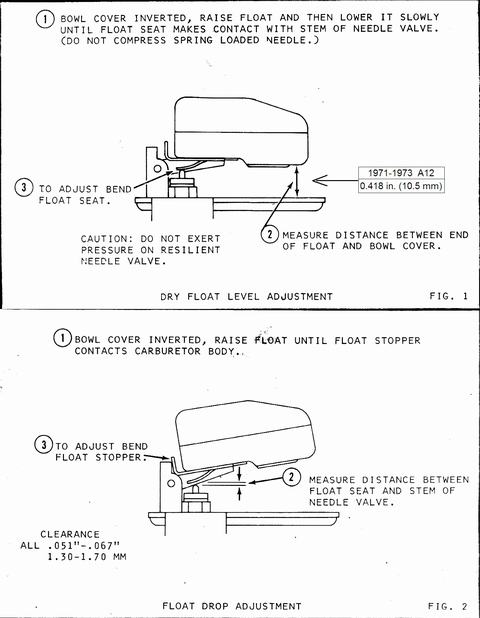

Johnny wick Posted February 17, 2018 Share #98 Posted February 17, 2018 (edited) 6 hours ago, siteunseen said: Turn that assembly upside down and get in front of a mirror. Hold the float with your other hand. Blow into the fuel supply hose barb. When your breathe starts passing through look into the mirror and see where the float is. Bend the tab until the float' roof is parallel with the lid's roof. You will be close. Find something .55" thick and use it between the float and the lid while still using your breathe as fuel to get the float .055" lower than the lid. I can't be any clearer, that's as simple as I can get without puppets. You cannot set the float level upside down with the weight of the float against the pin. The newer style valves are very sensitive and will not resist the float's weight at all, period, done. Edited February 17, 2018 by jalexquijano Link to comment https://www.classiczcars.com/topic/47304-1972-float-adjustment/?page=9#findComment-542530 Share on other sites More sharing options...
Johnny wick Posted February 17, 2018 Share #99 Posted February 17, 2018 Its really hard to set it this way and get the .55 inch gap with the metal bracket attached ton the float barely touching the valve pin. Link to comment https://www.classiczcars.com/topic/47304-1972-float-adjustment/?page=9#findComment-542531 Share on other sites More sharing options...
gundee Posted February 17, 2018 Share #100 Posted February 17, 2018 OK. This is a compromise method that I think works better anyway. Hold assembly hanging as shown. Tip just enough to touch but not depress needle valve. Take measurement. 2 Link to comment https://www.classiczcars.com/topic/47304-1972-float-adjustment/?page=9#findComment-542535 Share on other sites More sharing options...
Johnny wick Posted February 17, 2018 Share #101 Posted February 17, 2018 .60 inches Link to comment https://www.classiczcars.com/topic/47304-1972-float-adjustment/?page=9#findComment-542536 Share on other sites More sharing options...

Johnny wick Posted February 17, 2018 Share #103 Posted February 17, 2018 2 hours ago, Mark Maras said: @jalexquijano Don't obsess about getting them perfect. As you're discovering, measuring floats is not easy. Get them as close as you can without driving yourself crazy. Reassemble the carbs, start it up, shut it down, pull the suction chambers, pistons (not the float chamber tops) and see where the fuel level is in relation to the nozzle tops at 2 1/2 turns. Then you'll know IF the floats need to be readjusted or if you got it right them first time. Rest assured that you're experiencing the same frustration that everyone has had at one time or another setting floats. Keep up the good work. New picture at a differen angle. Should i set both carbs at 2.5 and post pictures of the jets level on both? Can this be useful? I still have not opened the floats lids on the carbs, i woulnt like to damage the gaskets until i get proper training. Link to comment https://www.classiczcars.com/topic/47304-1972-float-adjustment/?page=9#findComment-542569 Share on other sites More sharing options...
