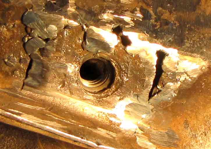

I didn't want to leave this thread making it look like I might be besmirching the fine name of Lincoln Welders so I tried the same welding again after testing on a scrap piece of sheet metal. This time I had the current at maximum, the metal wire wheeled to clean it and more light on the subject. I sped up the wire feed rate a bit too. The arc sustained much better and there was no problem with blowing holes in the metal. The picture below was taken after I partially ground off some of the welds. I left a couple of the holes I didn't fill for drainage since the sheet metal here is at the bottom of the car. The holes were hard to fill due to the awkward welding position on the bottom of the car plus I was having trouble seeing even in the daylight with a work light.
