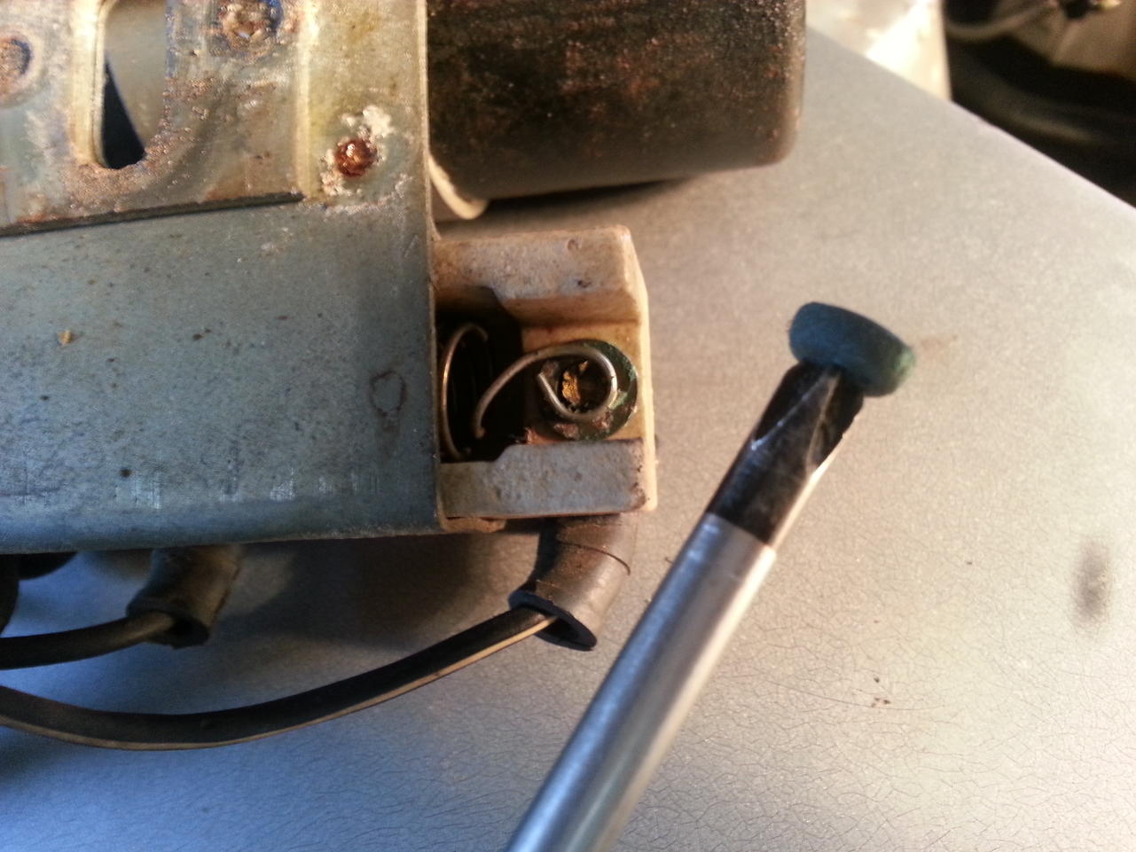

As I was running the car I started checking electrical wires until I ran into a loose connection on the ballast resistor. As I shook the wire the car died out and I got excited thinking this could definitely be an issue. I flipped the resistor over to tighten the connection and with the slightest turn this happened.
So all connections cleaned and tightened on the resistor and still having the same issues. I'm not sure how hot the resistor is supposed to get but I didn't think it would get THAT hot, to the point of burning my finger. Anyways, at least it's nice to fix these little things that can arise in the future.

Well, that ballast resistor has seen better days. I'm running out of ideas to supply you. However, you may want to read through the troubleshooting guides in the FSM to see if we have been overlooking something. I just can't help but think there is something electrical involved since it dies and will run 5 minutes later. It's like something is cooling down after overheating. It would be great to monitor the coil voltage with an oscilloscope to see if anything shows up then.

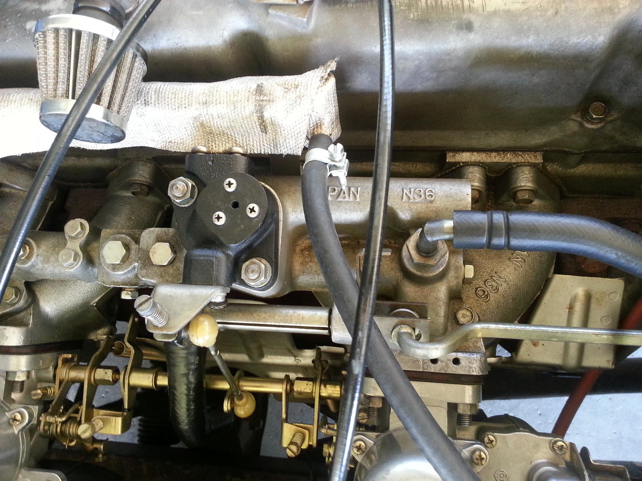

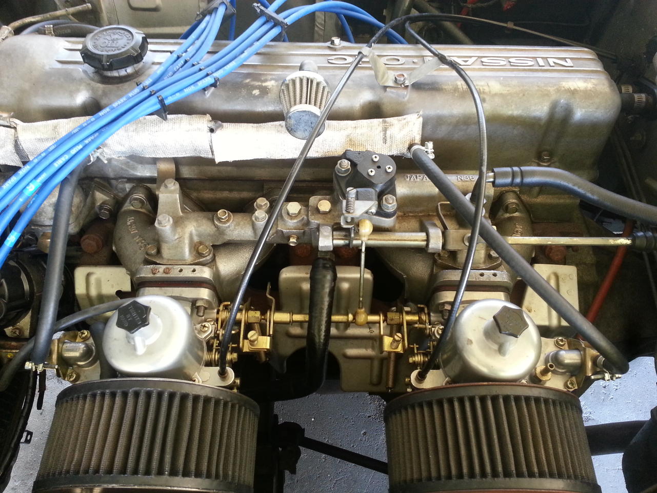

Who swapped out the original flat tops for the current round tops? Did you do that swap, or was it like that when you got it? Also, how much of the original 260 stuff remains now that you're running round tops? Did they swap to 240 intake manifolds and balance tubes too, or are you running the original 260 stuff there?
I'm just trying to get my bearings... Got any engine bay pics?
I believe so.
The previous owner switched to the Ztherapy round tops. Everything else seems to be original. N36 intake manifold and balance tubes. Some emission deletes. The previous owner was amazing with including just about every single part he did remove and include it with the vehicle along with some spare parts.
