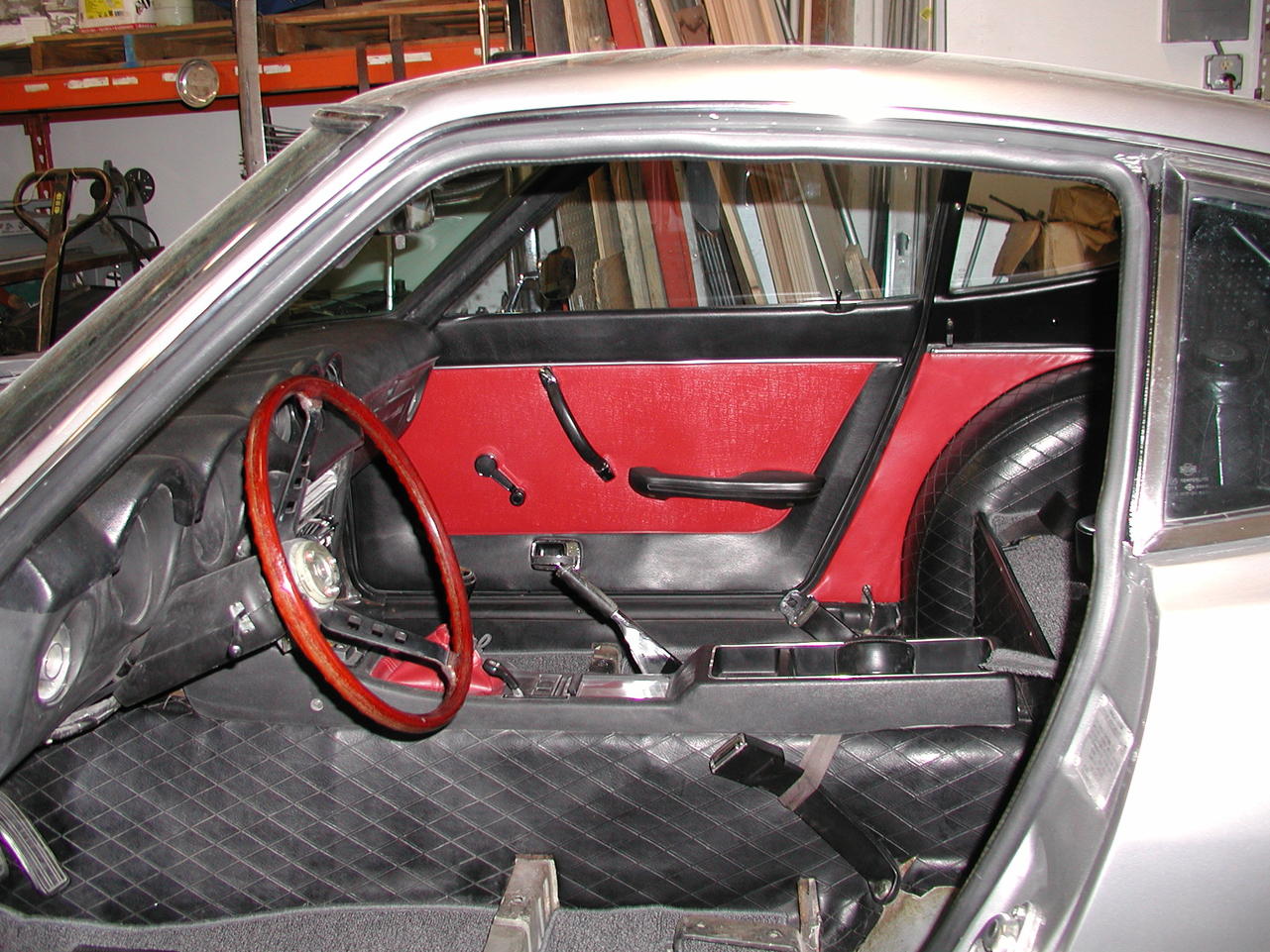

I have a silver car and went with a combination of black (seats/tunnel) grey (carpets) and red for part of the door liners and shift boot. post-20299-14150825828752_thumb.jpg
The stock steering wheel is now gone and replaced with a black Momo.

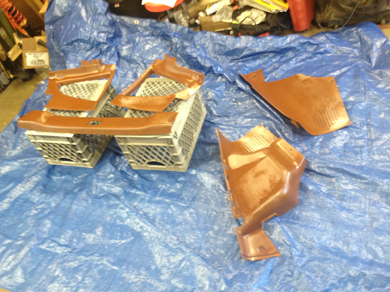

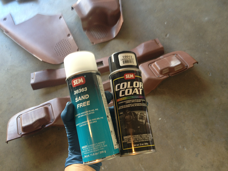

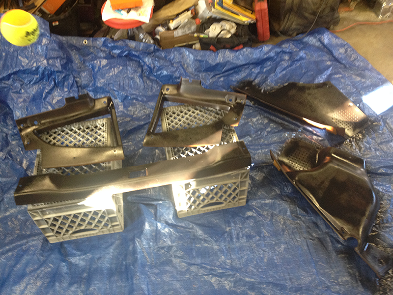

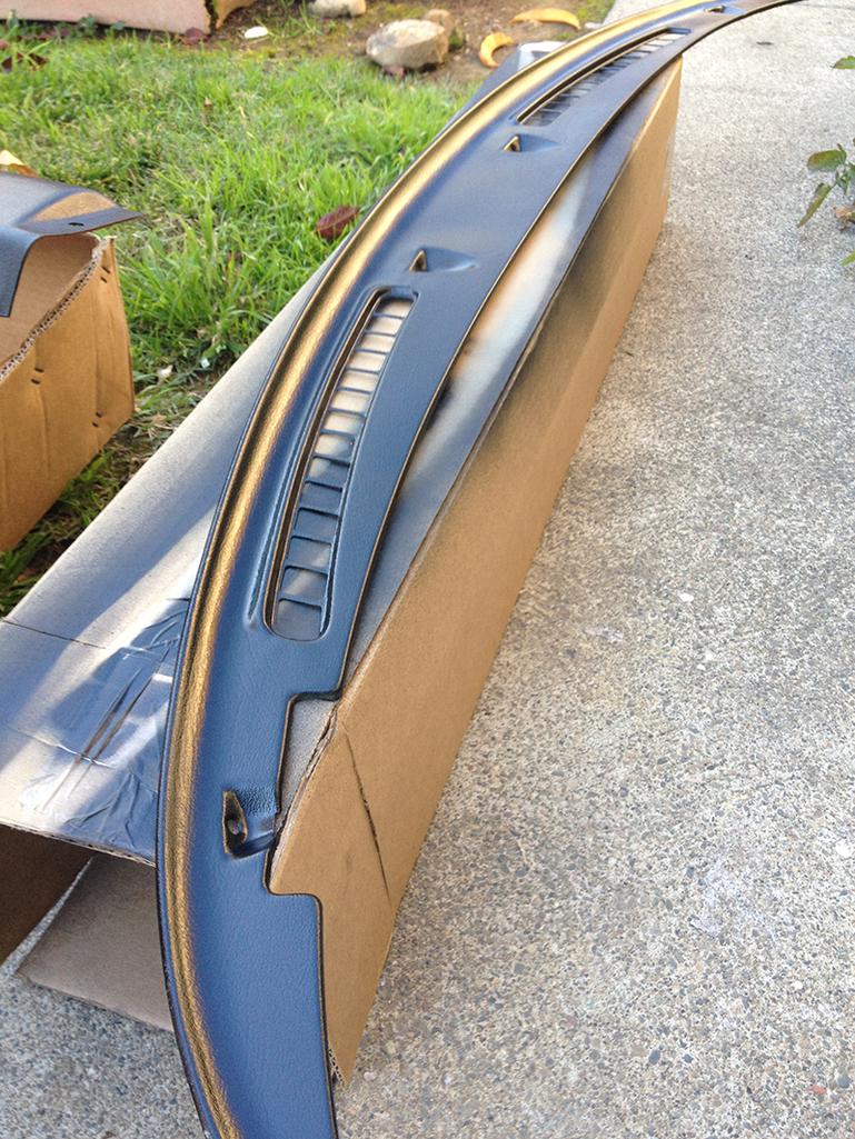

I just paint my interior panel using
  • SEM 38363 Sand Free
  • SEM 15013 Landau Black Color Coat
I learned "How To" from Stacy David's GearZ.

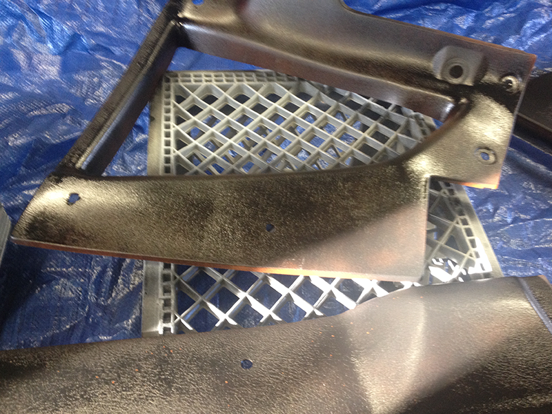

First of all, wash the panel with TSP.
Then apply SEM Sand Free.

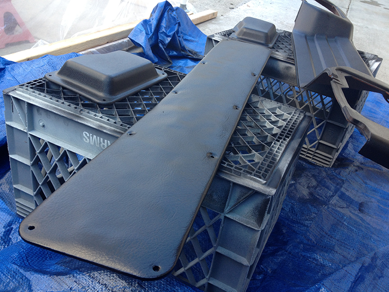

Before, it get dry, spray on Black Color coat lightly.

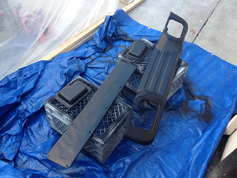

Apply 3 coat, 5minutes a part. 2nd coat.
3rd coat.
3rd coat.
3rd coat.

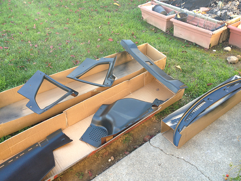

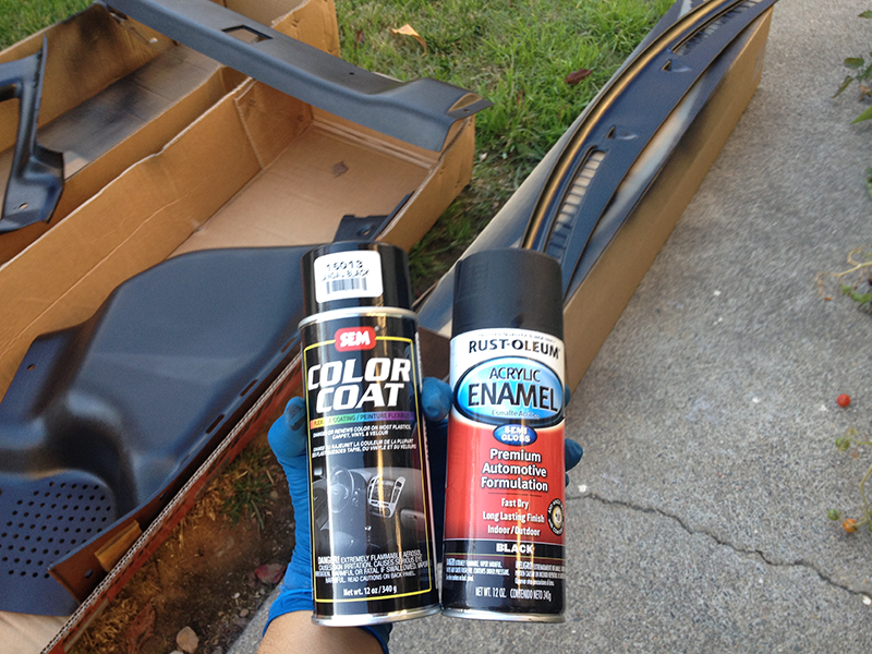

Comparing with cheap Rest-Oleum Semi-Gross Black,
The Landau Black looks great!
SEM Landau Black is best black color for interior.
Just for those panel, I'm running out of one can. I need to buy one more can for door panel and center console. Once I fixed cracked dash, I'm going to paint same color too.
