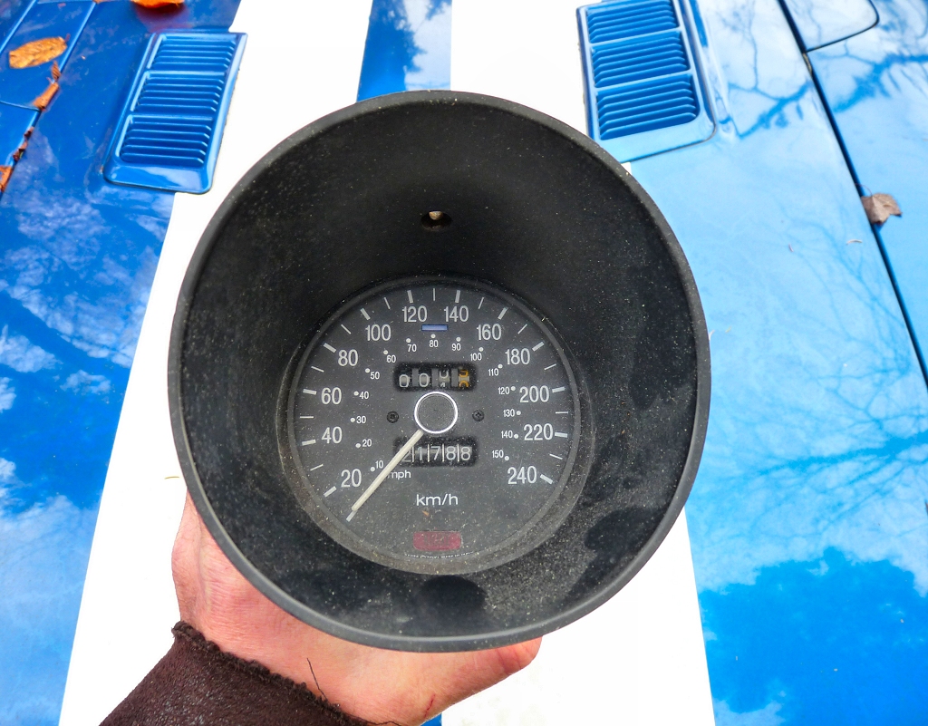

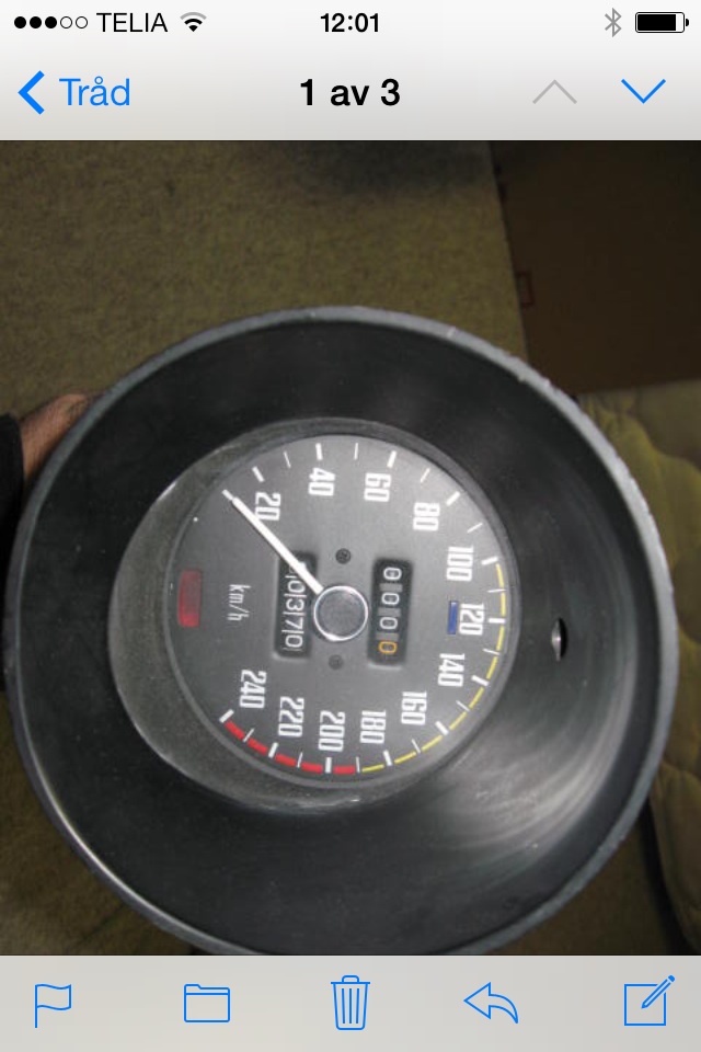

Yes i looked at that one. But i want the one that goes to 240km/h and the red mark starts at 190km/h. Found this one, owner says it from an 280z fairlady from japan. Anyone know if it will fit a 240z -73? Thinking about the electric.
Assume they are the same size? And in worst case i guess could just swap templets.
I think they will fit but the wiring connector is different and the 280Z has the extra wiring for the brake switch warning light. The 240Km faces are really rare these days. Most 240Z's I have seen here come from the states and have the Miles faces. You will need to find a European or maybe Australian Z and those markets were small compared to the US.

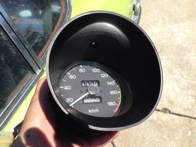

I just dug around (for a TB) and happened to find this one I bought ~ 2004 of Ebay Canada.
No red line to warn so I guess we fear speed less in Canada. :D
