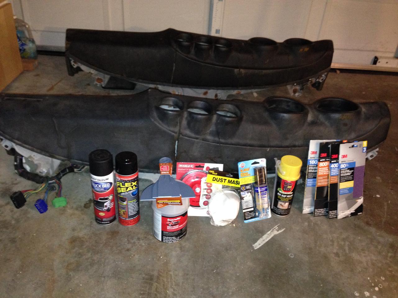

Day 1:
Got everything I need!!!

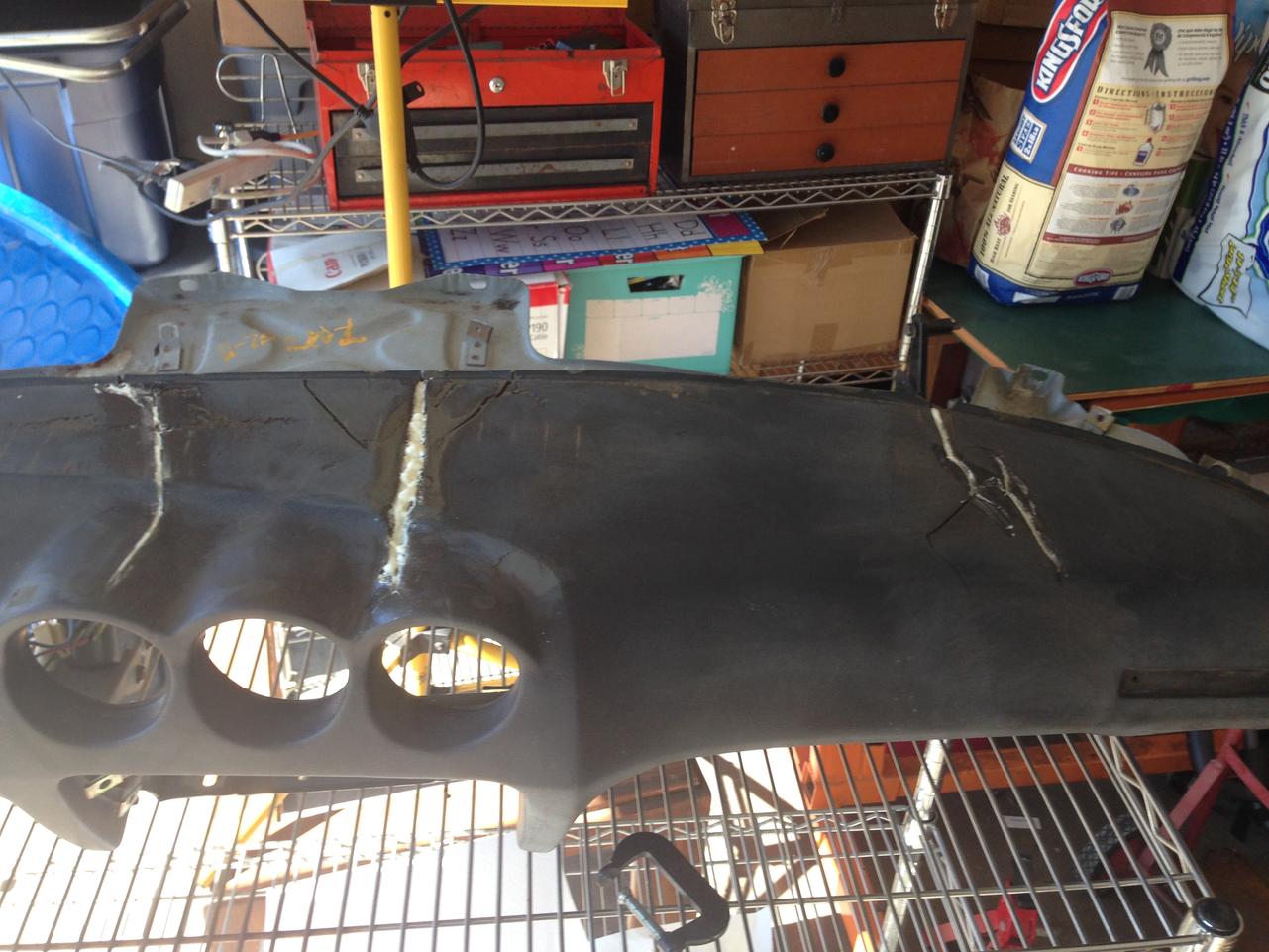

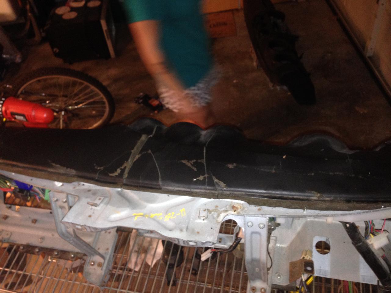

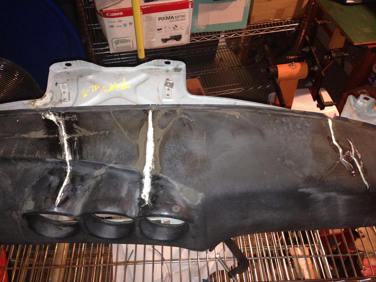

Day 2:

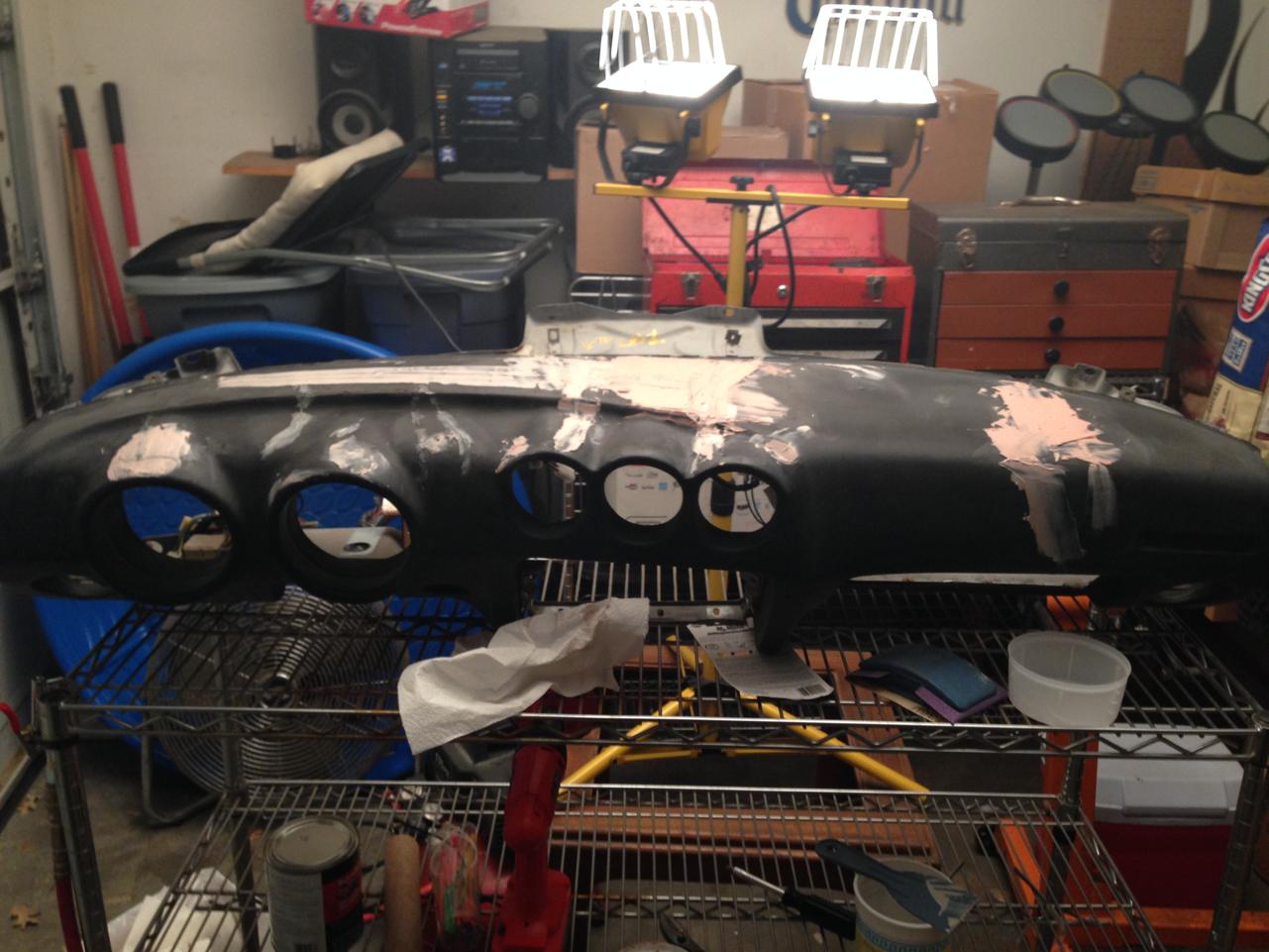

The dash has been sanded down with a drill and 80 grit sanding pad along with hand sanding.

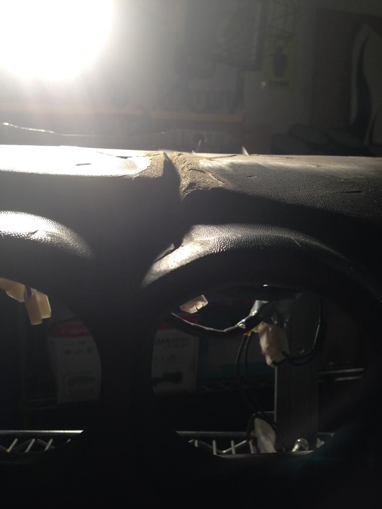

I have also tested the spray foam on a makeshift crack I made out of 2 pieces of cardboard that was glued together to test how far the foam would expand before I put it into the dash.
Turns out the foam could be great. After 12 hours of curing (only 8 required) the foam is still squishy, like the original padding, and is easy to sand down.
This being done, I cleaned up the dash a bit more and have sprayed the foam inside and I will be waiting at least 8 hours for a full cure then sanding the excess down and filling in all the voids left in each crack.

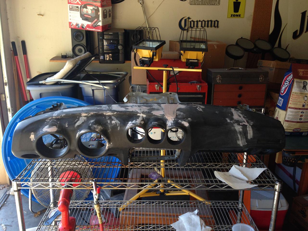

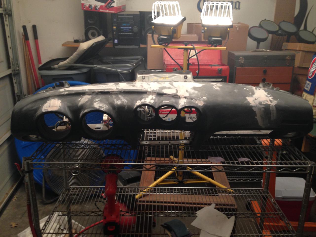

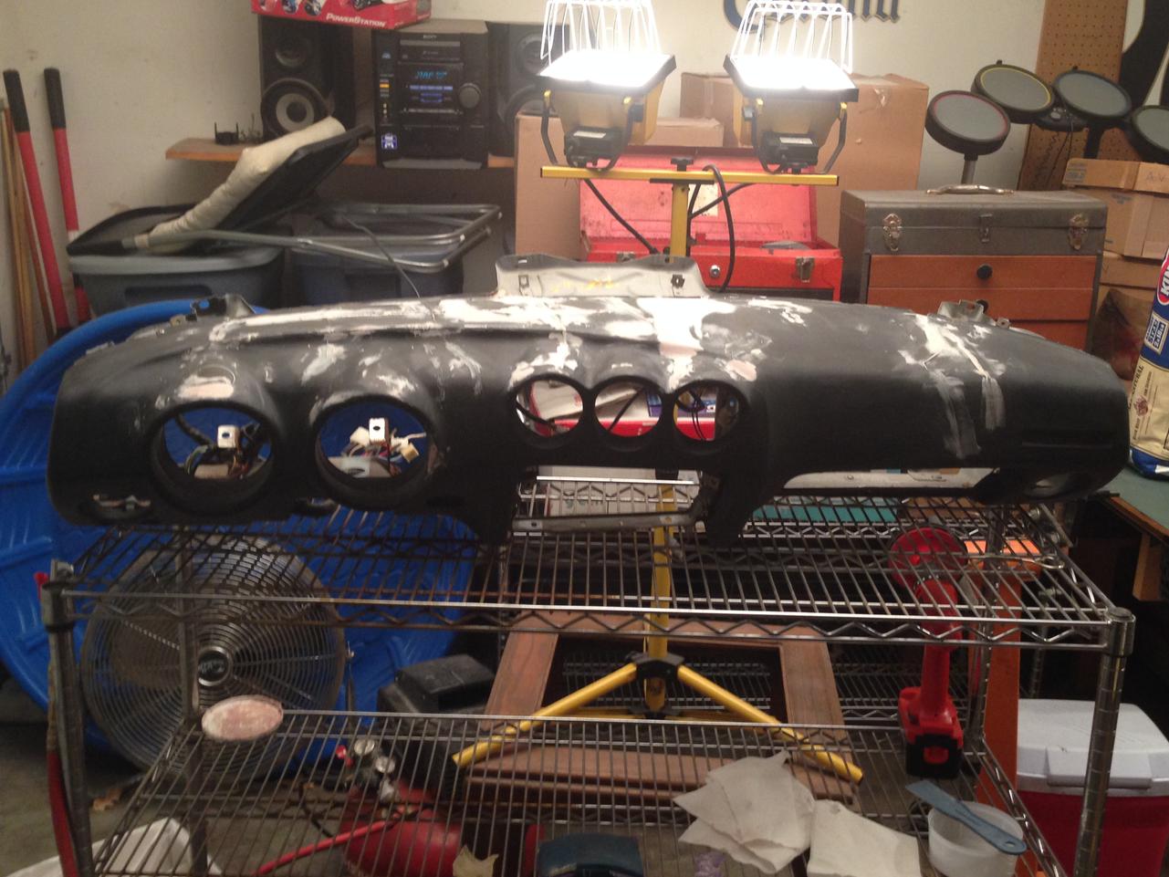

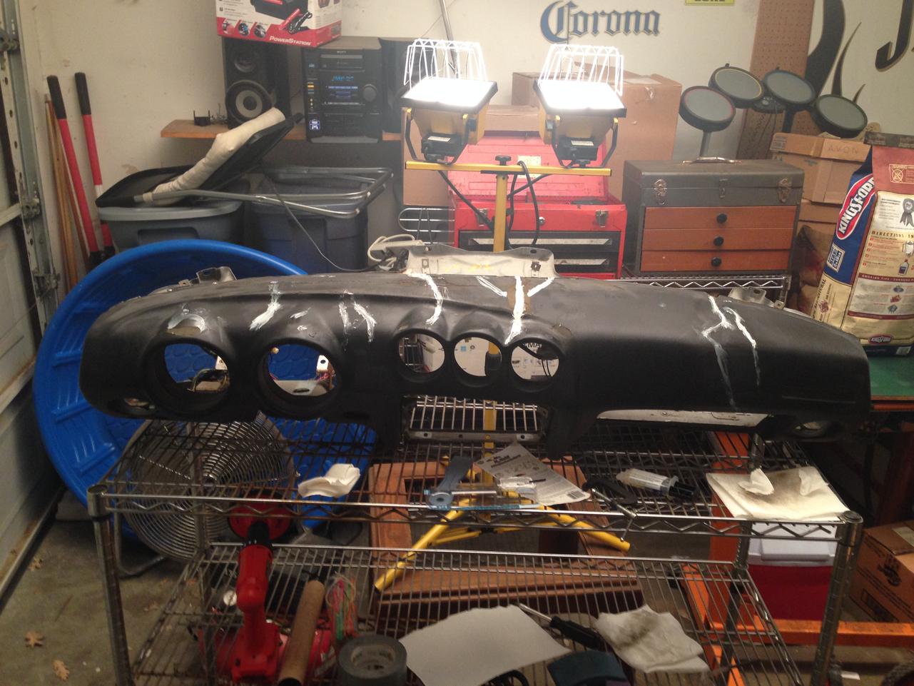

Day 3:

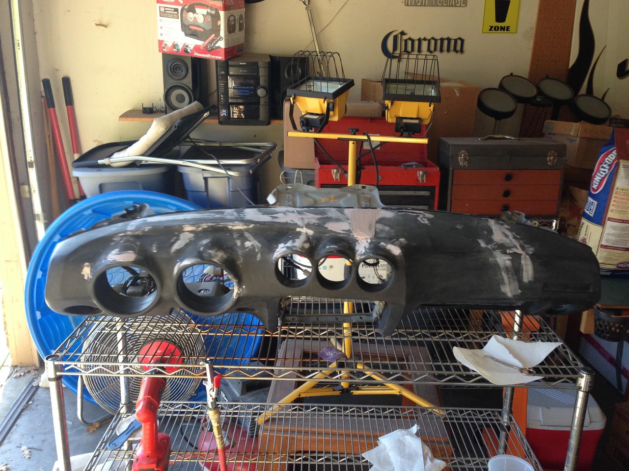

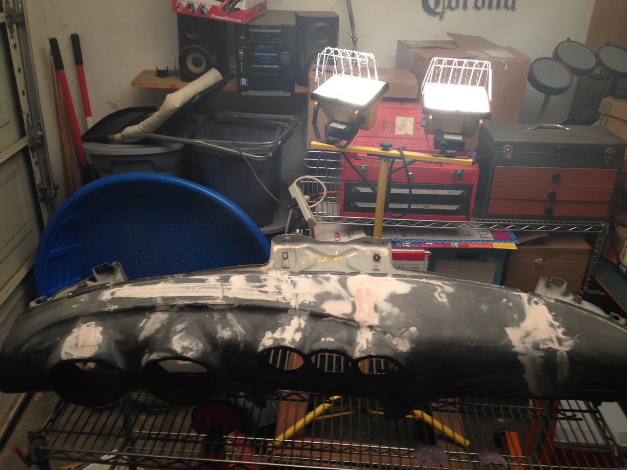

Applied epoxy to the minor cracks and to fill in the missing areas within the spray foam. Sanding down will have to wait for 24 hours and by that time, I will have my new vinyl patches in to cover the parts of the dash were it was missing before I bondo to level out the who dash and repaint it.

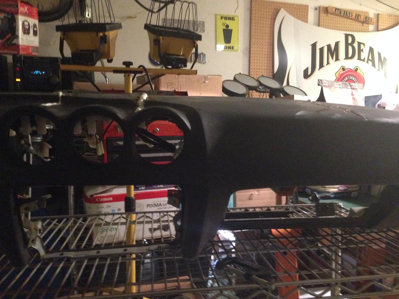

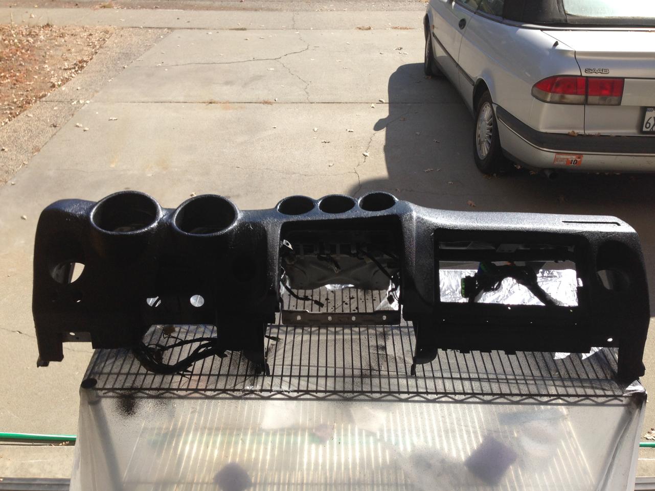

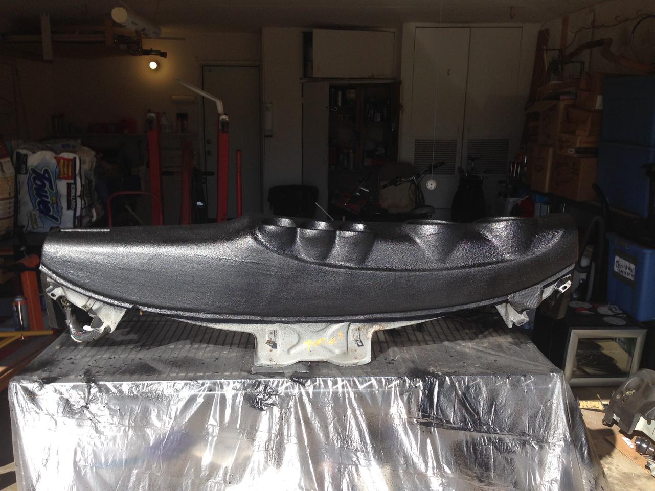

Day 5:

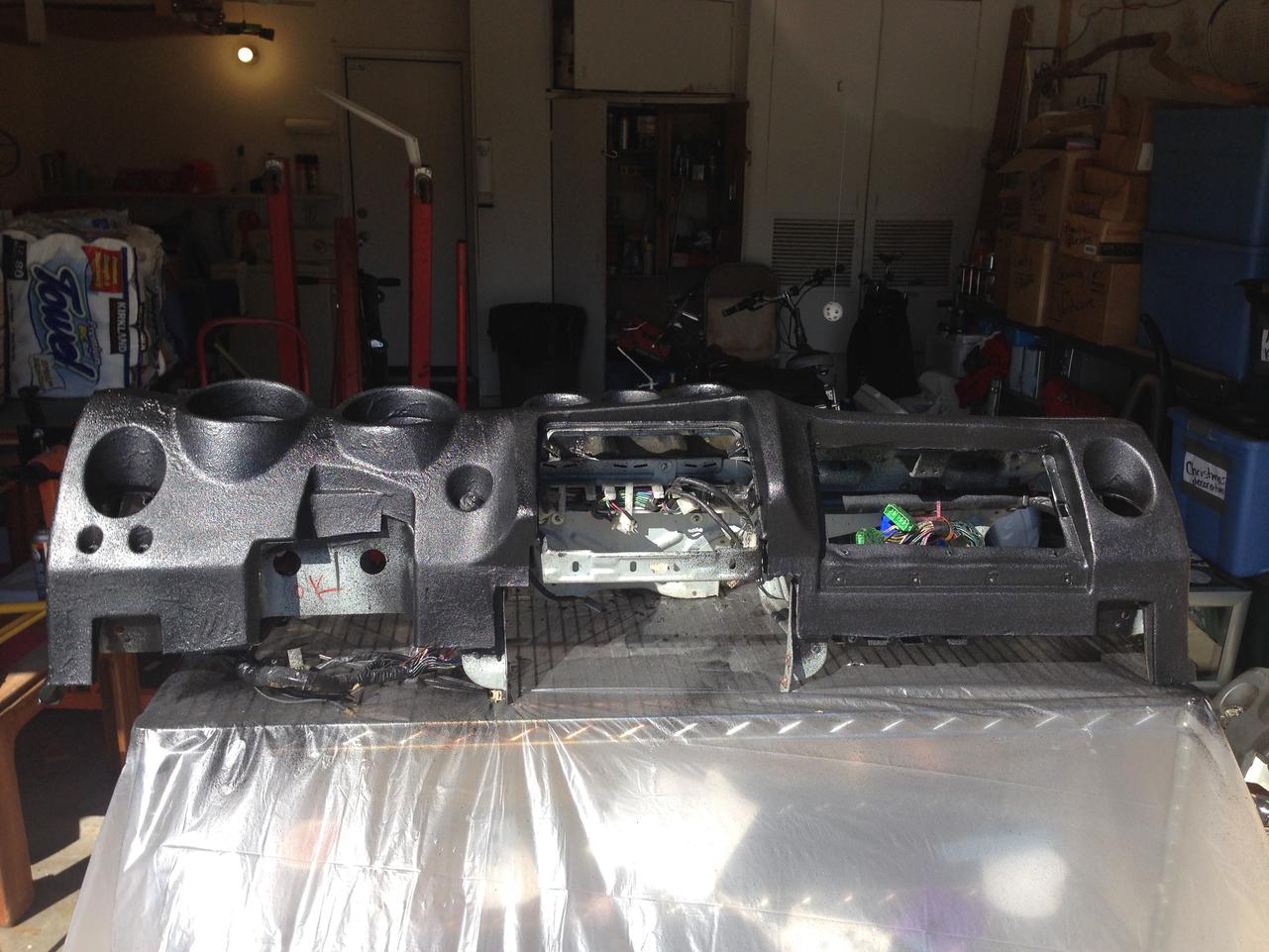

After sanding down the previous coat of Flex Seal (figured out that I needed to practice rattle can spray BEFORE I apply it, LOL) and applying a second coat. I LOVE the results. It doesn't look like a spot on replacement, but the texture is great and it should stand up to the test of time and heat within my Z.
I noticed that the first coat made some of the brittle areas more structurally sound and able to last longer without having to be replaced. I also noticed that the areas that I used Bondo and epoxy, to fill in and cover, took the coats of Flex Seal great and added texture to the dash great without having to add on any replacement patches of vinyl/leather before spraying it.
All in all, I am very happy with the results especially with the cost of the repairs. It was a repair on a very small budget (just to see if I could do it) and combine that with the tons of hours of sanding, it was worth every dollar and hour. I can't wait to do it all over again with some different products and perfect my technique.
Im not a big fan of bondo. I've had it fail many times in the past and thats on hard stable metal surfaces.
Putting it over a foam surface just doesn't seem like it will last a long time. Plus, if you live in a high humidity area how would it hold up with that pourous surface beneath soaking up moisture? I'm more a fan of fiberglass and then bondo over the top. Yea i know its a sob sanding but maybe a compromise would be tiger hair bondo?
I actually got bondo specifically for fiberglass and vinyl material. So I'm hoping (here in sacramento with low humidity) that it will last a LONG time. This was just my trial dash and not the actual one from my Z
