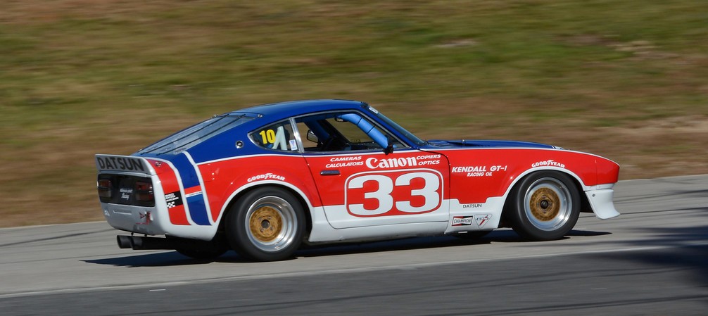

We expect to add a fuel cell so we decided to cut the truck floor out. This is how the Bob Sharp car that we are working on in the Destiny Racing USA shop was done. see image below;
here is a picture of the Bob Sharp - Sam Posey #33 Datsun GTU Race Car;
