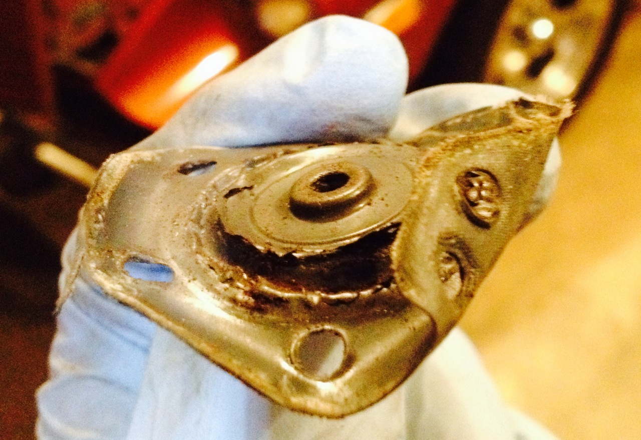

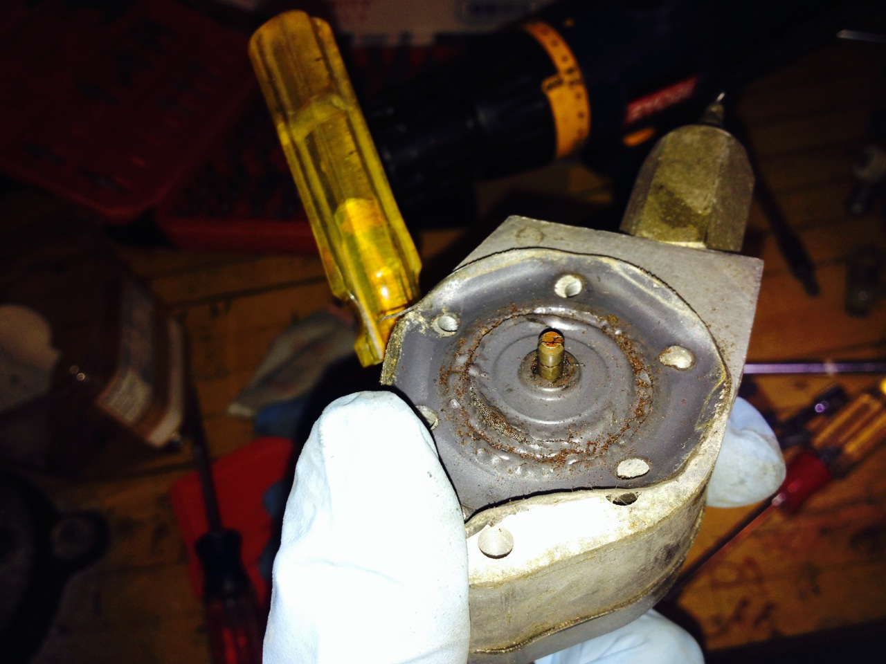

I just did the yogurt cup test and I have a leak. I didn't need any smoke to find it, I could hear it and feel it and it was in an unexpected place: There is a little hole on the side of the BCDD and air is leaking out of that hole. If I cover that hole, the test seems to go as it should - very slow leak down.
For now I am hoping that a little duct tape over that hole will help but it seems that I need to do something about it. Either fix it or eliminate it? Suggestions.
Dan
Haha!! Well THERE'S your problem!
Good luck with the diaphragm. There are several members who have simply removed and blocked off the BCDD completely and don't feel they miss the functionality. I've not tried this as my BCDD still seems to be working as intended, but others have. YMMV.
