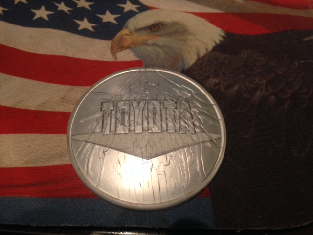

While waiting for my frame to get back from powder coat I am going to try and reproduce the horn button. There are no NOS available and I have a good part to make a mold with.;) I have ordered the mold and casting material and will need to make a vacuum chamber.:ermm:I will post more as the project moves along.
This is my starting point; my existing part is in good condition with the exception of the crazing of the plastic.

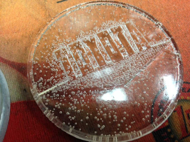

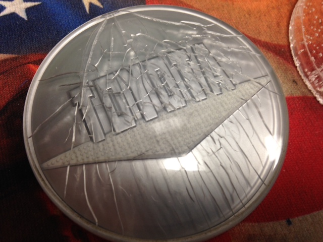

I have cast the first test part. The mold is great and the part is great with all of the fine detail.:love: I will have to buff the reproductions out or buff one out and make a new mold due to some slight transfer of the crazing. The next step is to build a vacuum chamber that creates a minimum of 29" of vacuum.This will make the part crystal clear with no air bubbles.:ermm:
This is the original and then the test cast.
