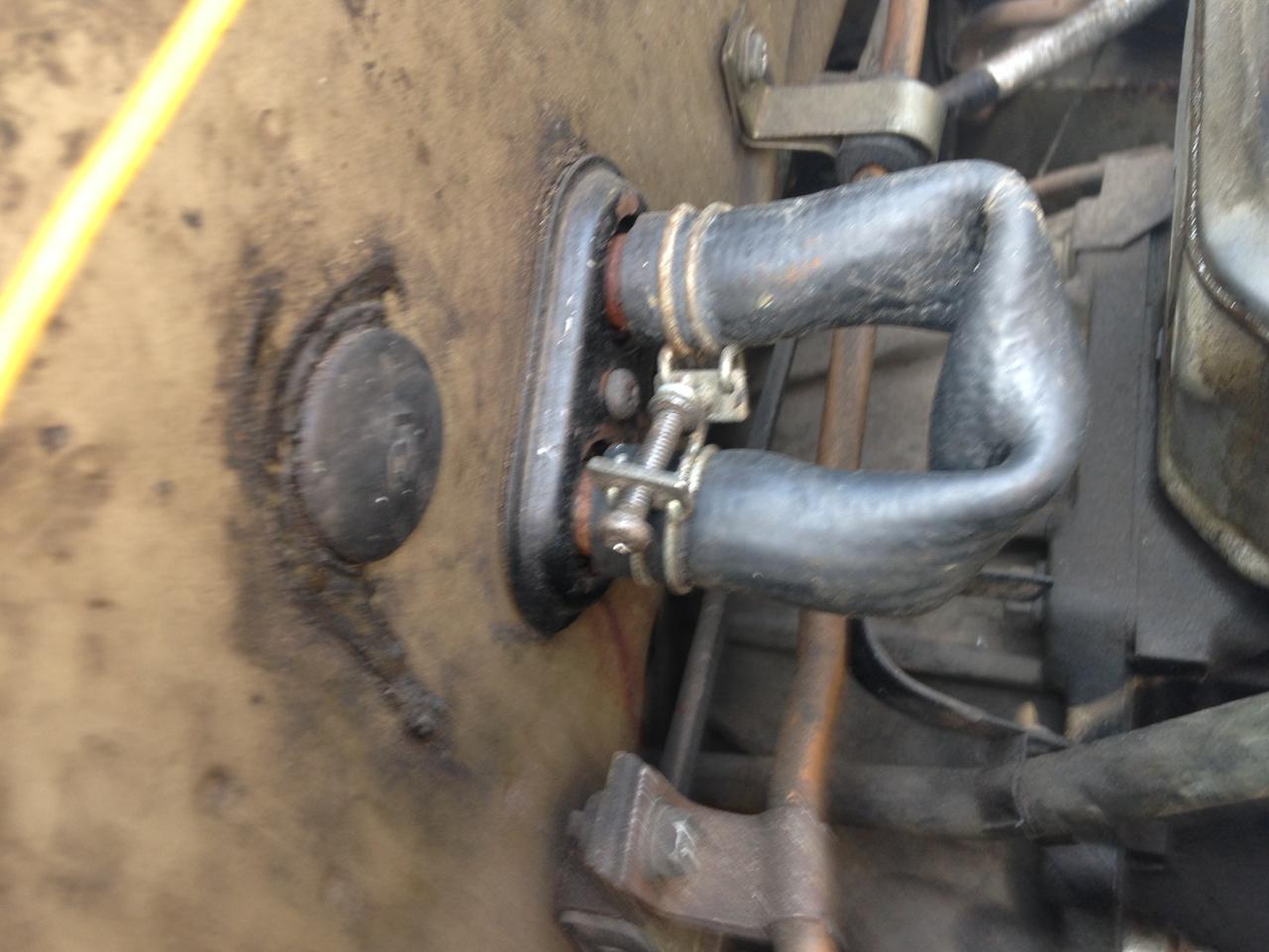

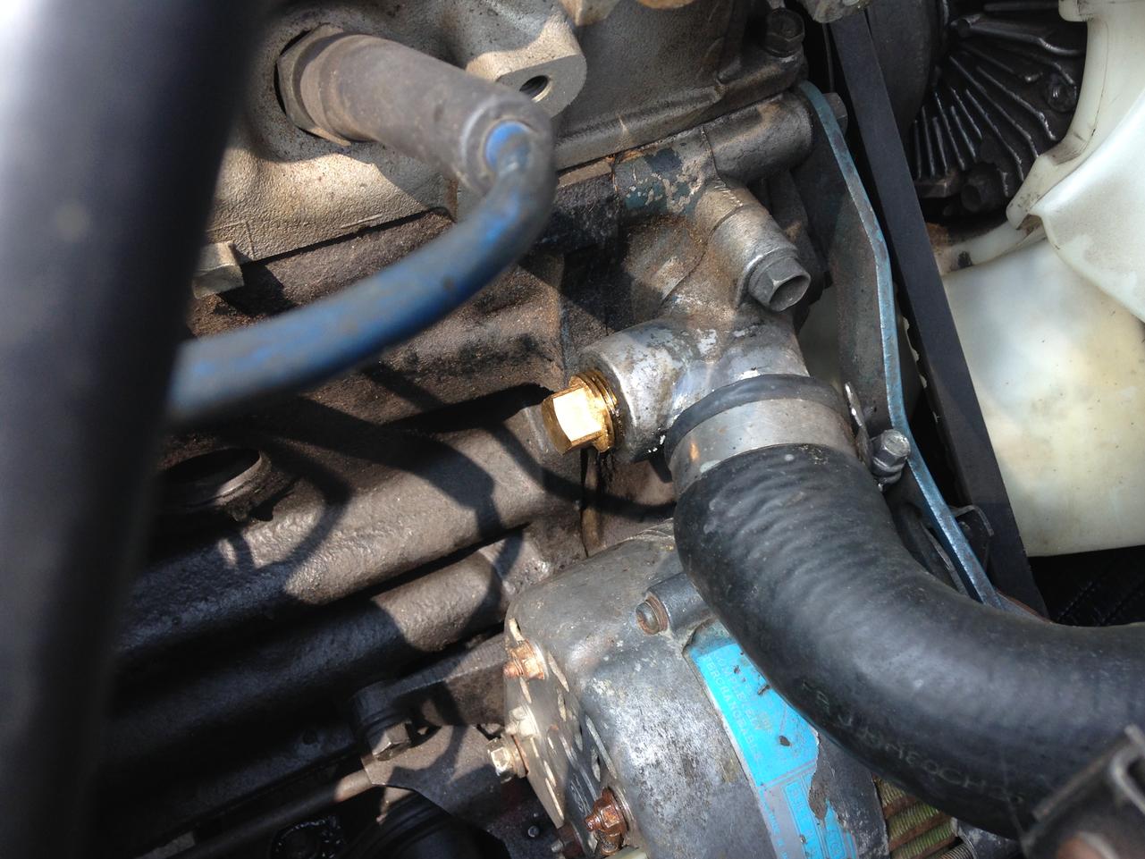

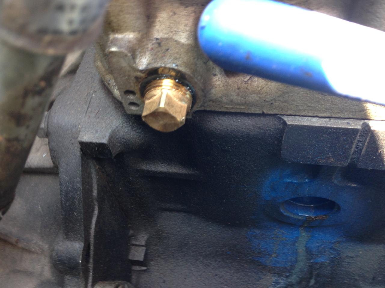

Anyways, fortunately i live in a place that is warm enough to not need a heater so i just bypassed the heater core altogether. I was reading a few threads in the past about looping to bypass the heater
and how bad it was for the coolant temps in the cylinders in the back of the head. So i plugged everything off.

I had this exact problem happen to me Sun. morning at a show I don't think I did it correctly. I cut the hose going into the firewall and connected it to the rear of the cylinder head. now that I look at what you did. I think I'm going to plug the holes like you did. on my way home it stayed pretty hot. I hope I didn't do any damage
I'm going through the same thing. My heater valve is leaking onto the passenger's floor board so I looped the 2 connections with a short piece of hose instead of plugging them. It does run hotter on the gauge but feeling around the engine I don't think it's too hot for any damage. My local Nissan parts guy ordered one yesterday and I hope to get it today. I've found some Gates pre formed heater hoses that I can work into that tight spot next to the tunnel. I won't be shooting fire crackers this weekend, eating and drinking too much for sure though. I'll put some pictures and part numbers up when I'm done.
